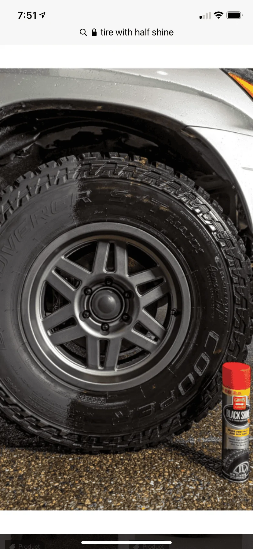

I think this will bring the trim closer to the black painted tops or black Broncos. Zack’s right on the MIC top, the color match is getting closer. The light angle on the same panel causes the appearance of different shades. I chose the painted top because of fading potential and maintenance on the MIC top.

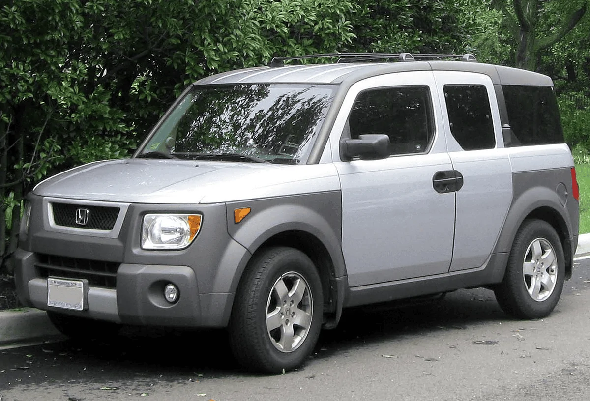

MIC makes me think of the plastic on the honda element. Curious how it will hold up long term (cracking/fading).

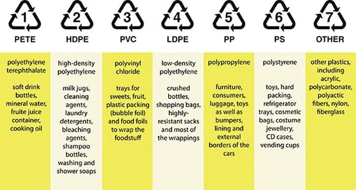

Look for the symbol when you see one 😉

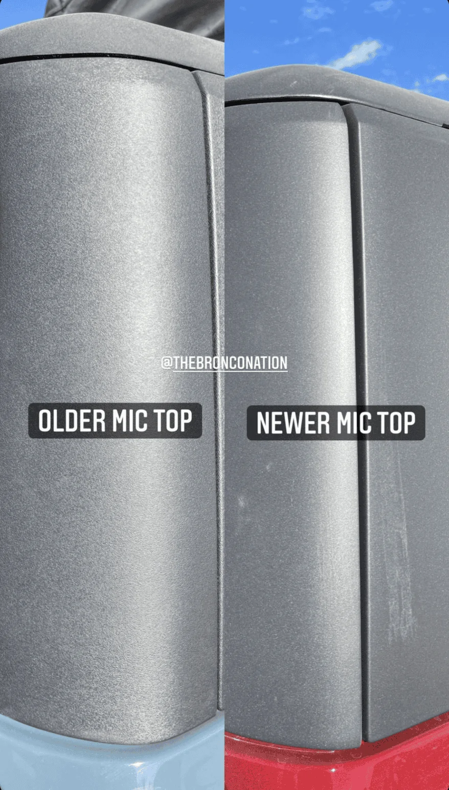

This is really good info.
I think BN hasn’t been helping.

Looks like the same color to me, but my color matching certification test is done under 3500k lights and not photos lol. That’s the tooling change though thanks for finding that.
