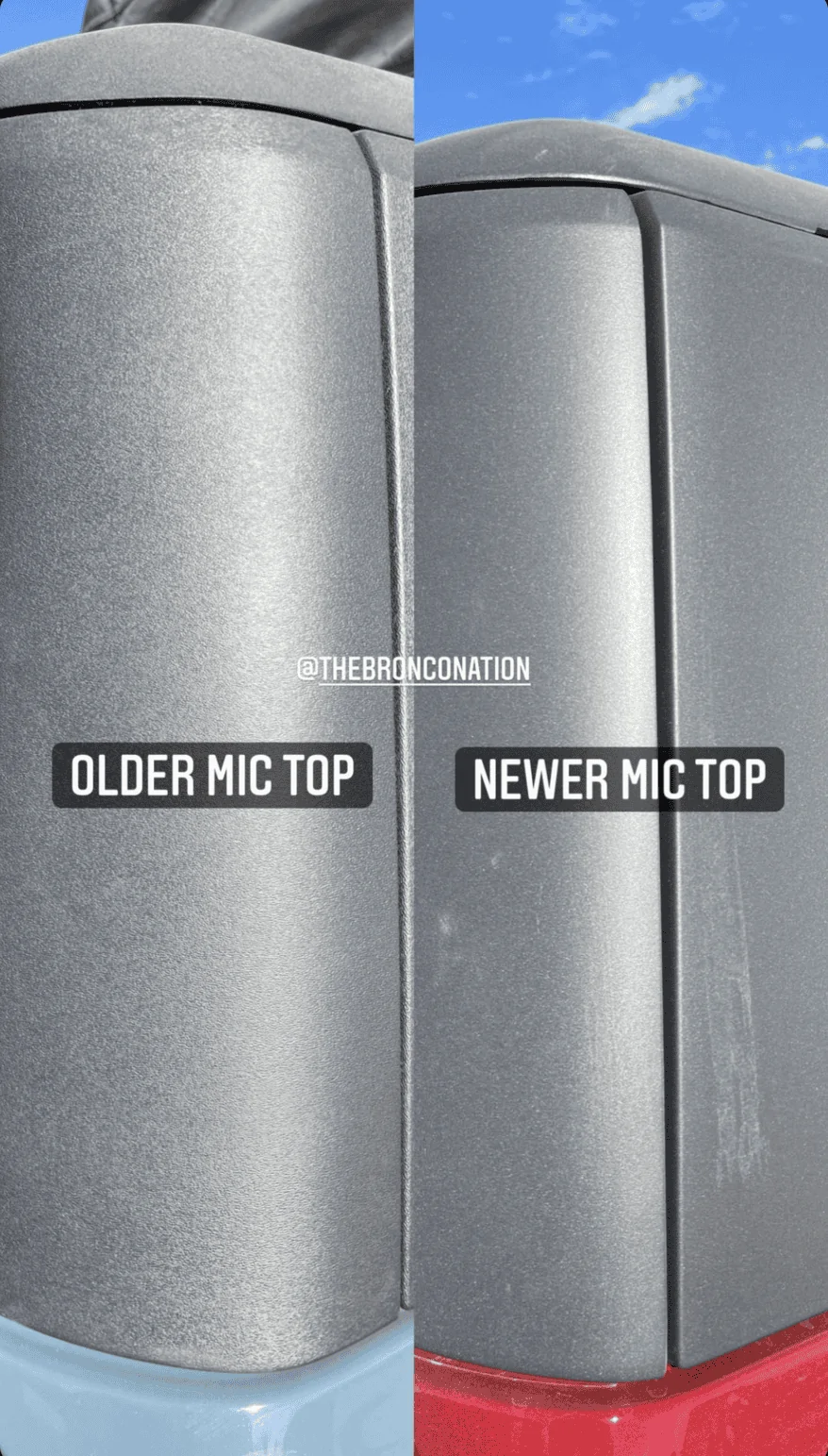

Sure, not that anyone will listen. The top color that Ford calls carbonized gray was finalized two years ago, and the formula has not changed. I think I’ve been here long enough to see that people started to think it got darker once the available photos swapped from factory bright lights to outdoor real world shots. There was also a tooling change around the same time, it’s very obvious to see when you look at old pics and new pics. The seams for the rear shell changed. I think the tooling on the mold changed at that time to a less textured finish. The tooling on the mold can dramatically change the way light reflects, and change the appearance some what. But rest assured the color of the plastic used in the outer shell has not changed.
We do not make the material for the inner structural shell so I’m not exactly sure what it’s made of. The outer shell is polyacetal, or POM in the business, a very common automotive thermoplastic. I have no idea how it will take paint, that’s not my department.

While on the topic of changing the color of MIC tops: Does anyone feel that the new, finer texture will have issues with adhesion with high quality vinyl? I know some have been skeptical, but that grain is so minimal, I can't imagine it being an issue, which leads to vinyl wrapping as a reasonable compromise.
But if anyone here is an authority on the subject, I defer to them. I'd appreciate the input.
Not an authority. I don't know that the texture is an issue as much as the fact that the qualities that make polyacetal / POM such a good material for cars makes any kind of adhesion a bitch.
I've been emailing the Parasol guy tonight and his take is "it might not work, you'll need to test it."
Oh Ok. Guess I'll get right on that with my spare MIC panels.

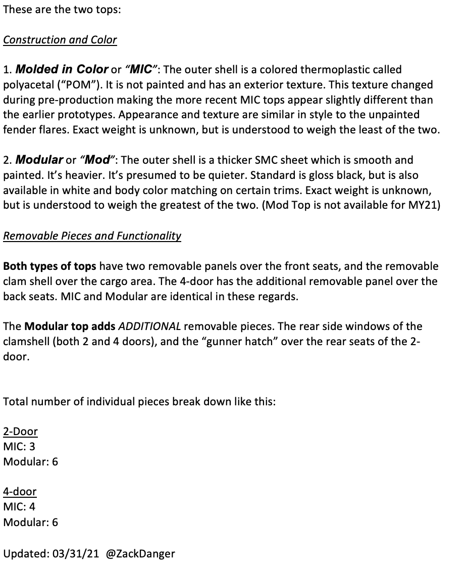

I just wanted to close the loop on this.
I updated my Hard Top Differences explanation to reflect this info.
Frankly, I'm embarrassed to have perpetuated the idea that the pigmentation was actually itself getting darker. I certainly wasn't willfully ignoring anything you said, I just honestly don't remember ever seeing it.
Thank you for sharing it again.
(Note I had to give it yesterdays date because I wanted to be able to reference to this in the future and not have anyone doubt it.)
Ha cool. Lets build the things already so we can move on to having fun and forget the days of worrying about the nonsense!
