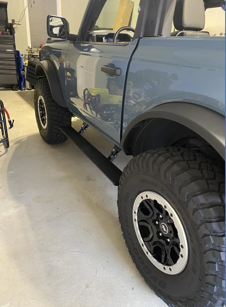

Here’s some 1.2 spacers I put on yesterday to give me a zero offset wheel to run some 37s. This is a Sasquatch with standard flares installed.
Ford Bronco Wheel spacers on badlands Sasquatch IMG_1613
Looks good. Are you running the standard SAS flares or just the standard flares?

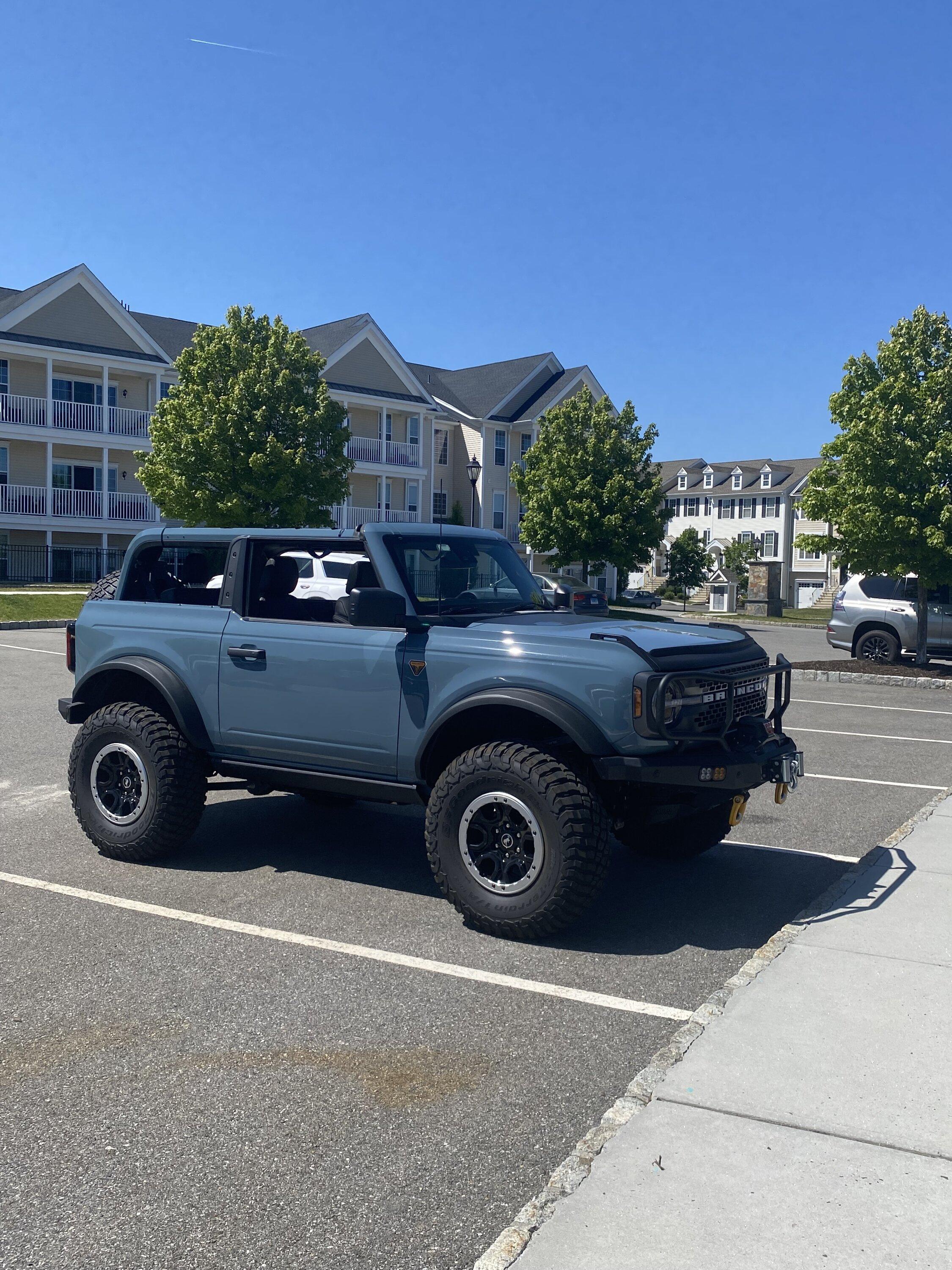

I went with 0.75" Bora Spacers, which gave me the best offset for running 37's and no lift. Just cleared the crash bar mount on the front and the slider in the back. The pockets on the backside of the sasquatch wheels are just deep enough to clear the studs protruding from the spacers. 0.75" is definitely as thin as you can get.
Now that I am on Eibach coilovers, I will either go with 1.25" or 1.5" spacers or 0 offset wheels once I get new sliders installed that have better clearance.
Photo from before I installed the lift with 37s:
