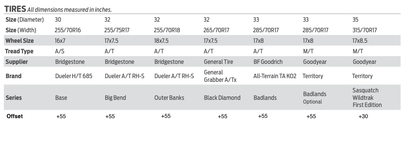

There are tons of threads and pictures on this, did you try to search?
Ford Bronco Wheels for Sasquatch Tires Bronco Wheel Specs Table-1
Very helpful, thanks for providing! Looks like 0 offset would be way to go if I want tires to be just a tab outside Sas flares

Yep 0 will need that if you ever do UCA replacement/ upgrade

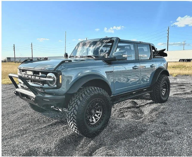

I am going with -12 offset as well. This picture is not mine but someone I follow on IG. This is -24 offset I believe but I think it looks pretty good.
