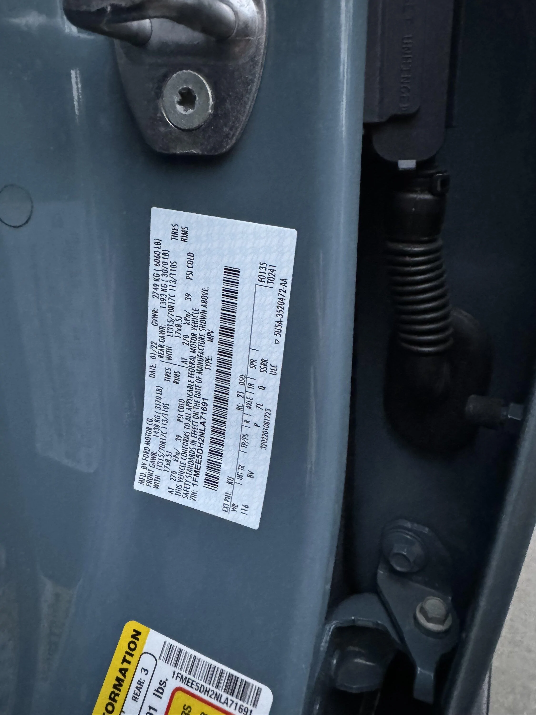

Ya the vin on the door frame is the sticker with the Manufacturer and weights
Thats easily faked. There has to be some stamped elsewhere. Have you looked under the hood area at all? May be worth running a VIN check on the one inside the door. The windshield area VIN plate is very difficult to fake. Yours doesn't exist. I think you need to start worrying that you got scammed... Whats the title say?

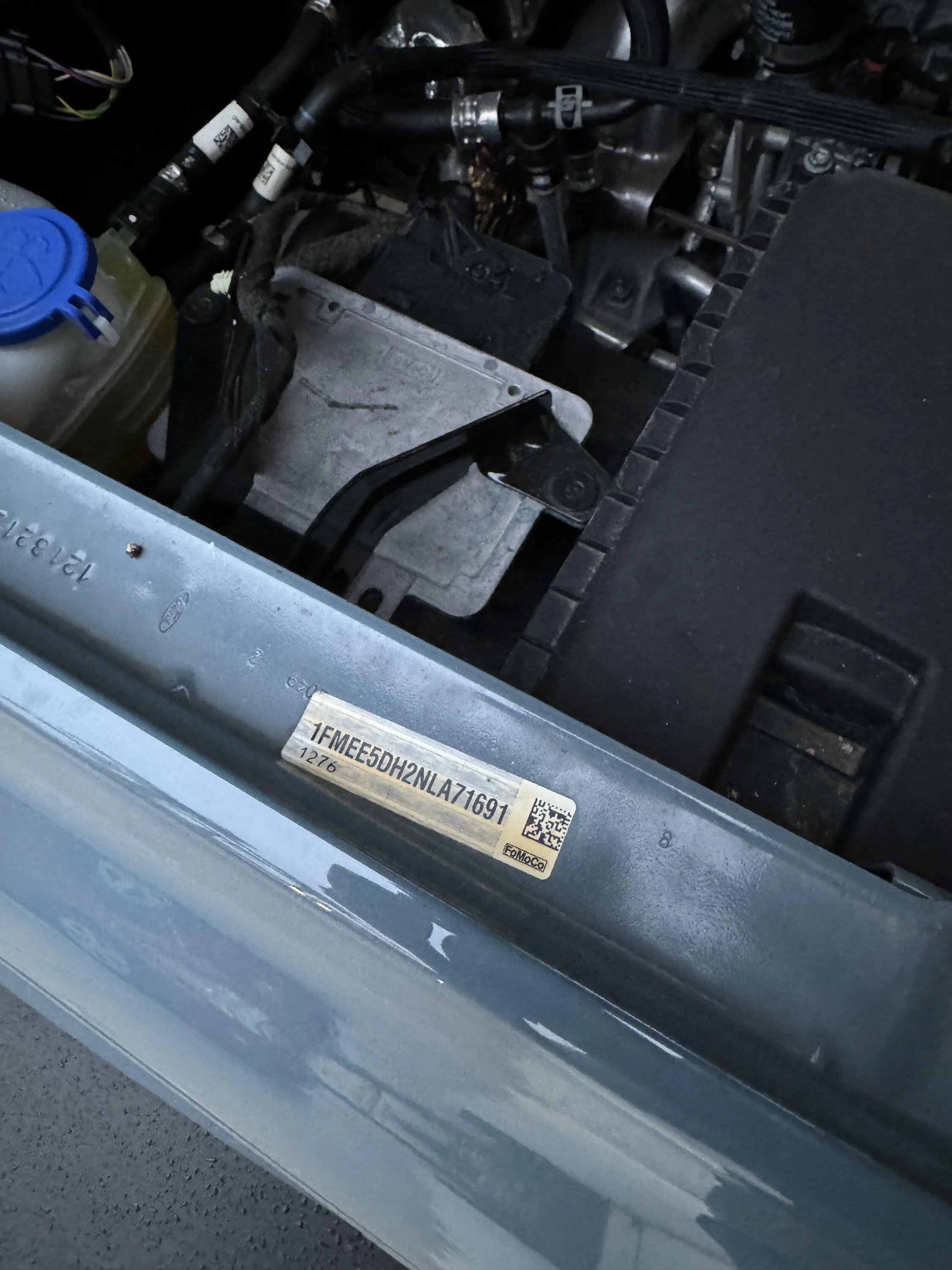

I just checked mine and saw three VIN tags under the hood. In addition to the window VIN, they all have QR codes on the tags next to the VIN. Hope this helps.

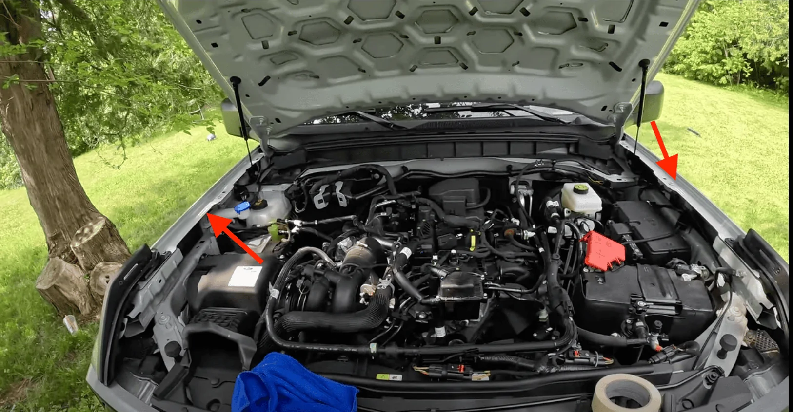

As @flip said, there are VINs everywhere.
Easiest one that came to mind: If you pop open the hood, there should be a VIN sticker along both side fenders.
If you are missing VIN stickers in those spots too... then... you may want to contain your excitement.
Looks like all the other stickers are present.
Ford Bronco Where the hell is my VIN?! Missing Windshield VIN IMG_3502
Ford Bronco Where the hell is my VIN?! Missing Windshield VIN IMG_3503
Your best bet would to be to talk to the dealership and or/DMV and see if they can get any history on the VIN and see if Ford can answer for the VIN plate issue

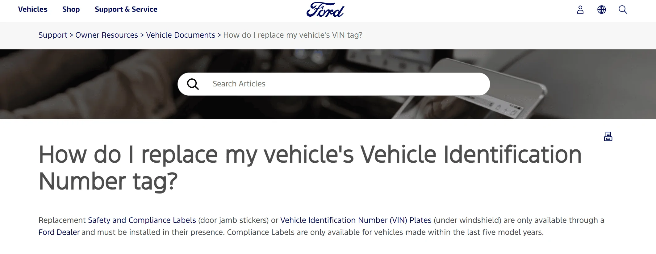

Title was already sent into DMV by autotrader and processed so DMV didn’t catch anything. I have the appropriate vin stickers in all the areas people have told me to look thus far (2 in engine bay, 1 on the underside of the hood, underneath the doors, on the door jam). The etched Engine block number also matches. Definitely wasn’t stolen recently, I can see the same Bronco sitting in the previous owners driveway on google maps over a year ago. He also had a supplemental warranty document that he bought for the car at the time he bought it new at the dealer which all matches. I haven’t got ahold of him tonight (3 hours ahead) to
ask if he was even aware or if the window was replaced at one point. Either way this is super strange. I’m not sure of next steps. Should I go to CHP first and see if they can verify or to a ford dealer? If it’s as innocent as just missing or destroyed during window replacement, can a new window VIN even be obtained through Ford? Bummer it Kinda took the joy of a new car away here.
