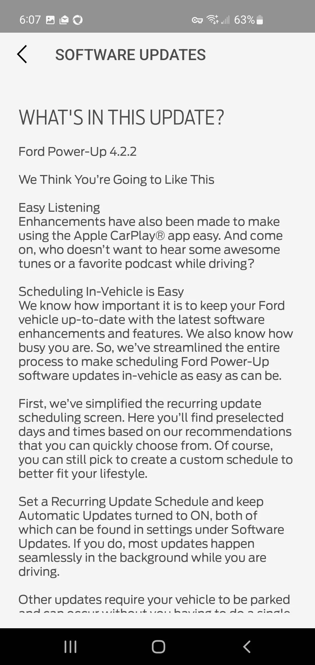

Not sure... It's kind of weird. I click on recent changes and this comes up.... Can't tell if this is telling me what the current outstanding update is supposed to be, or just the same info that was displayed originally for my already completed "recent update"
I like the part where it says “we think you’re going to like this”. Good one Ford!

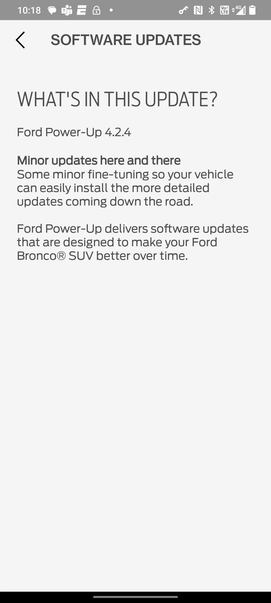

I have this one 4.2.4 and got an alert before turning it off this morning that it's schedule to update tomorrow at 3am.
Ford Bronco Which SYNC4 software version do I have? Screenshot_2023-10-11-10-18-06-02_f85a9dcae275ee1e0920d804e6924647

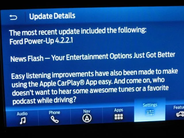

Our '23 BD has 4.2.2.1 in the Settings --> "Update Details"
But our SYNC Version is same as yours - SYNC Version 4.0.23096
So I'd guess this means your Bronco is also running 4.2.2.1
