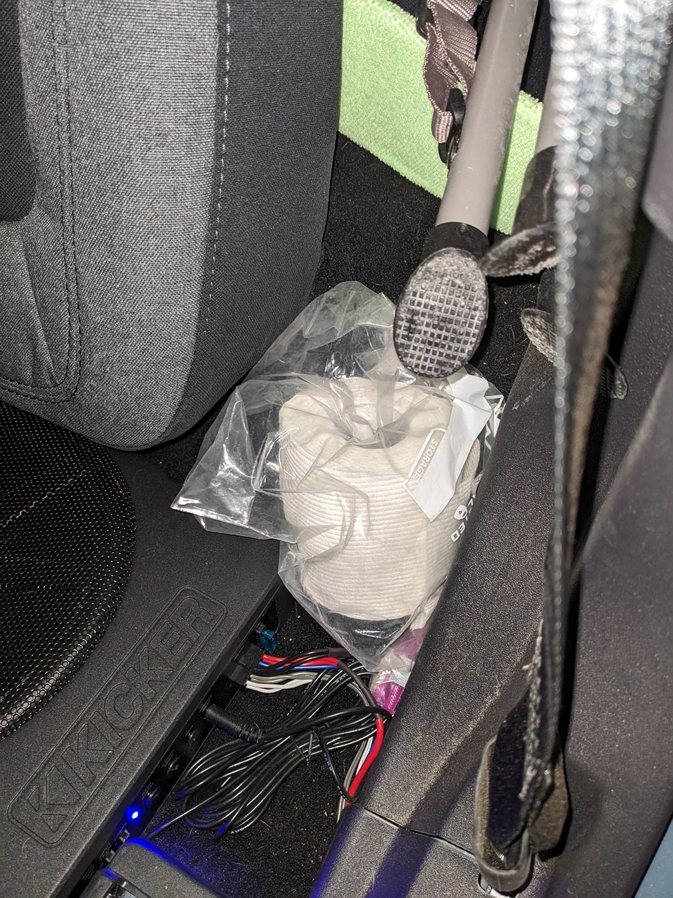

While off-roading, or on-roading, the most important emergency tool for a worst case scenario is toilet paper!
You just never know!
(Ignore the crappy wiring job)
