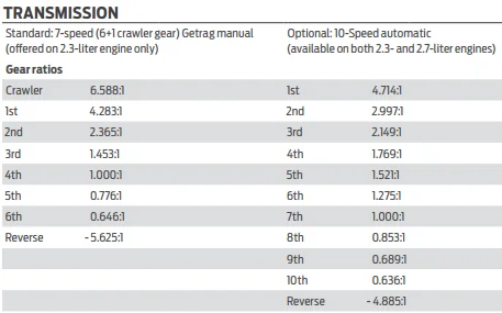

Why will the manual be rated for less?
The 10 speed auto has more available ratios (10) versus the 7 speed (7 but really 6 in normal driving) and a higher ratio spread (lowest gear ratio divided by the highest ratio). The ratio spread for the 10 speed auto is 7.411 and the 7 speed is 6.630 (1st-6th, crawler was excluded because its not used in normal driving).

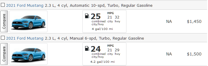

For an example of this, look at the Mustang. The auto is rated slightly higher than the manual:
I suspect the fuel economy delta between the manual and auto Broncos will be larger due to more weight and more rotating mass (larger tires).
But its all a guess until the official fuel economy numbers are published...
