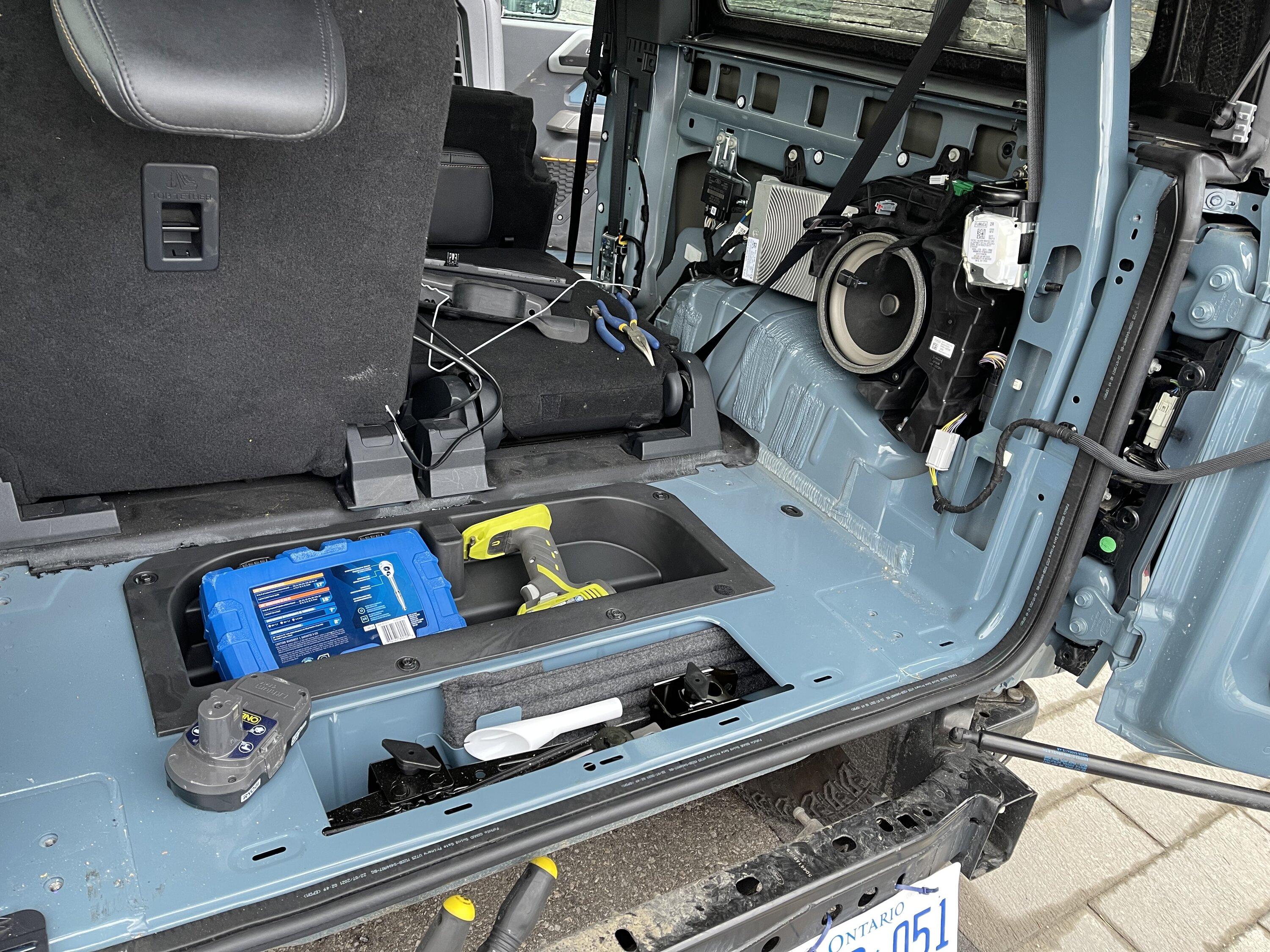

K. Using rear aux wire. Getting to it wasnā€™t that big a deal. BUT, trying to fire out a good way to pass the wire from inside the vehicle to the bumper is proving challenging. šŸ¤·ā€ā™‚ļø
