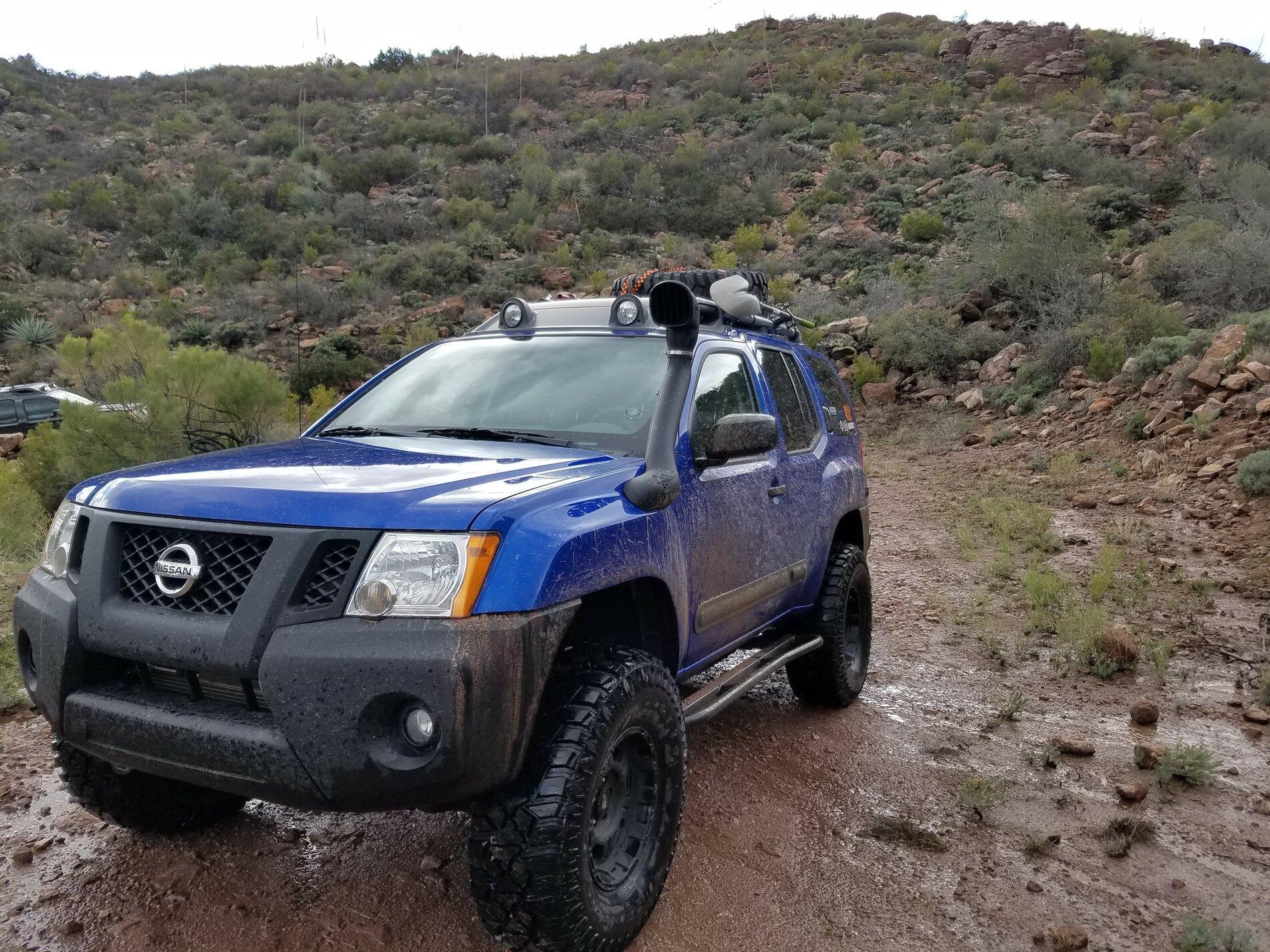

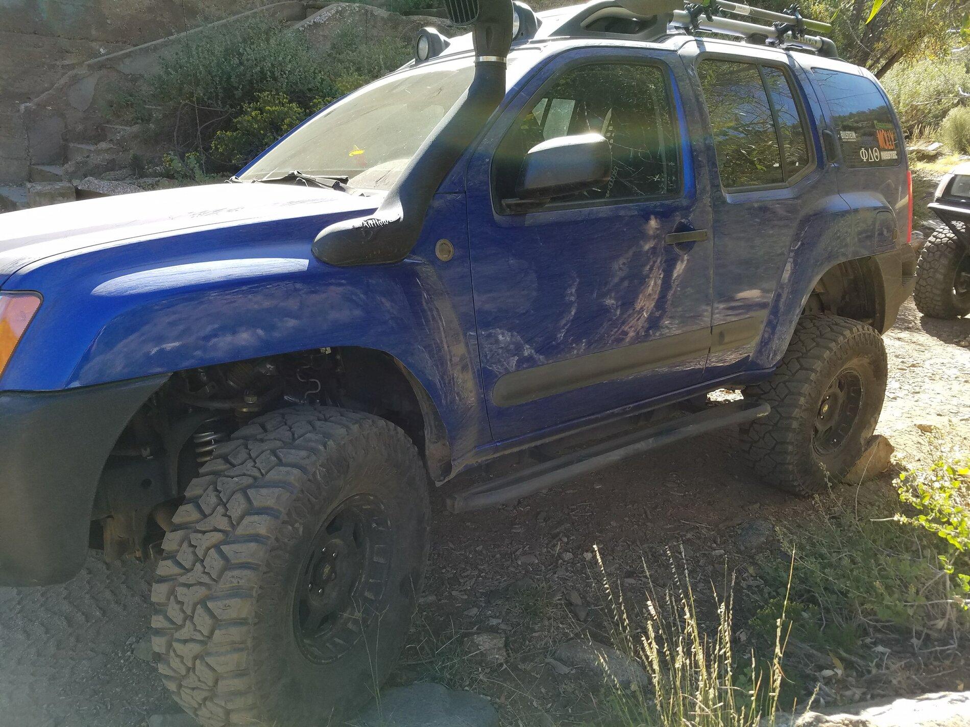

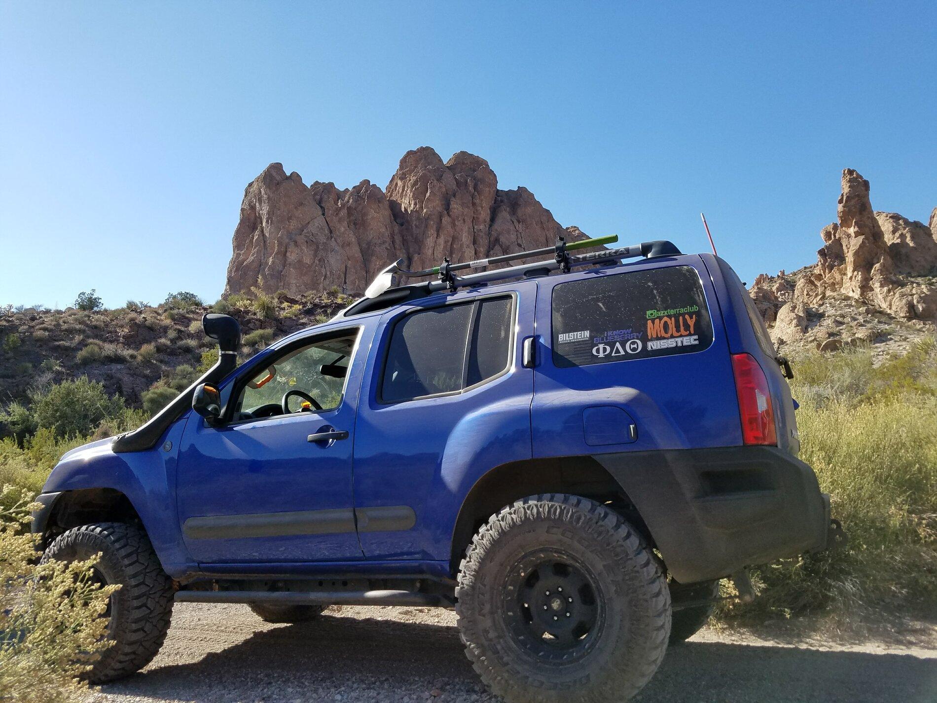

My xterra had a kickout plate, this is before I adjusted for the body lift so they are lower than they needed to be, but you can see the back portion, called a kickout plate is what I enjoyed and protected the doors more than anything else.
These were mounted to the frame, my biggest concern about the bronco rock sliders are they are mounted to the body, this seems like a recipe for disaster, with that being said I have them on my BB build, will bridge until I get different ones.

Nice. Who makes these?

Actually custom made in phoenix, but generally a company called heftyfabworks and shrockworks had very similar options, I just wanted mine made to my specifications at the time.

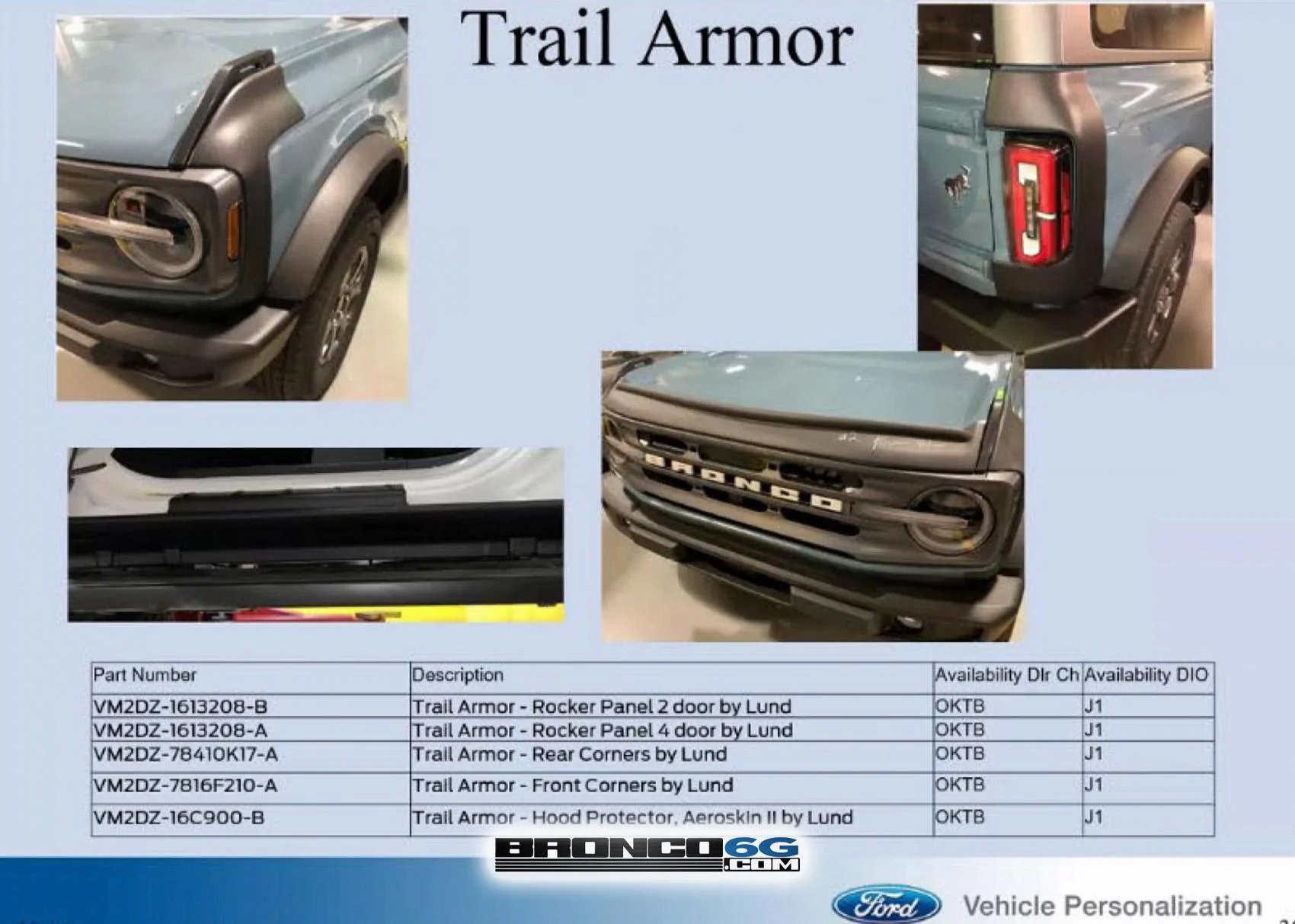

Ford Bronco Your plans for sliders/armor? 2021 Bronco Trail Armor Rocker Panel and Fenders Corners Ford Performance OEM factory accessory
thinking of getting these ..... any thoughts? should i wait for aftermarket?

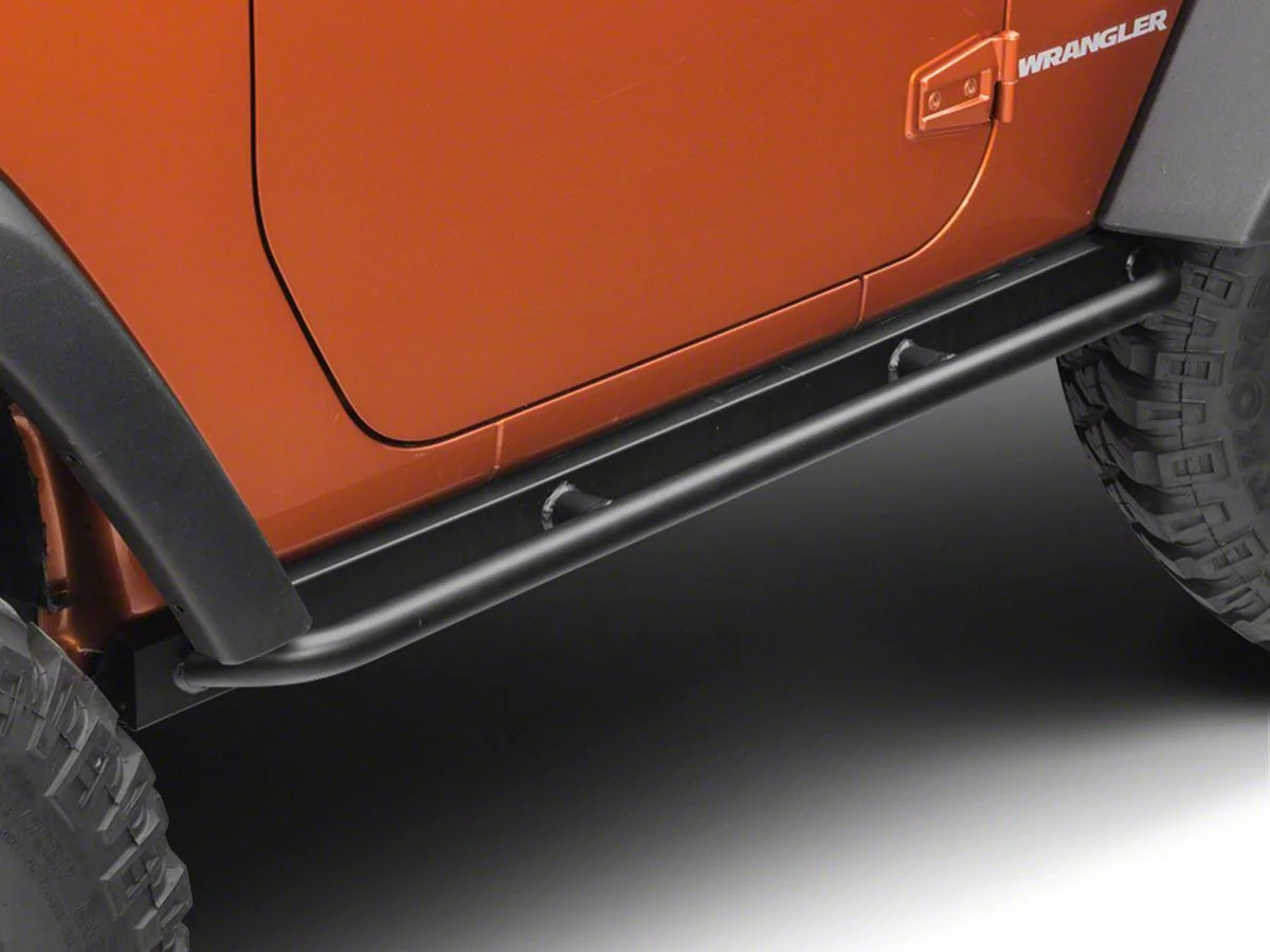

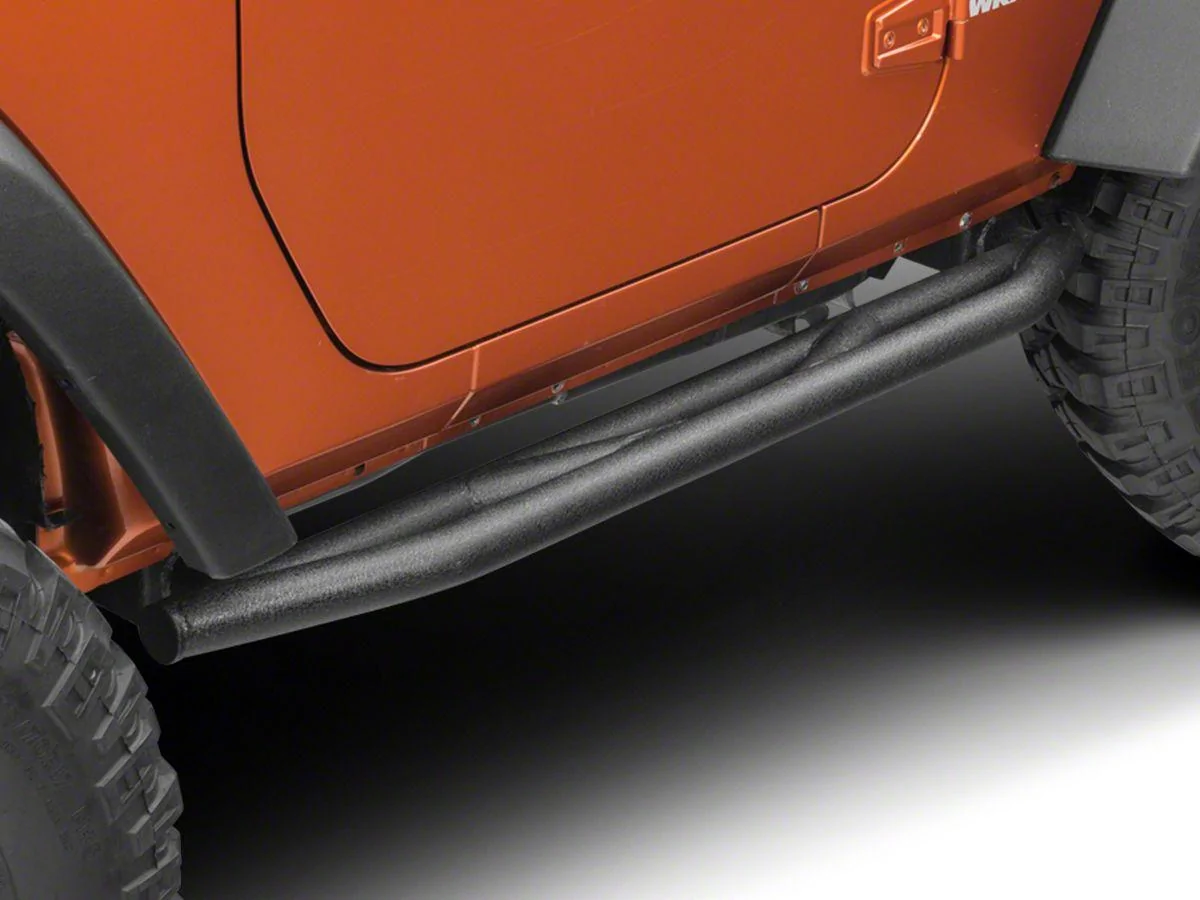

I know that Ace Engineering (https://aceengineeringandfab.com/) and Barricade (https://www.extremeterrain.com/barricade-rock-sliders-2018-jl-4-door.html) both have options for a slider that can be used on Jeep Rubicons with the factory rock rails -- I'm hoping both produce a similar option for the Bronco.
yea that would be ideal to just have something that can be used w/ the factory rails. If they make it for jeep I am guessing we will see it for the bronco. Hopefully sooner than later.

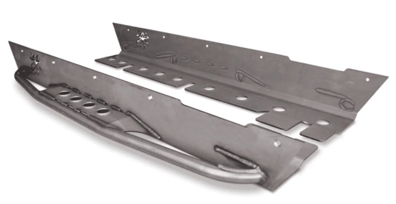

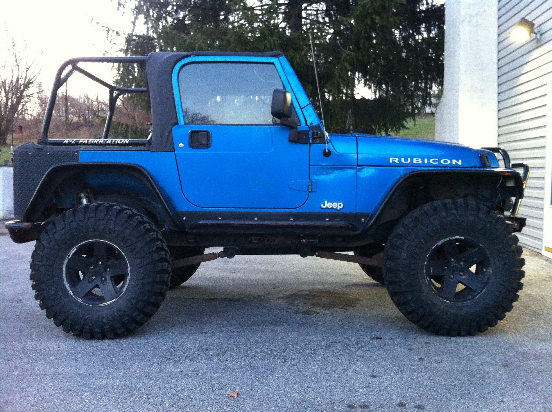

I've had both and I will take properly made BODY mounted rails over frame mounted rails All Day, Every Day. This is what I ran on my last jeep.
They extend under the rocker panel area and they sandwich between the body and the frame mount. Most brands have 5 to 6 points that bolt through the side of the body to a metal panel on the inside of the vehicle.

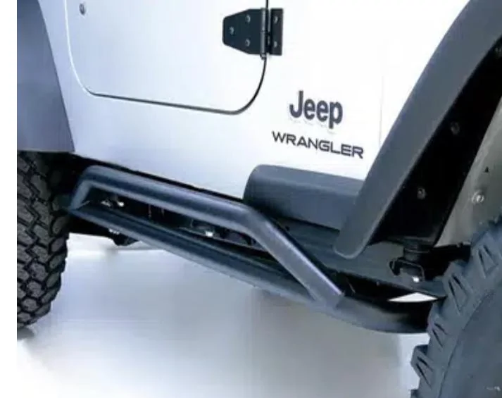

While these are not the exact brand/model of what I had, this is a really good view of a similar product before installation
https://shop.poisonspyder.com/LJ-Ricochet-Rockers-p/15-50-050.htm
When you are rock crawling, every inch of clearance, at every point of the vehicle is important. Eliminating things that can catch on a rock, or worse get caught under the vehicle, and cause you to get hung up, are things to avoid. At that point, the vehicle is 100% stuck and would need a Hi-Lift Style Jack to lift up that side of the vehicle and then winch or try to drive out while on the jack. Been there, and done that to help out a fellow crawler who was jammed up.
It's much better to have an absolutely flat and smooth surface that can not get caught and slide over all rocks. The smaller your tires and the lower your body is, the more important this becomes.

2021 Bronco Trail Armor Rocker Panel and Fenders Corners Ford Performance OEM factory accessory.jpg
Not a fan of the look of these options.
The idea is there i just think the execution failed

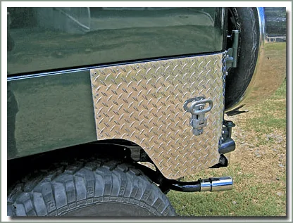

I have seen some diamond plate quarter panel covers for older FJ cruisers that I think look good.
not crazy about the looks either, just want functionality without the diamond plate panels .... i know they are somewhat popular with jeep owners
