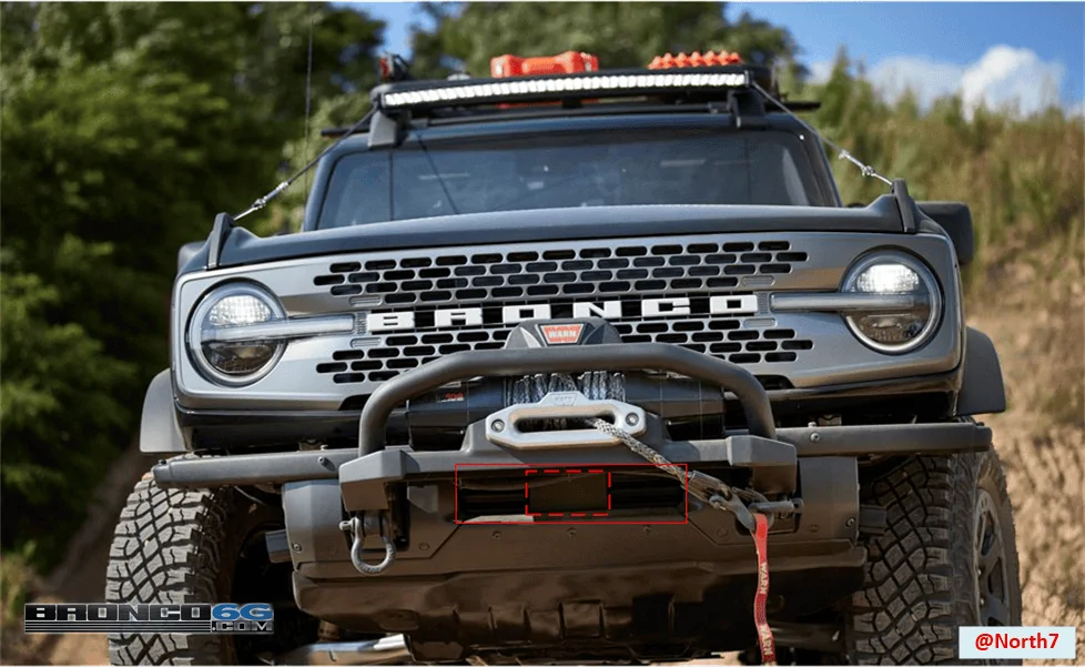

Why can’t the winch be set lower in the bumper?
Is it an airflow issue? Is it front/cruise control sensors?
I’m sure this has been covered else where but I can’t remember where I saw it.

Lots of folks think it will hinder the inter cooler... I think that’s what the consensus was
Correct, the intercooler (red solid line) and radar cruise box (red dashed line).

You think there is another way to get air to the inter cooler?
Maybe with a different design allowing airflow from each side?
This seems to be the real hang up with a winch in the bumper. I could care less about the sensor.
I’m not that mechanically inclined so I have no idea. I see you post here a lot and thought you may be a weekend warrior/gear head etc.

You could build a duct to pull the air into it... but it looks like it’s mounted pretty far forward.
my intentions are to use a winch cradle with only a receiver welded into the bumper... so I can move it from front to back as needed... or left in the garage during the week

@North7

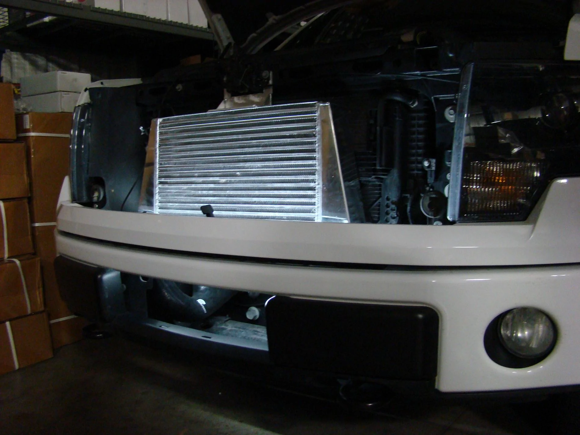

There are intercooler relocation kits, we have to wait and see what the aftermarket offers, here is an example from an F-150.
https://www.on3performance.com/shop/on-3-performance-ford-eco-boost-f-150-intercooler-upgrade/
A duct may not get the required air velocity. This is not a DIY project in my opinion where an aftermarket company can model the airflow and test for the temperatures to help protect your engine.
