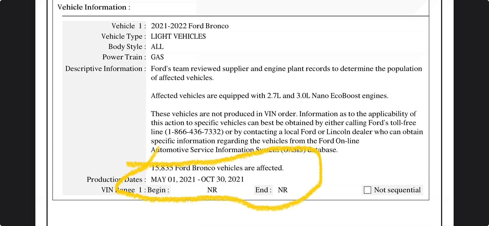

so how do we know if we are part of it? we get an email notification?
I pulled this from NHTSA website document and narrows it down to a build date range. And yup I’m right in the middle of it. 😬😔
