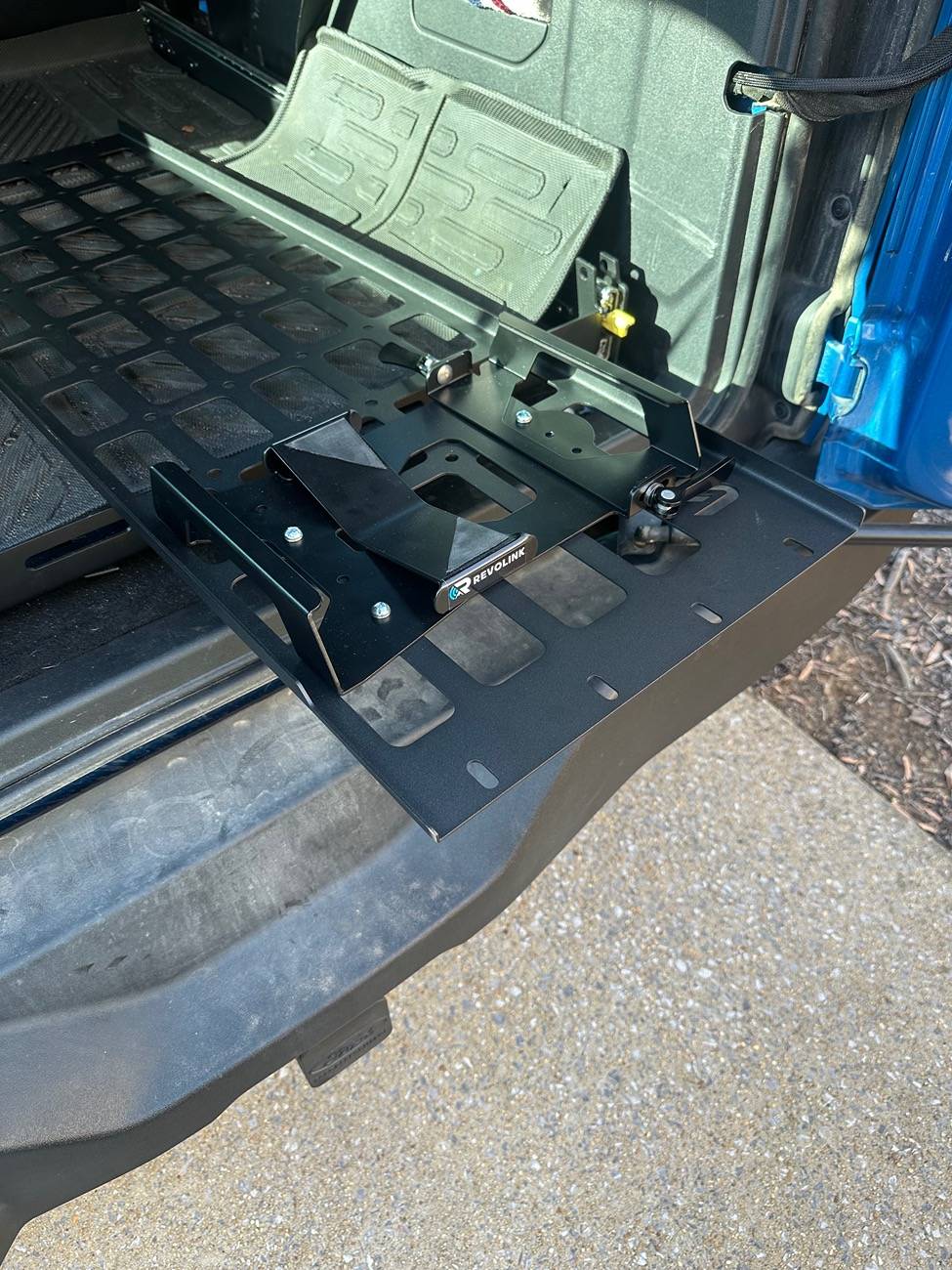

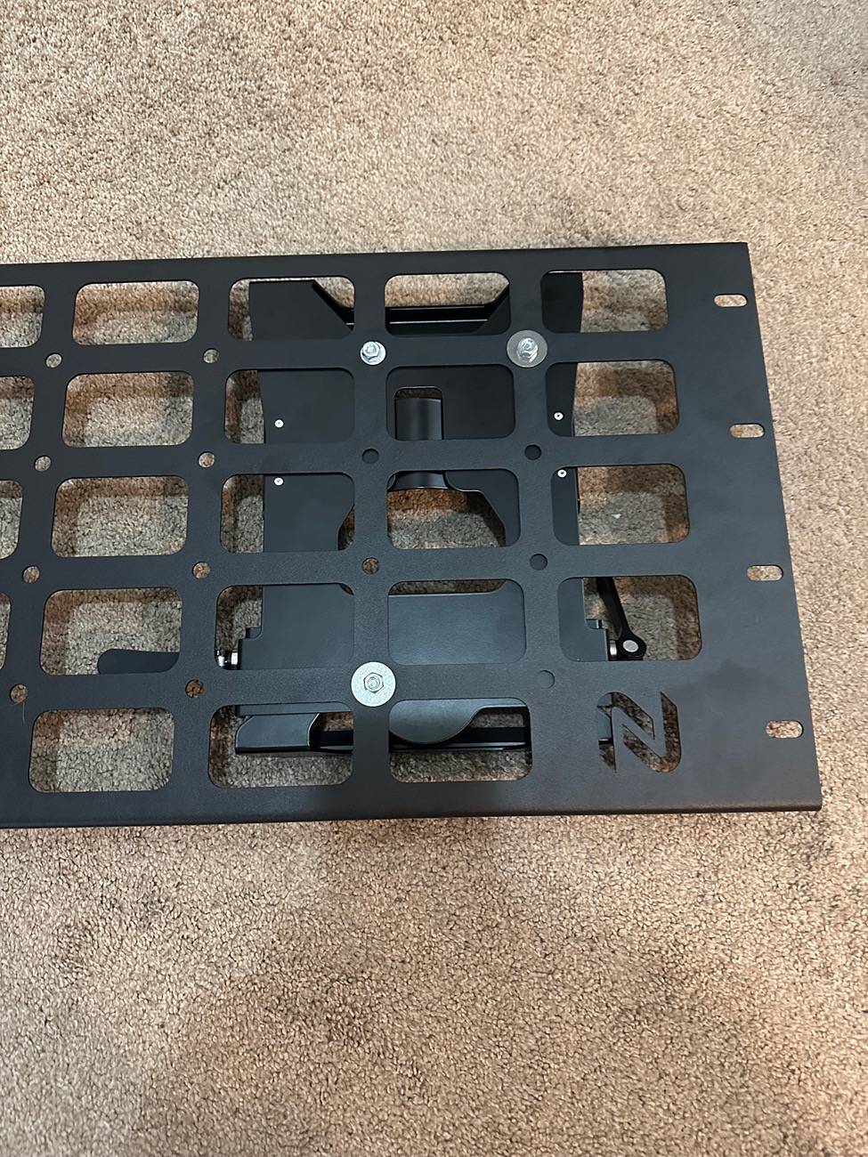

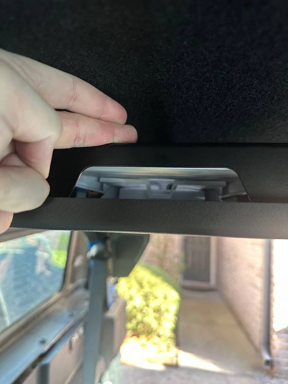

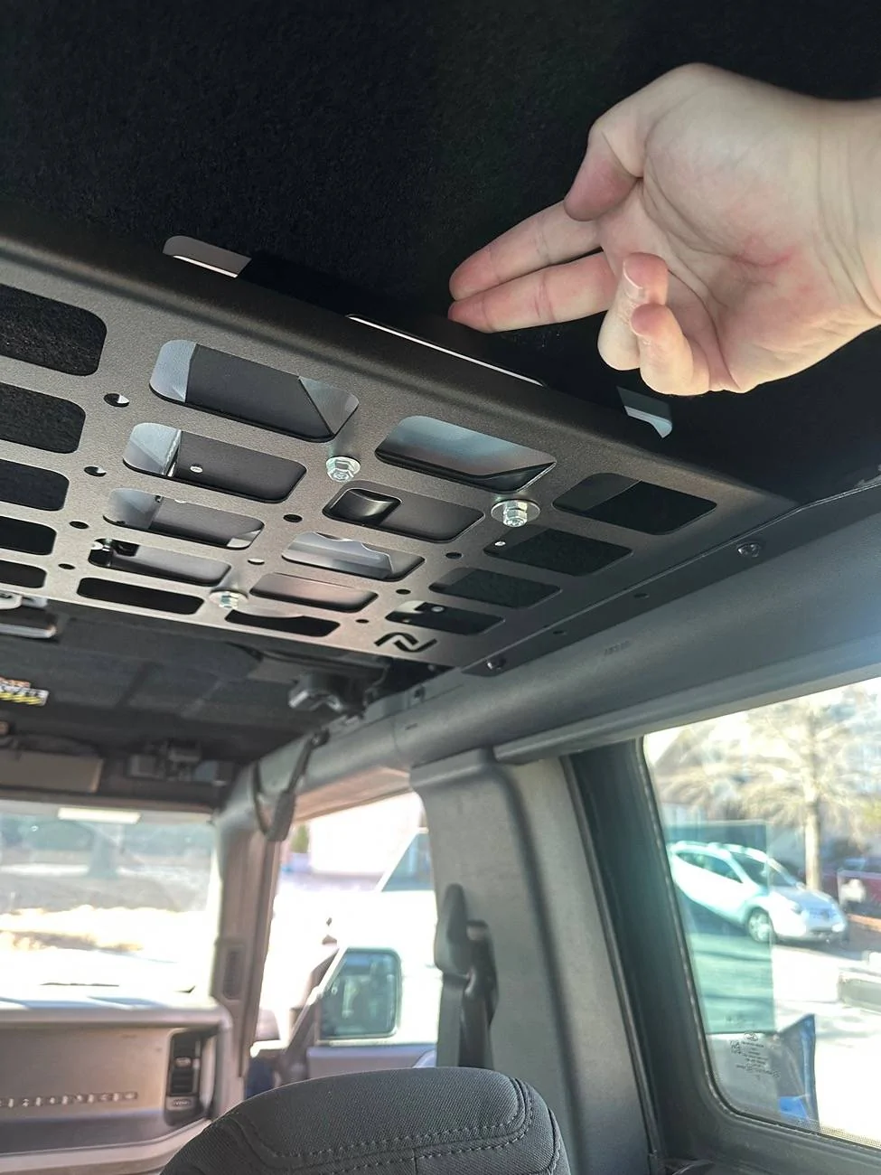

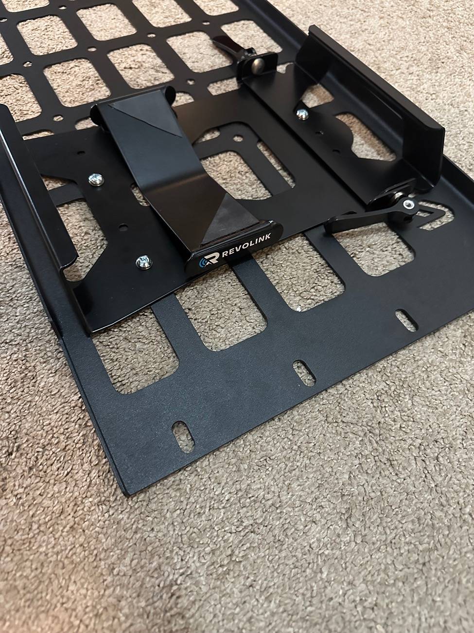

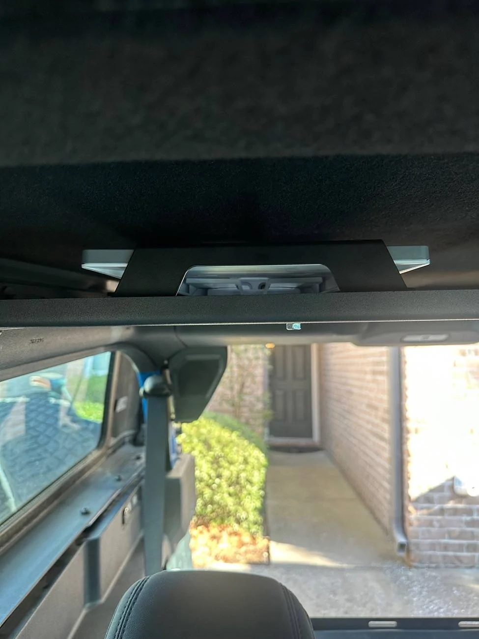

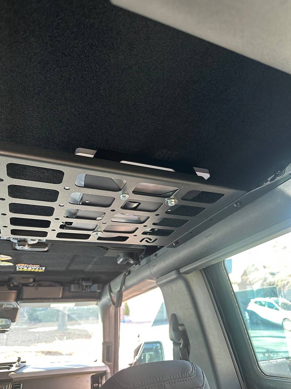

I haven’t seen many options out there for mounting a Starlink Mini in a 2 door other than some homemade mounts but I don’t have the expertise or patience to make. I pieced together something that actually solves this issue. I combined the @Desertchief Revolink Starlink mini mount and the @Turn Offroad overhead molle panel. The work around was flipping the mounting brackets on the molle panel to provide the needed clearance to be able to install/remove the starlink mini from the mounting bracket.

Great write up. Wondering if it would fit in a 4door.
To my knowledge, the Turn Offroad overhead molle panel is universal and works in both the 2-door and 4-door, so yes it should work in a 4-door. Depending on your need and application, Revolink makes a rear cargo mount for the 4-door and Raptors so you could mount it in the rear cargo area closer to the rear electrical plugs as opposed to over the back seat area.
https://revolink.com/collections/frontpage/products/2022-bronco-crossbar-kit

It goes through my fiberglass Rally Top with no issues, but yeah, I don't know that it would go through metal for a rack or anything, and I haven't tried it with my soft top yet.
Only hangups are driving through heavily wooded areas and overpasses - can't get around the "Clear Line of Sight to the sky" thing, which is easy to forget while driving. It won't affect streaming music most of the time - that usually has enough buffer to ride through, but if you are trying to make a call or anything real time it can get a bit janky.

I just posted my install and saw this pop up as a suggested post under it.
I also used the Turn off road overhead molle rack with the brackets flipped over.
Grabbed a magnetic mount made for roof top use.
I'm running mine thru a Jackery Explorer 100 Plus to keep from rebooting every time I shut it off somewhere. Jackery run to the rear 12V to keep it topped off.
Love your setup, the mount looks great.

Just got this same setup, but the holes for the revolink mount, and molle panel don't align. I'll have to figure something out. I may just fabricate a custom mount leveraging the speaker attachment points.
