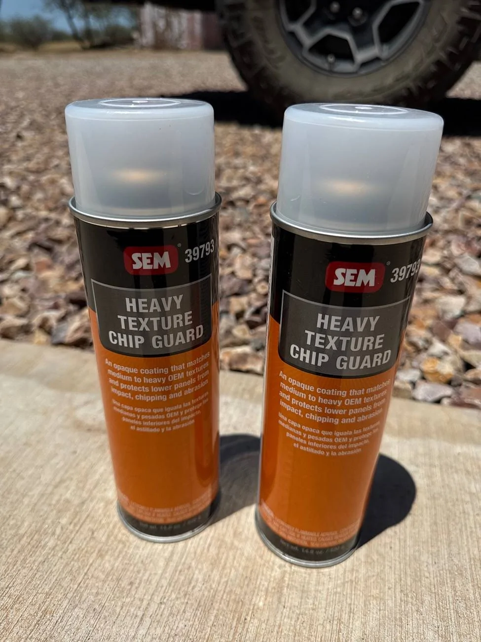

While Sasquatch fenders helped quite a bit, the factory Goodyear MTs were just too much of a rock thrower to keep chips off my door and surrounding. I switched to Nitto Trail Grappler MTs in 35x11.5 (same as my Jeep and plenty of fender coverage for both). I love these Nittos -- but the damage was done. Trail Grappler MTs throw a lot less of the little stuff that I think is the culprit out here in SE AZ. The big void areas between blocks help a lot.
Anyhow, I considered mud flaps but really don't like them (and they get in the way on trails). I also bought some vinyl but decided to go the spray-on route. If a local "rhino lining" type shop were around, I'd have considered that too...
A buddy that knows about such things recommended SEM. I chose this in "opaque" since I wanted to cover some damage. We also used a high quality paint prep and finished things off with an all-in-one Krylon that matches (or at least complements) the factory paint color. Note, the "opaque" is basically grey-white and would probably look good as-is on lighter paints. It was too stark for me, but I'm happy with the results with my attempt to color-match.
One can of each was enough for my 2-door, but just barely. Depending on your application preference, I'd recommend two cans. For the time and money invested, I'd say it is worth considering (couple hours plus $35ish in supplies). I'm happy with it.
Final outcome:
Ford Bronco Paint chips from rocks?  DIY protection with Heavy Texture Chip Guard Spray by SEM 1752420507628-ao
Damage (both sides had significant chips):
Ford Bronco Paint chips from rocks?  DIY protection with Heavy Texture Chip Guard Spray by SEM 1752420090673-2s
Base chip guard with three coats:
Ford Bronco Paint chips from rocks?  DIY protection with Heavy Texture Chip Guard Spray by SEM 1752420341014-io
Ford Bronco Paint chips from rocks?  DIY protection with Heavy Texture Chip Guard Spray by SEM IMG_0211

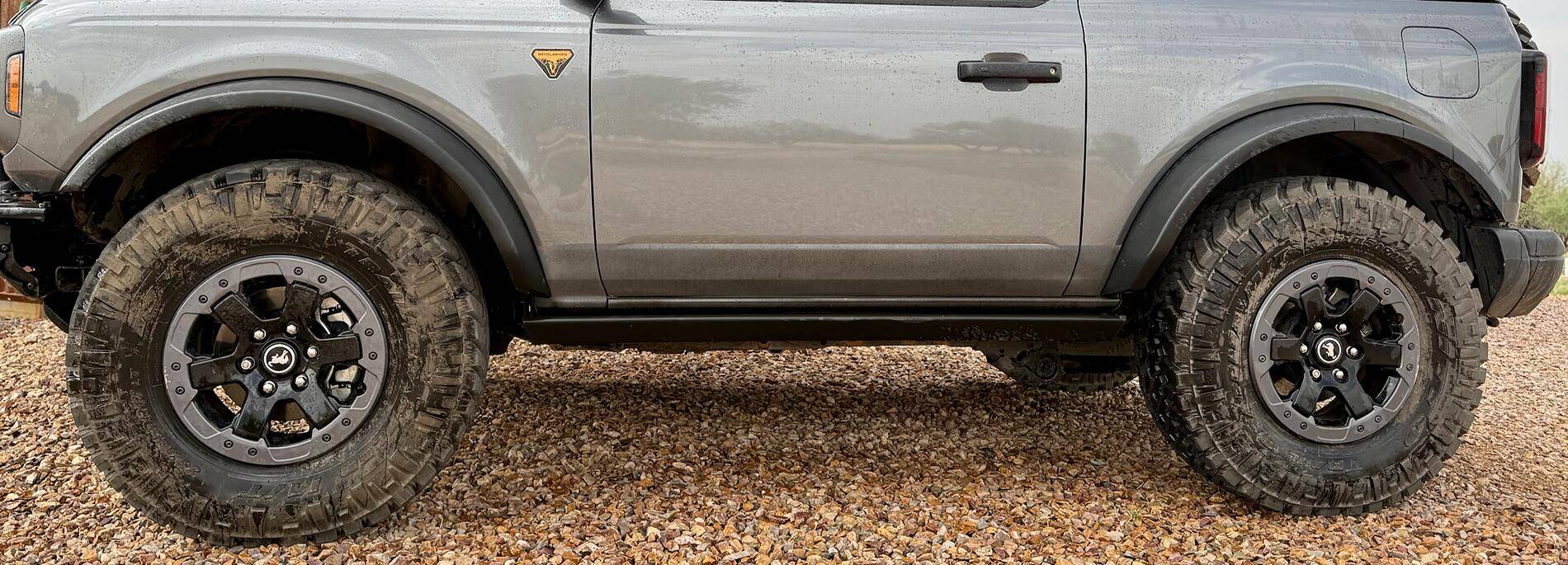

Here's one very dusty Bronco...
Ford Bronco Paint chips from rocks?  DIY protection with Heavy Texture Chip Guard Spray by SEM IMG_0224
*A big storm just rolled through. Here's a shot while still wet.
Ford Bronco Paint chips from rocks?  DIY protection with Heavy Texture Chip Guard Spray by SEM 1752507941873-tx

Nice lookin' Bronco! :love: I've never noticed those creases down low on the door before. 🧐
