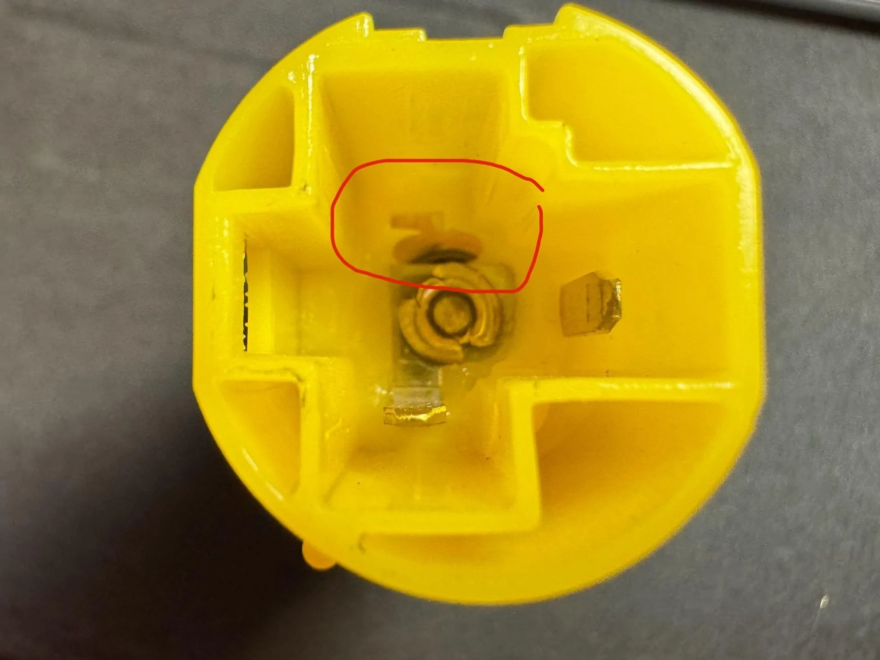

I can confirm that this is an issue for the 12v outlet in the cargo area. I charged an EcoFlow Delta and it stopped working.
I tested the wiring harness for the outlet with a multimeter and got 12v DC but the outlet itself will not power anything. Mine appears to show melting as well.
According to EcoFlow it should only draw 10A which is well below the fuse rating for the outlet. I have confirmed that my fuses are fine so this is clearly a defective part and also a potential fire hazard.
I do not recommend plugging a fridge, power station, or anything substantial into this outlet.

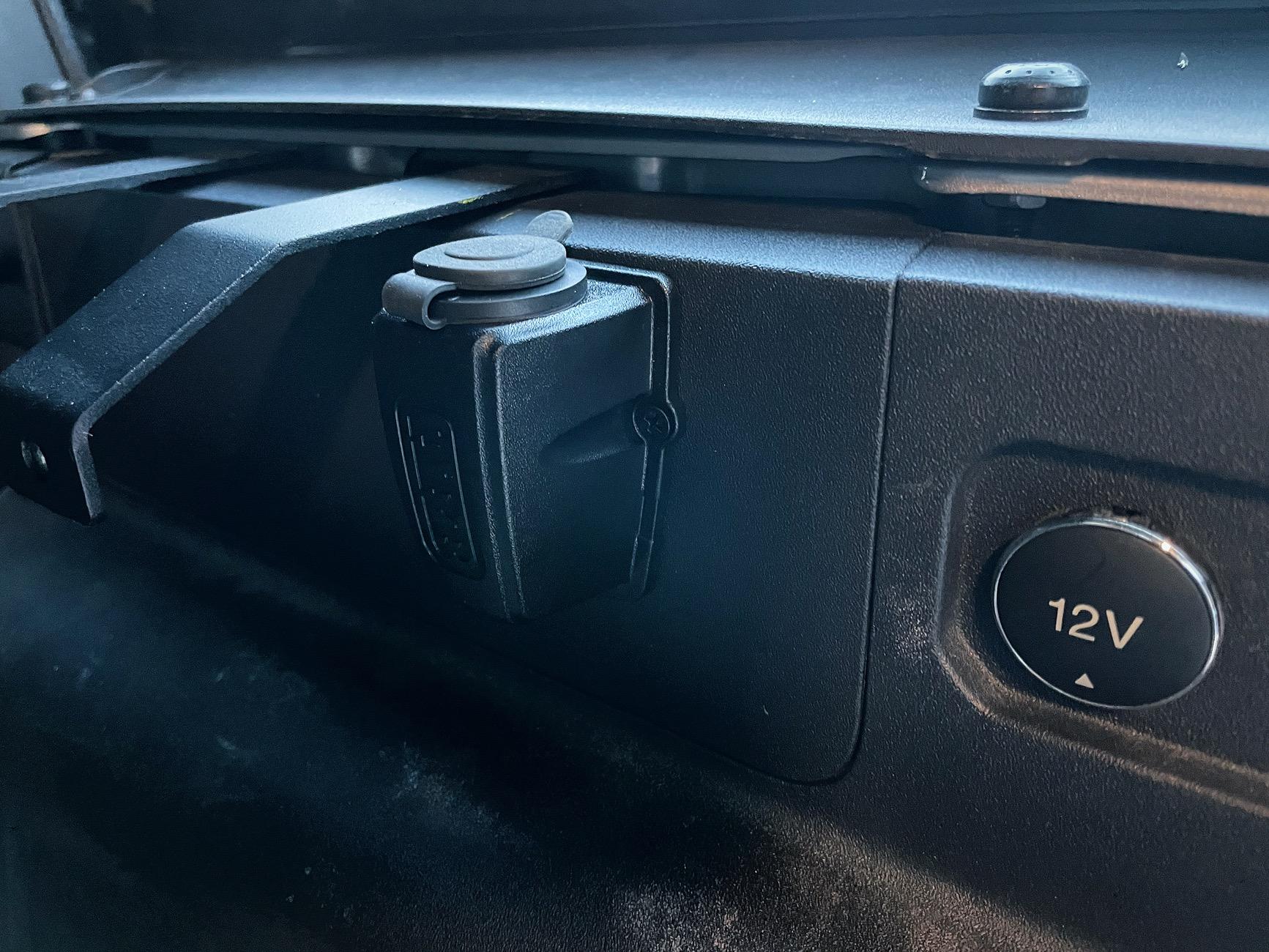

Ford Bronco 12v outlets & power stations IMG_2733
Ford Bronco 12v outlets & power stations IMG_2734

Hello 6G forum! First time posting. I took delivery of my 2023 Badlands this February and absolutely love the thing.
Last month I did a month-long overlanding trip out west. I was powering my Anker 757 via the rear 12v outlet, which powered my fridge among other things. I used the provided 12v cigarette lighter power cable that came with the Anker. It all worked great for the first 20 days or so of the trip and then both of the 12v outlets in my Bronco gave out. I’m no car expert but I did check the fuses and that wasn’t the issue.
Today I dropped it off at Ford since it’s still under warranty. They claim that maybe it won’t be covered under warranty. 😠
My question is is this something I should have had an inverter for the whole time? I asked Anker how much power it draws via the 12v cable and they said 120w/hour at around 10a. Any insight or suggestions? Thanks!

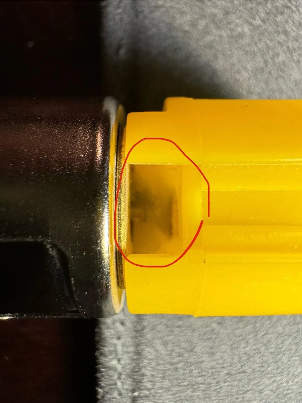

Factory socket uses 16 gauge wire. That’s the issue. My fridge would cut out and give an E1 error all of the time. No matter which battery protection setting I used.
The Bluetti on the other hand should NOT have been a problem…but, it was. Same issues you guys are having.
I installed the ARB socket that comes with 8-10 gauge wire directly to the battery. I was sick of not being able to depend on the factory 12v. This has been flawless and dependable all summer.

16 AWG wire at 12VDC can handle 10 Amps so that’s not the issue. It’s the socket itself that is melting. Guess I need to invest in a DC-DC converter or a separate socket like the ARB. Pathetic that Ford can’t get a simple thing like that right.
