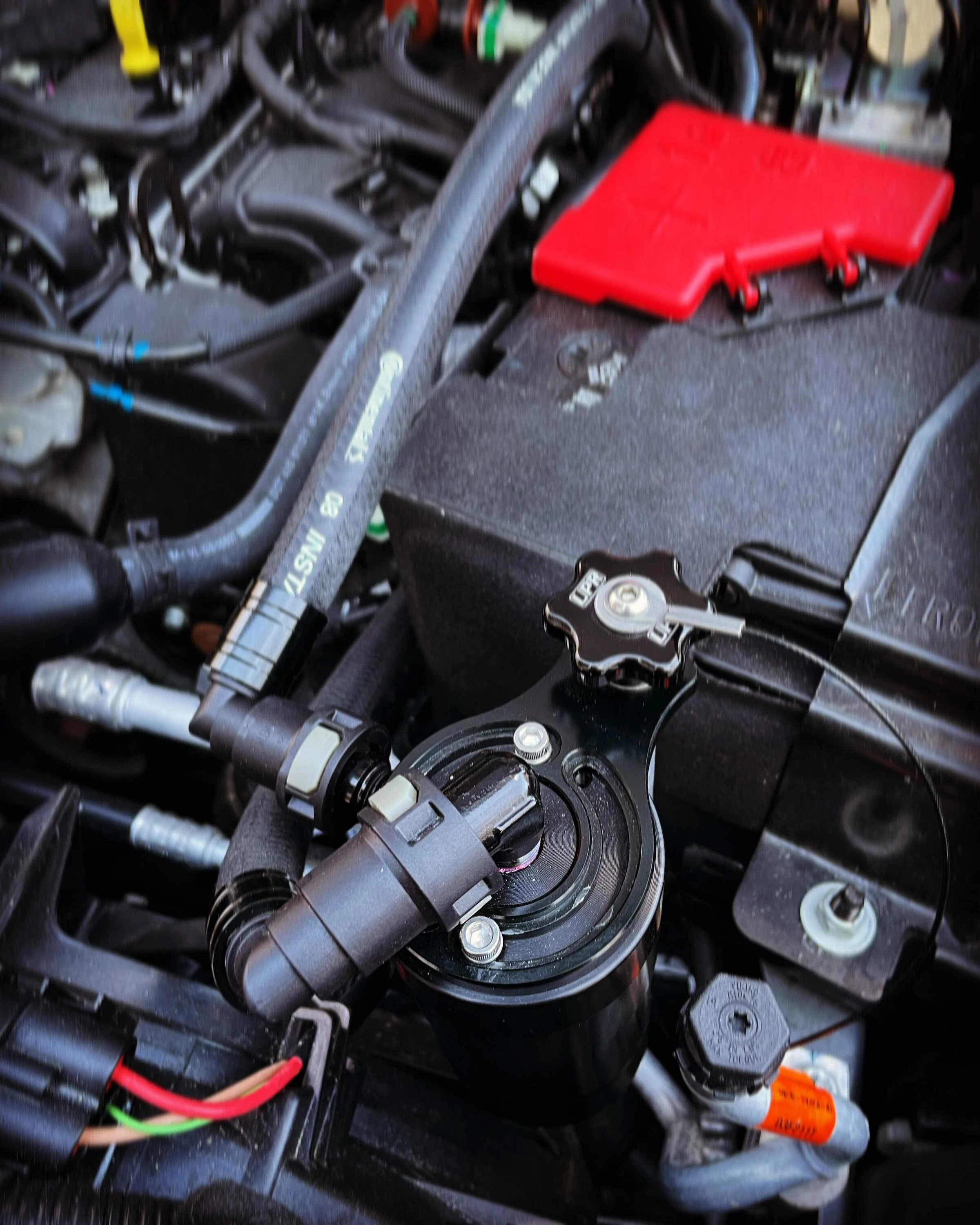

The UPR comes with mounting hardware to locate it just in front of the battery. Easy access IMO.
Just be sure to use the correct hose - the longer one is the “dirty” line - either way works - but, I’ve got a bit of extra slack now - and trust me - once you get the fittings attached - you will rejoice and not want to attempt to remove them. Your knuckles will thank me.
Yup! Getting the stock hoses disconnected and then getting the UPR hoses connected is a challenge, and not one I want to do again. On the positive, I found it interesting to have a good look at the back of the engine when I was doing the connections…
