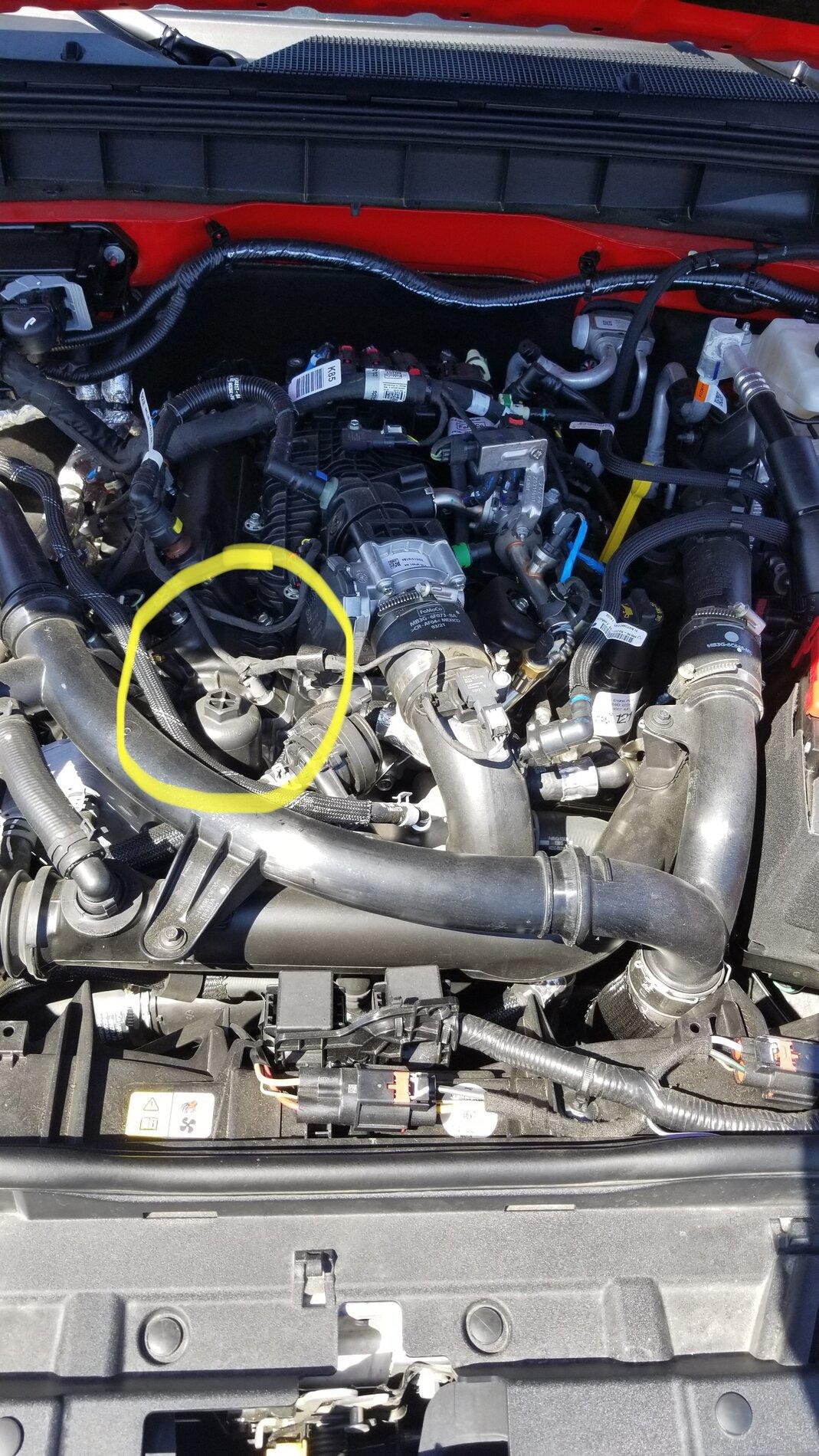

Any of you lucky new 2.7 owners try and access your oil filter yet?
Last I saw there was still some question about how easy it was to access for oil changes.

If it's like the F150 2.7 the oil filter is a cartridge filter on top of the engine super easy to get to.

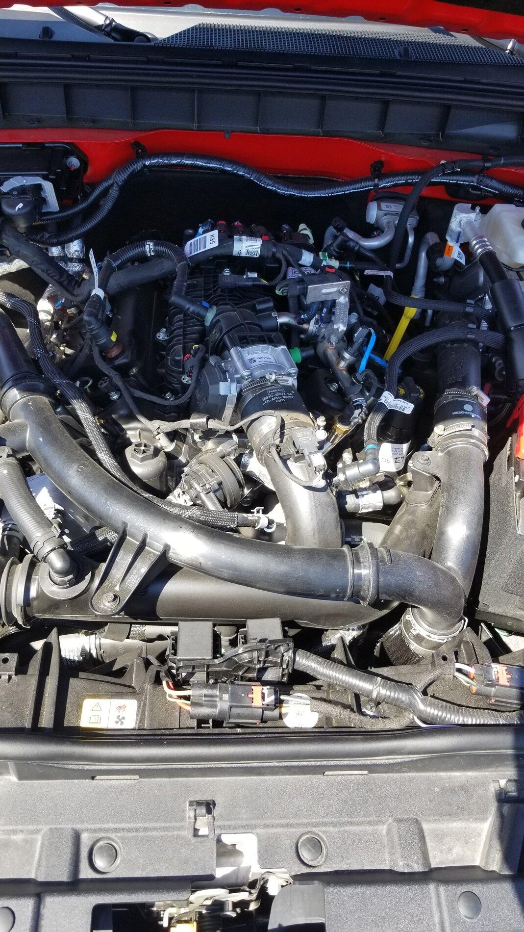

Pic of 2.7L from Bronco showing Springfield Mo.
Ford Bronco 2.7 Oil Filter access 20210419_151130
Ford Bronco 2.7 Oil Filter access 20210419_144844
Just about everything I've seen this far was along those same lines of "if it's like X vehicle then".
Now that we've got some actual owners, I figured we could get some first-hand experiences of exactly how easy oil changes will be.
From those photos, it seems like the filter should be easy enough - though I am curious how easy it is to get the factory-installed filter loosened the first time.

don’t worry. It is the easiest filter to remove. If you want to worry then worry about the plastic drain plug and what happens when you remove it.
here’s the video for the 2.7 on the f150

The hardest part of changing the filter is replacing the one small oring everytime on the plastic stalk. The plastic drain plug uses an ORing and is just a quarter turn to lock in place. While the drain plug oring may one day need replacing after 80k+ miles in the f150 It looks newish.

ok. I looked at that and wondered but I'm still so used to the oil filter being a painted metal canister I ruled it out since it looked like casing for something. Thanks!
Yeah it was odd to odd to me at first as well in his challenger. But because it is just a paper cartridge you replace I guess plastic is a better material for it.
