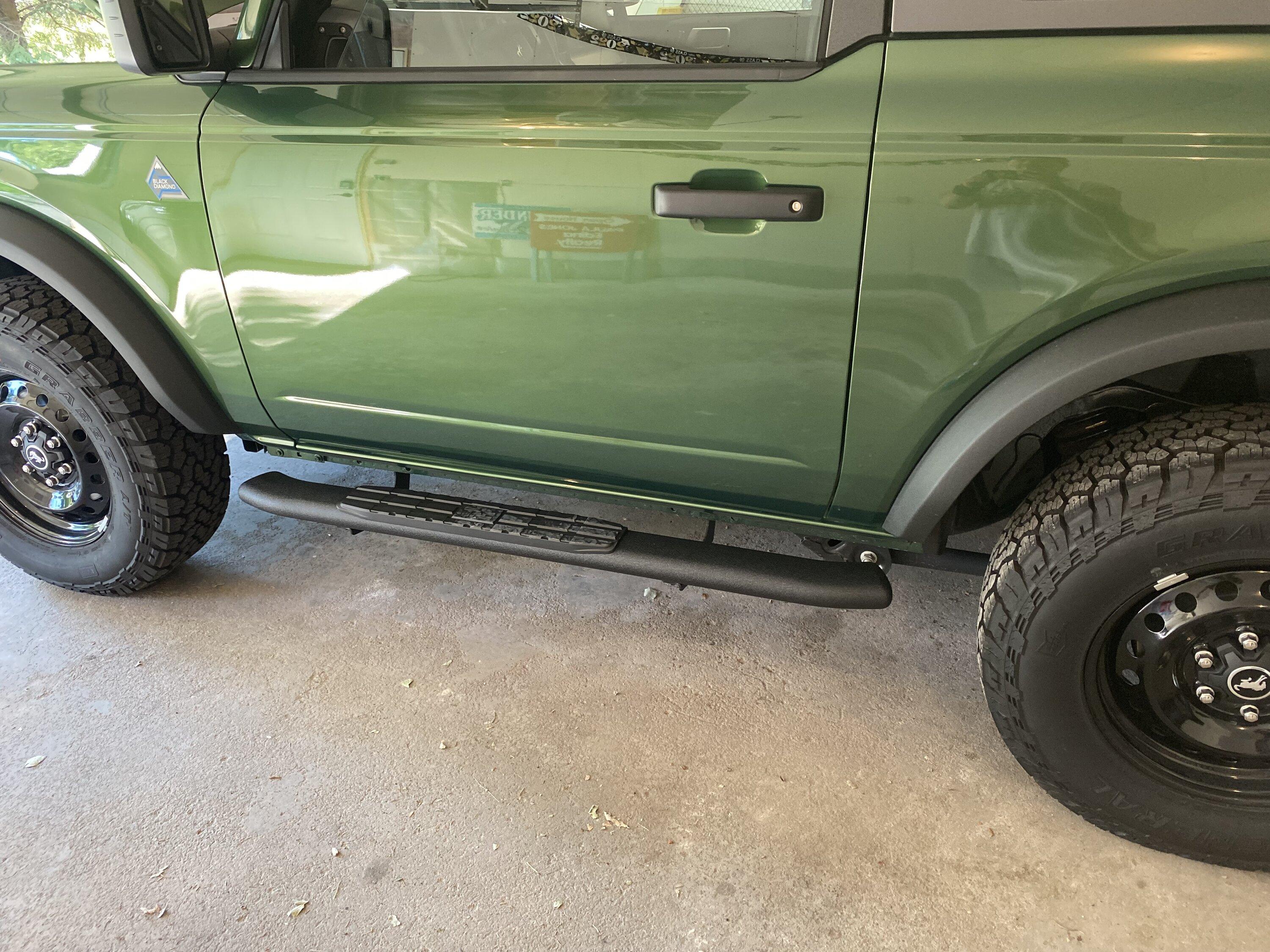

These are the N Fab nerf steps I'm pretty sure they're the same thing as the Rough Country ones. No idea how long they'll last but they were affordable and I like how they look and function.

Pretty easy to install?
Yes took about 45 mins, because I had to remove the OEM rock rails. Did it myself with no assistance. Install the front and rear brackets, then lay the step across the bracket arms and screw in each end to the arms.
Drawback is, you can't have the OEM rock rails and the side steps on at the same time.

That was my next question (aka, can the rock rails and side step coexist). Thanks for the input!

I wanted them to coexist too, but they can't. The step brackets use the same holes as the rock rails brackets. The step brackets don't hang low enough to get around the rock rails, and are too close to the body. The curvature of the step itself would hit the rock rails. Suppose you could fabricate your own step brackets, but I didn't want to do that much work.
Removing the rock rails exposes the pinch weld, which is ugly. So I covered the pinch weld with this
