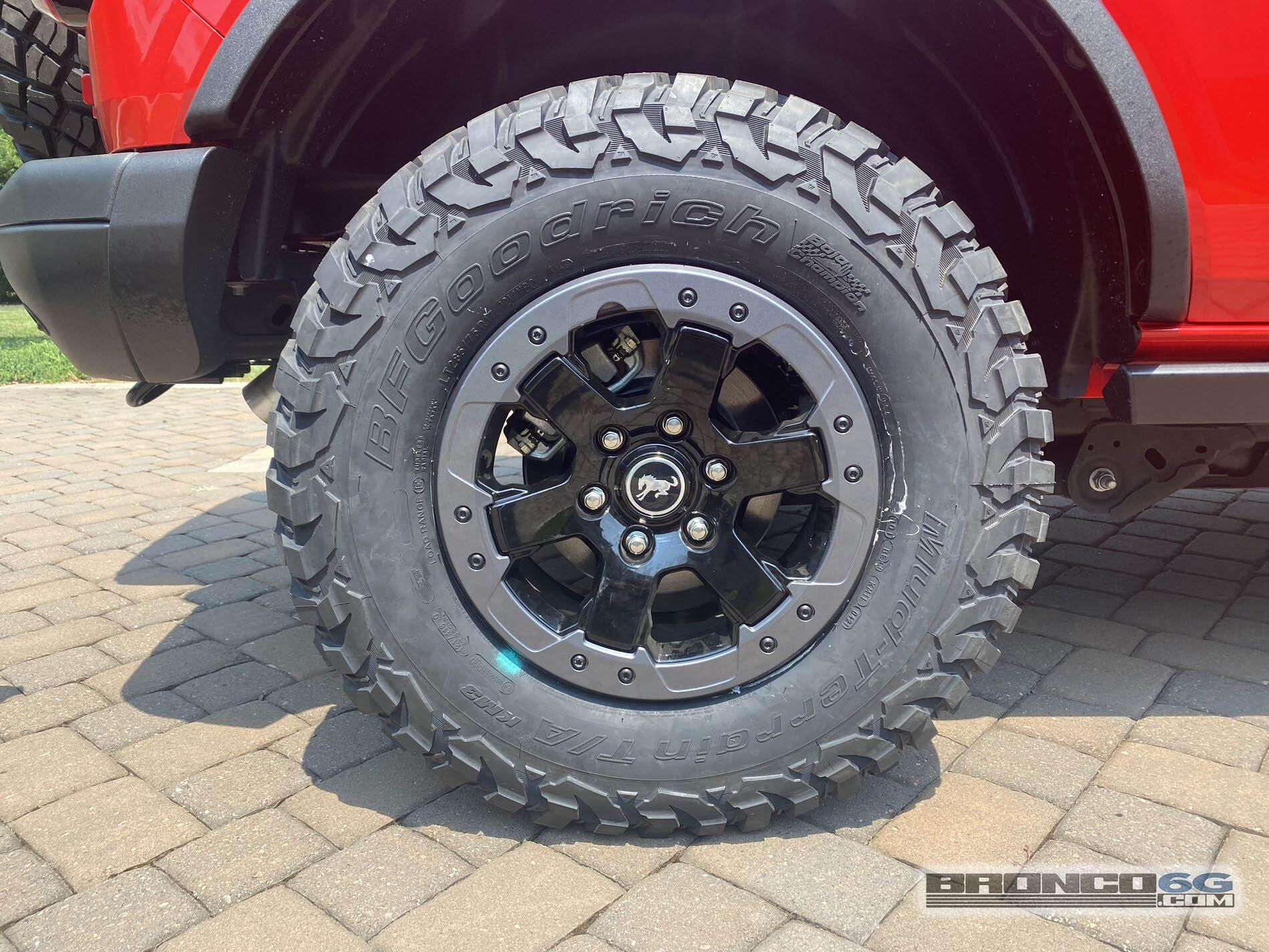

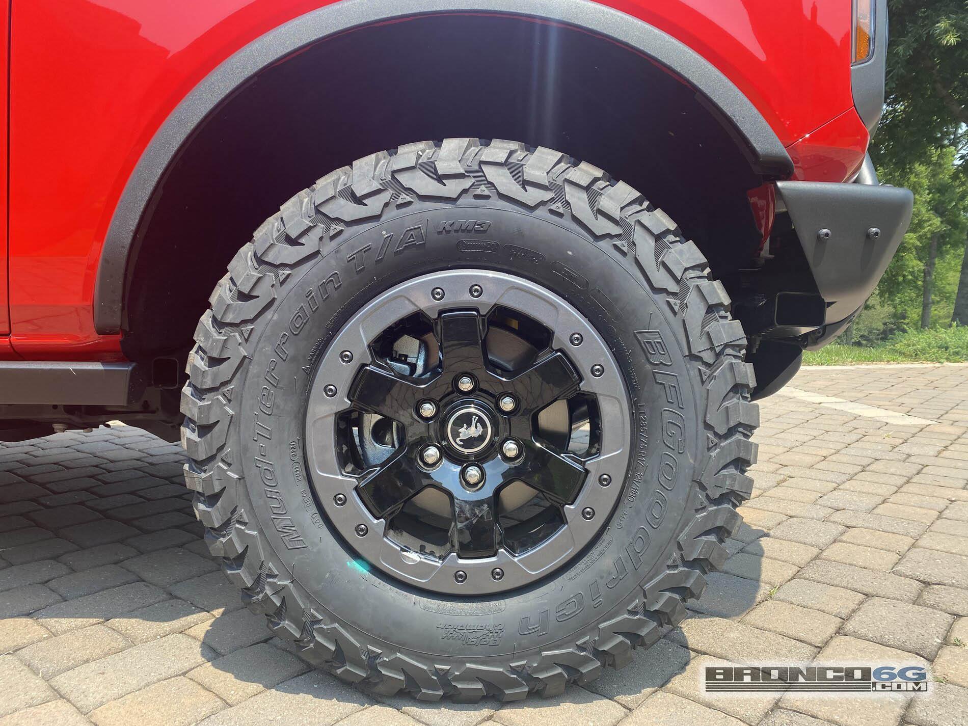

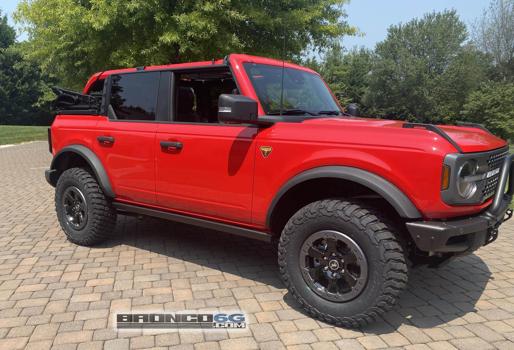

This is my BL, non-sas, with the optional beadlocks on BFG KM3 285/75/17 Mud Terrains. My goal was a little chunkier look with a more aggressive tread pattern. No rubbing even at full turn. Didn’t touch crash bars. I needed to shave a little off the spare tire rubber stops to accommodate the added thickness. 3rd brake light in original position. I lost a little ride quality and added a little road noise. Exactly the look I wanted.
Bought tires back on Memorial Day when on sale. Paid about $1800 less $70 rebate (Simpletire.com) for 5 tires and $150 for mount/balance (local Firestone).
