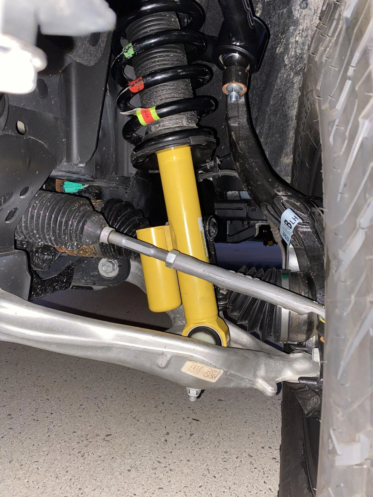

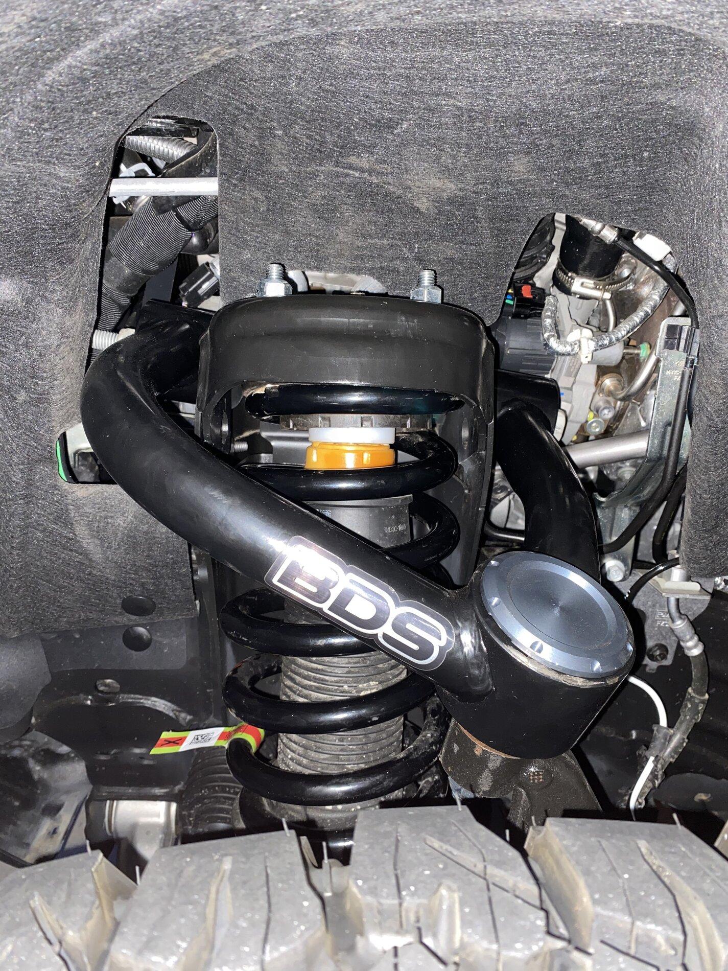

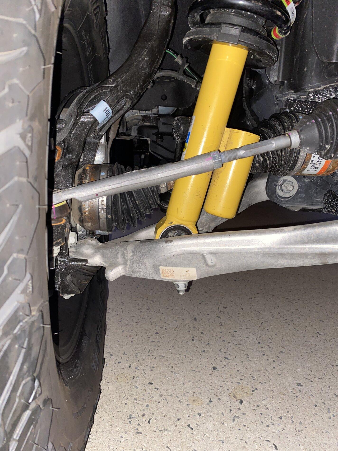

Updated with suspension pics:
Ford Bronco Pics of Maxlider 4” Lift Kit Stage 1 on First Edition Bronco 18162d36-76b9-413e-a0c4-c7490cc8b81d-jpeg
Ford Bronco Pics of Maxlider 4” Lift Kit Stage 1 on First Edition Bronco aef8b28e-8f24-432b-bd84-b1383901deab-jpe
Ford Bronco Pics of Maxlider 4” Lift Kit Stage 1 on First Edition Bronco be0fa2de-4f89-4947-8d5a-5abd9421b96d-jpe

Picture of CV angles? Does the 4 inch lift do anything to compensate for CV issues? How does it look with some droop and turn?

Cool, what parts do you get with that?
Here is the list… basically some custom fit BDS control arms and a special Zone spacer kit. It’s compatible with their stage 2 coil over kit that is not out just yet.
2 - BDS Suspension upper control arms (left & right)
2 - front upper strut spacers
2 - rear upper strut spacers
2 - 3/8" rear upper strut spacer
2 - front preload spacers
2 - front bump stop extensions
