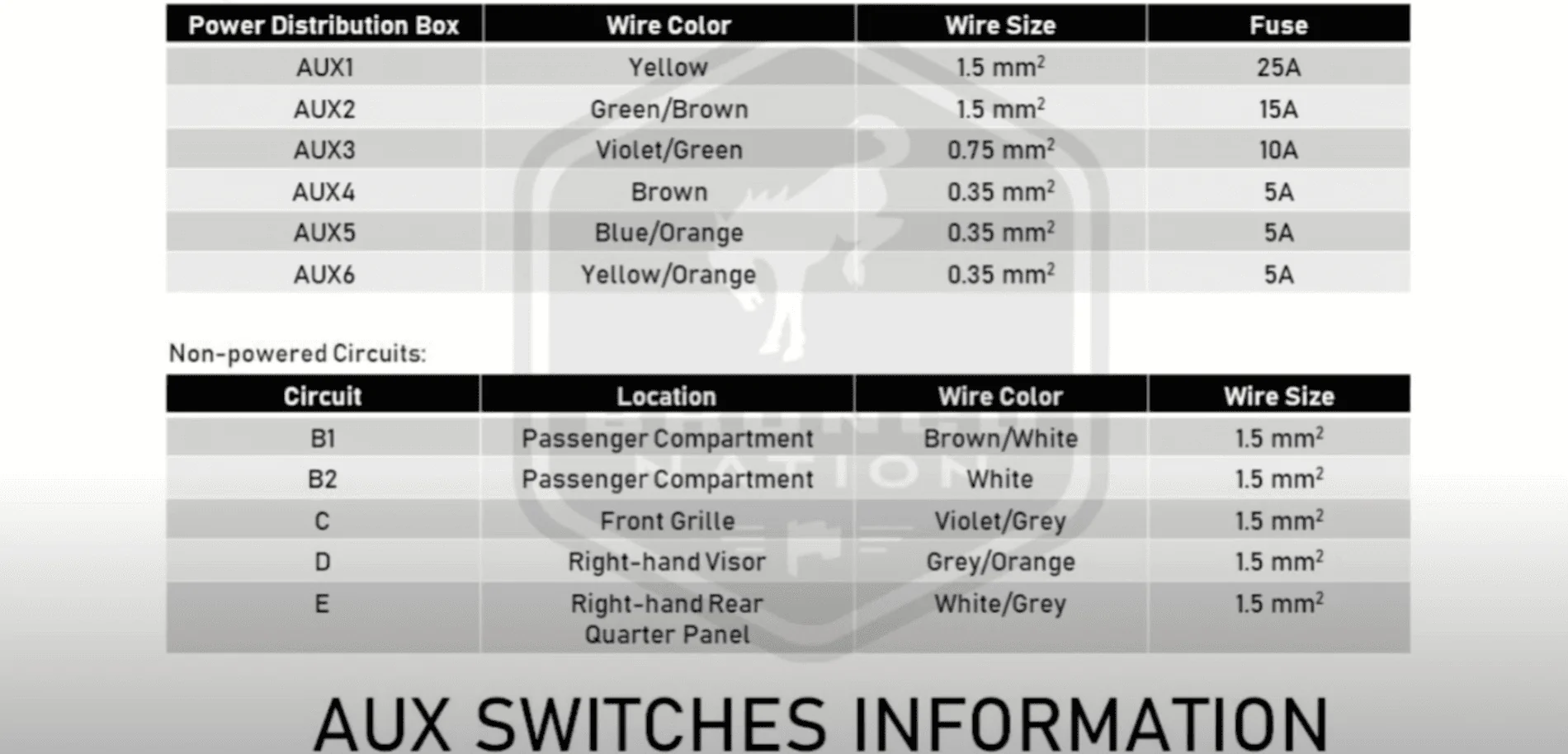

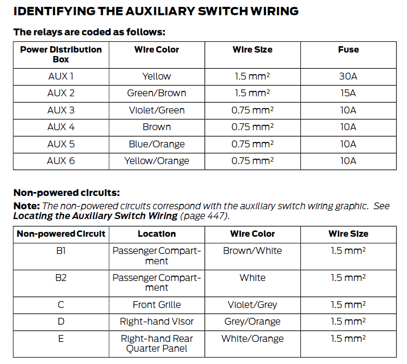

I was going through my digital manual and caught that the Aux switch ratings were different than what Bronco Nation had released previously. My apologizes if this has been covered already but I did not see it posted anywhere as I was looking for confirmation.
Previous info released by Bronco Nation:
What the Manual shows (and I did confirm the fuse size matches):
