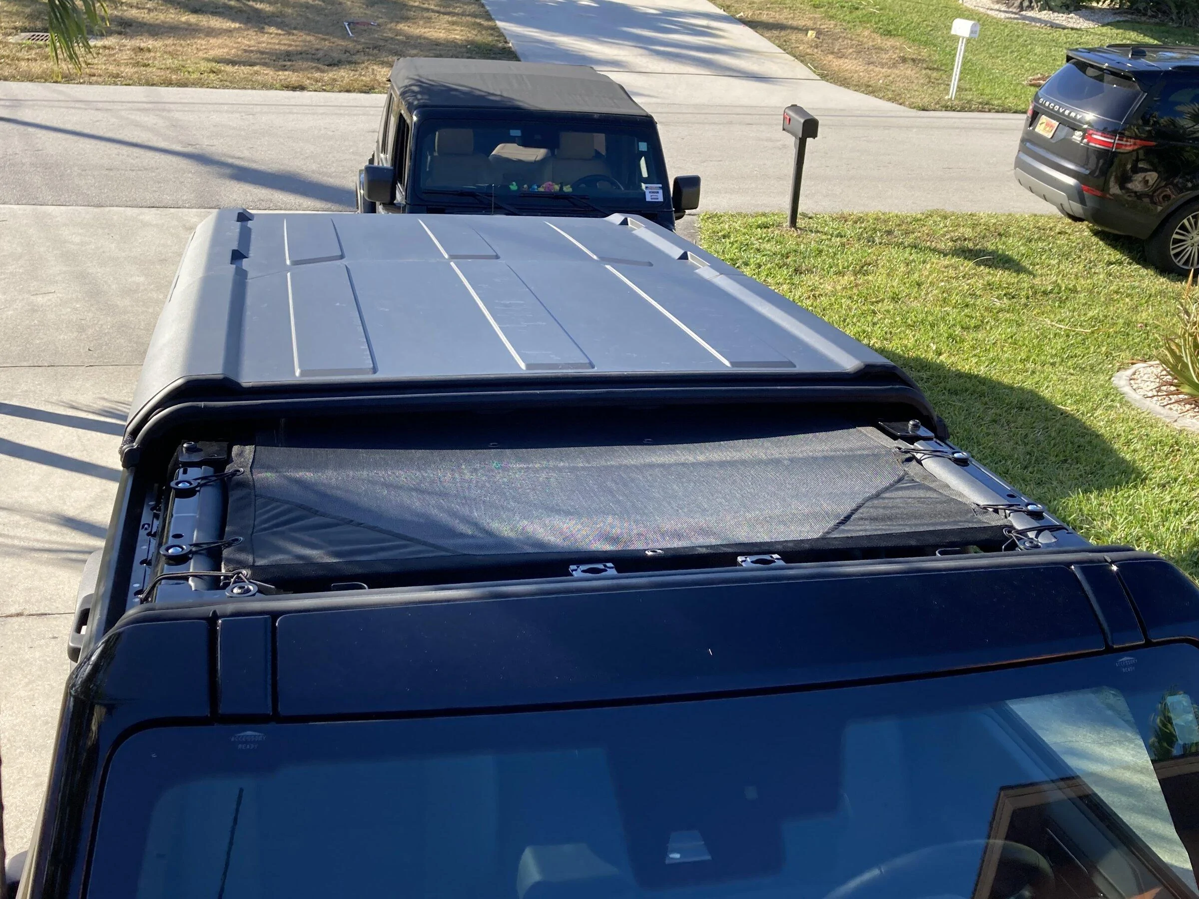

Y'all asked for it, so here is our offering for a solution to use the hardtop and the mesh at the same time! Will work for the 4 Door and 2 Door! 😉
NOTICE: This will require drilling into two of your hardtop twist locks.

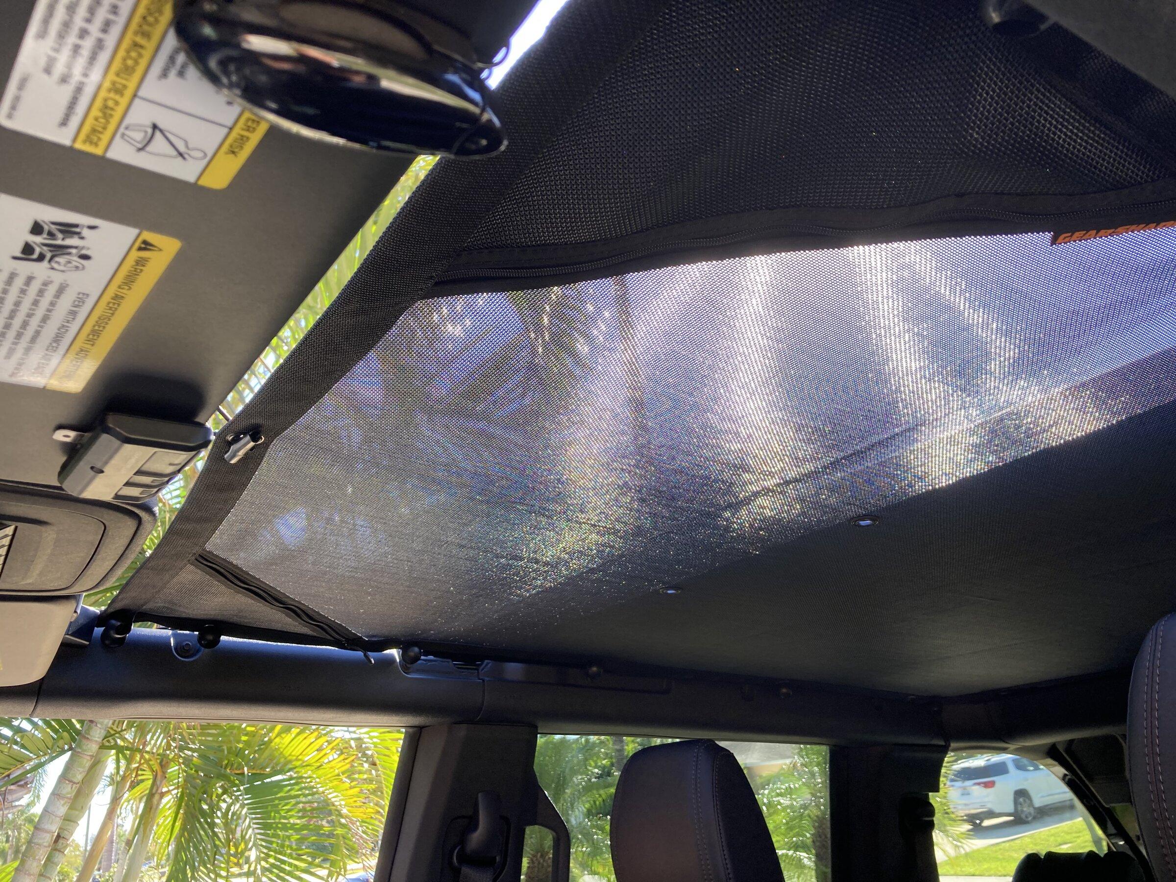

Installation is very easy. Basically, you will remove the 2 centermost twist locks and install our stainless steel plate add-on. The mesh will have two grommet holes for an 8mm T-handle Allen wrench to pass through. You will use the Allen wrench as a "key" to twist the locks to open and close.

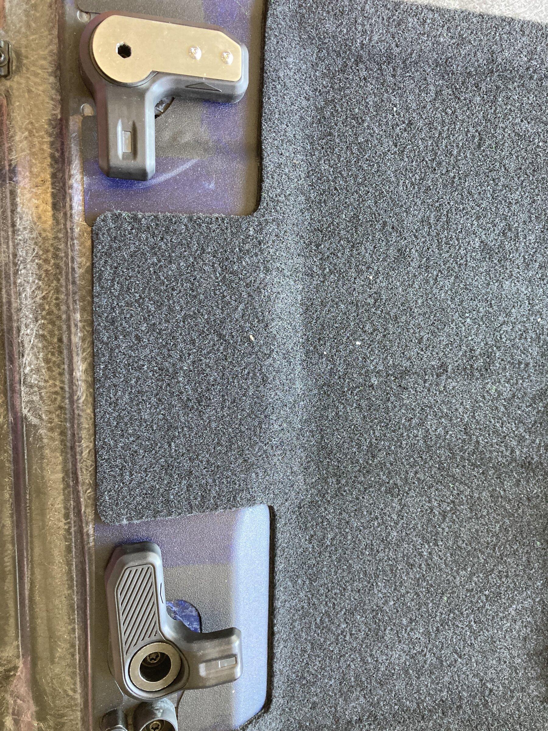

-Remove front panels
-Remove twist lock from the panel with your Bronco OEM tool kit.
Ford Bronco GearShade Mesh Top HARDTOP VERSION! 20220203_090404
-Please plate over the twist lock (clamp it in place) and drill two 4mm (3/16") holes through the holes in the plate
Ford Bronco GearShade Mesh Top HARDTOP VERSION! 20220203_090706
-Install provided M4 nut and bolt through the plate into the handle
-Reinstall the twist lock into the panel
Ford Bronco GearShade Mesh Top HARDTOP VERSION! 20220203_091024
Ford Bronco GearShade Mesh Top HARDTOP VERSION! 20220203_091313

*Removal of the front center bungee and clips is necessary while the hardtop is on. When you remove the panels, reinstall the bungee and clips.
The remaining twist locks and latches will be accessible from the edge of the mesh.
