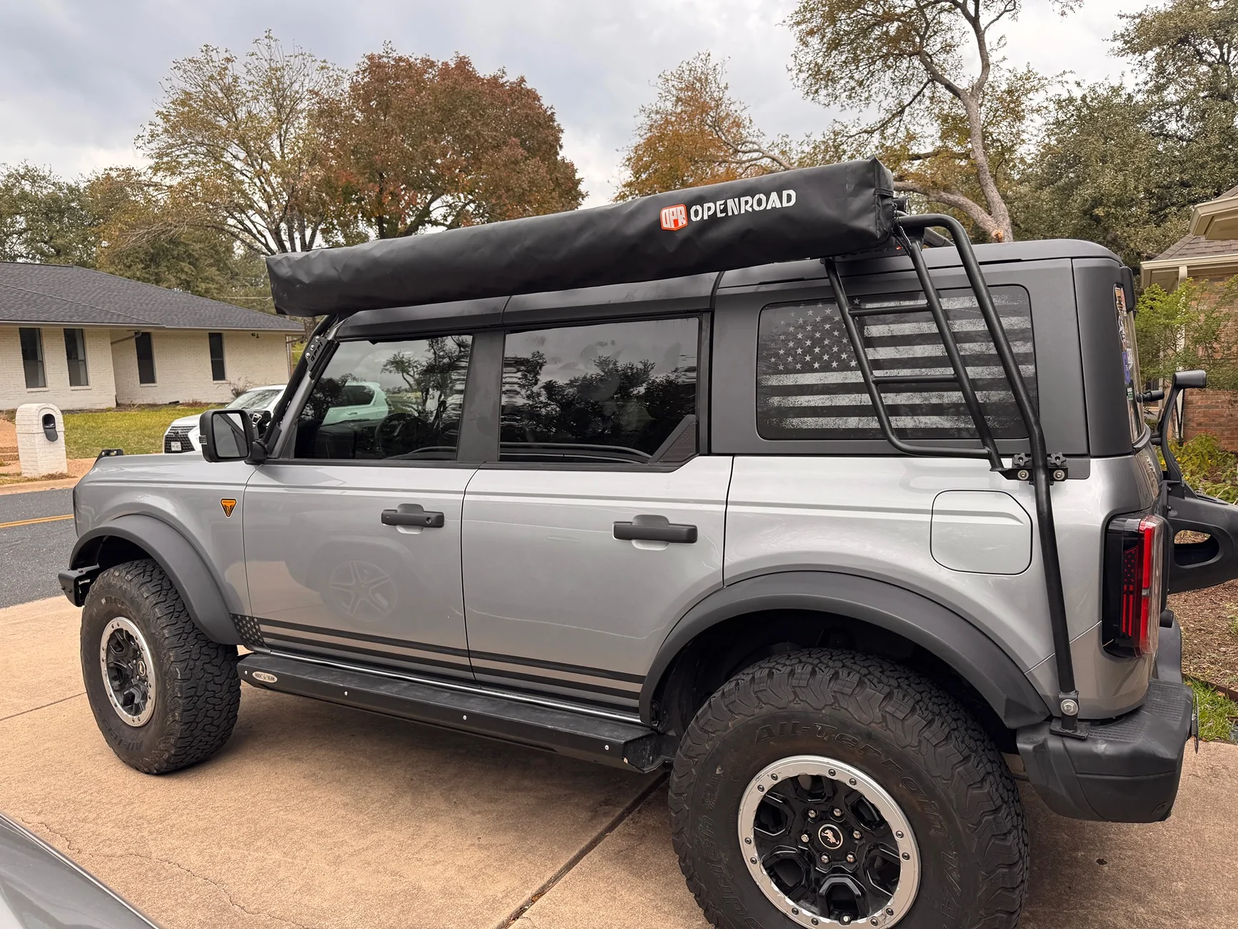

Ford Bronco 37 inch tire Question IMG_3702
DaddyO
Jules
Feb 5, 2025
359
226
Austin, Texas
2024 Bronco 4D 2.7L Sasquatch
I just switched from 35’s to 37’s on a Badlands with Sasquatch package. I did do a 2 1/2” lift just prior to that. No problems but for a daily driver FYI you’re going to lose any fuel economy you had. I went from 17-20 to 13-15 mpg and that’s on the road. If you’re not off-roading-why?
P.s. the awning was not installed correctly but now it is.

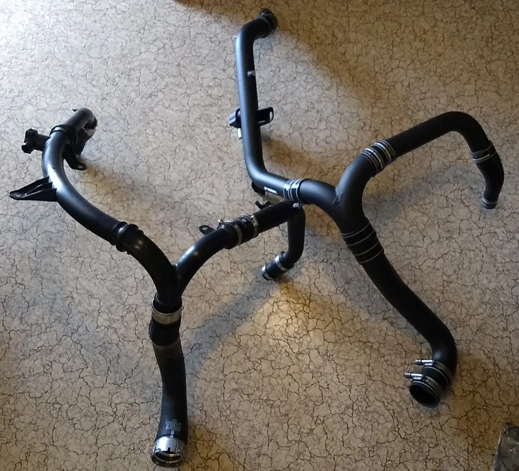

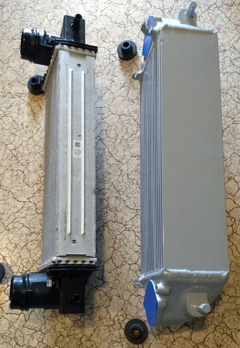

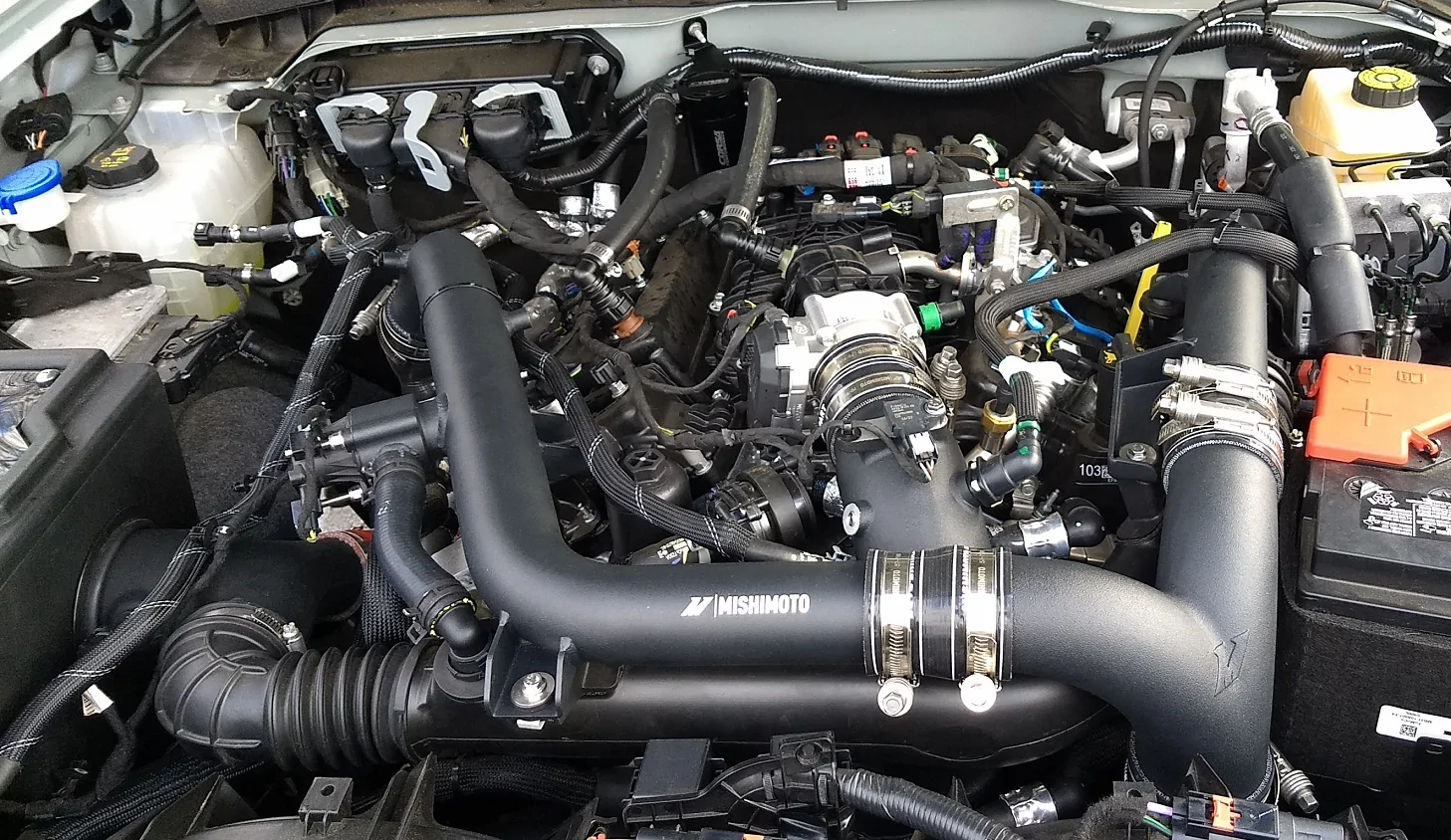

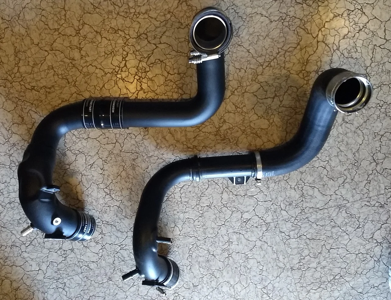

I went to 37's, did the FPP tune and added intercooler and charge pipes all around the same time. My mpg went up and I averaged 19 mpg during the warmer months (21+ mpg on longer trips). That will go back down during the cold months especially with the winter fuel. I already had the MBRP 3" Overland exhaust (with the muffler and resonator which keeps the overall sound level down).
Which intercooler and charge pipes did you go with?
