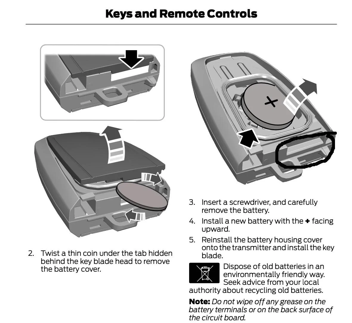

Pull out the metal key. Look next to the slot to pry open the fob to replace the battery. You'll see the part number in very tiny white print. You'll need a magnifying glass. The suffix is most important.

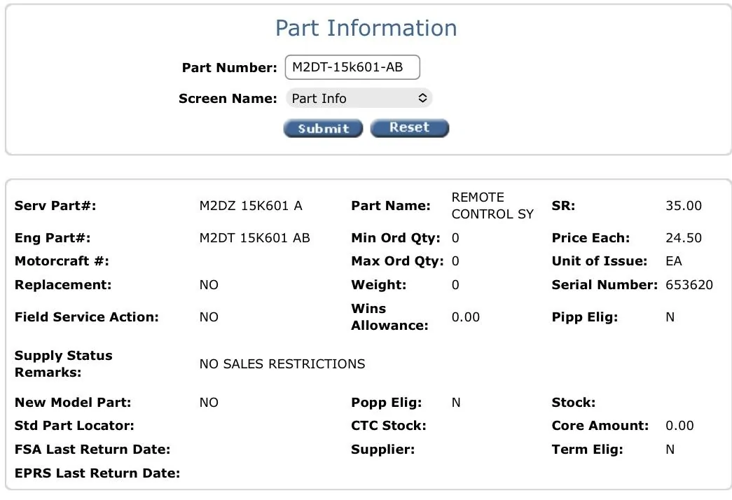

I was barely able to read the number, and the spare fob had a sticker on it with a larger print of the part number: M2DT-15k601-AB.
Alas, it doesn't show up, even without dashes. Perhaps it isn't available yet.
I found your key for $30 at another site, they also don't have mine: https://www.oemfordpartsdirect.com/oem-parts/ford-transmitter-m2dz15k601a

Don't worry about the final "B." All three of mine have M2DT-15k601AB printed on them. Even the one I just ordered. The invoice said M2DT-15k601A. Also every dealer website I've seen says M2DT-15k601A. Also the dashes don't seem to mean anything.

M2DT-15k601-AB is an engineering number
M2DZ-15K601-A is the corresponding service part number for it.
You need to order the service part number.
