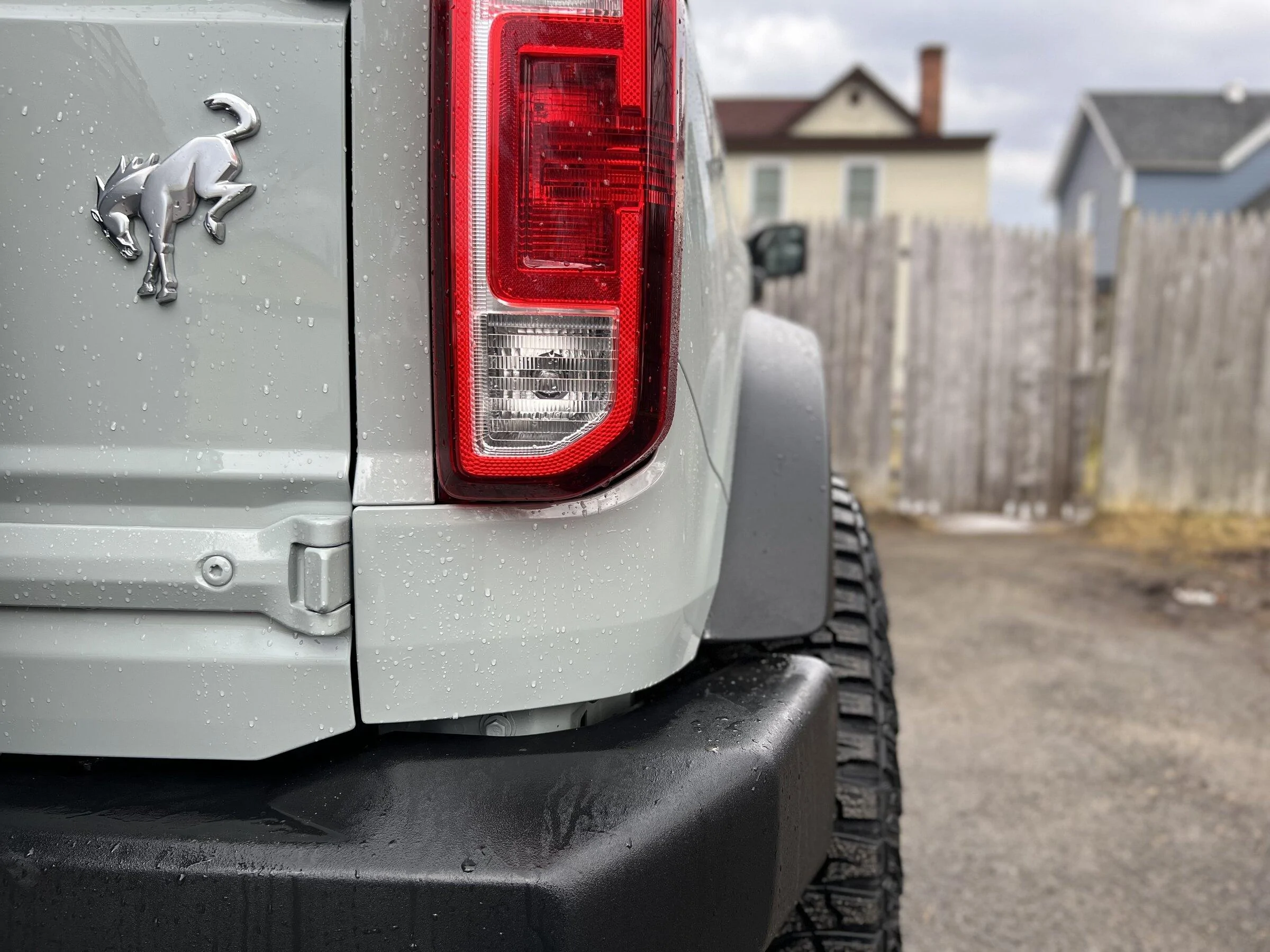

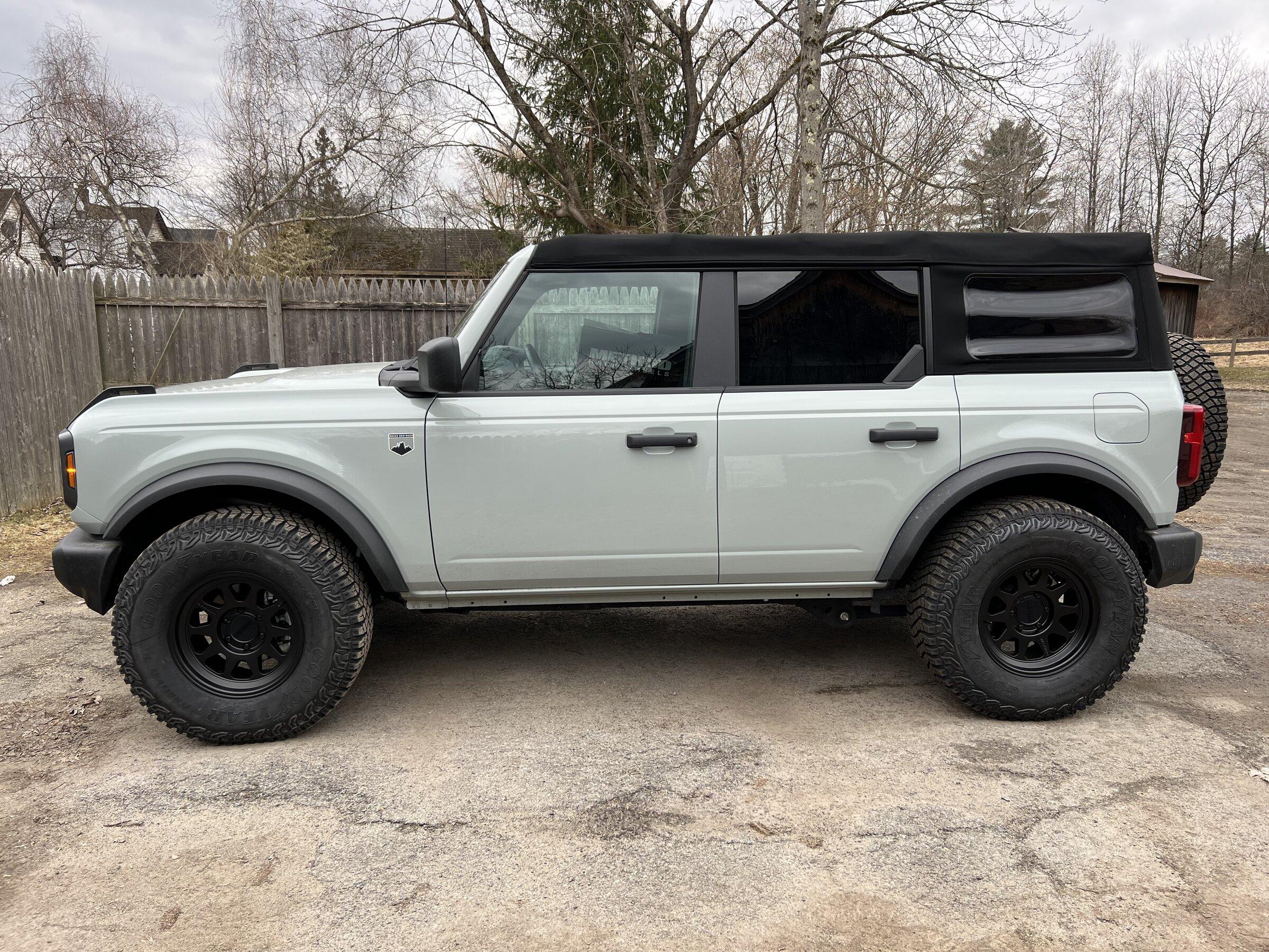

0 offset Method wheels , 315/70r17 good year wrangler territory tires, crash bar extension removed, no lift. Hope this is helpful if anyone is wondering if it can be done and how it would look with no additional lift on a cactus gray bronco big bend.

That does look awesome !

316’s Matte Black??

Yes I got them on amazon for 228 each wheel.
“ Method Race Wheels 316 Matte Black 17x8.5 6x5.5, 0mm Offset 4.75" Backspace”
The 35s on this rim even got on the back which was surprising to me coming from a wrangler. On the wrangler I had to use a relocation bracket to fit a 35 on the trunk. The bronco went on without a relocation bracket and looks perfect.

That looks fantastic. Get those front windows tinted and you'll be set.

How bad does it rub though?

Thank you, I was one of the curious ones, it looks great. You didn't have to add a leveling kit?

No leveling kit, just removed the crash bar extensions to make room for the larger tires (which the Sasquatch package also removes if you choose to go that route). This is a bone stock big bend, just new rims and 35’s

Very nice. (y) Be curious to see how it handles light trails.

Town and Country Ford did something similar although I don't recall if it was 35s or 37s or if they added some lift. T&C reported no rubbing until:
- They let Shelby Hall drive it in Buena Vista. It rubbed at higher speeds over rough terrain.
- T&C drove it up Mosquito Pass. At full articulation, the wheel tore the wheel well liner.
Point is, it may require more aggressive testing than speed bumps and curbs before you can be confident that there is no rubbing.

Non Squash correct?

Nice looks awesome!

This helps a lot. I am looking at the Method 305's with +25 offset and 295/70/17 tires. I want to keep tires from extending beyond the fender flares.
