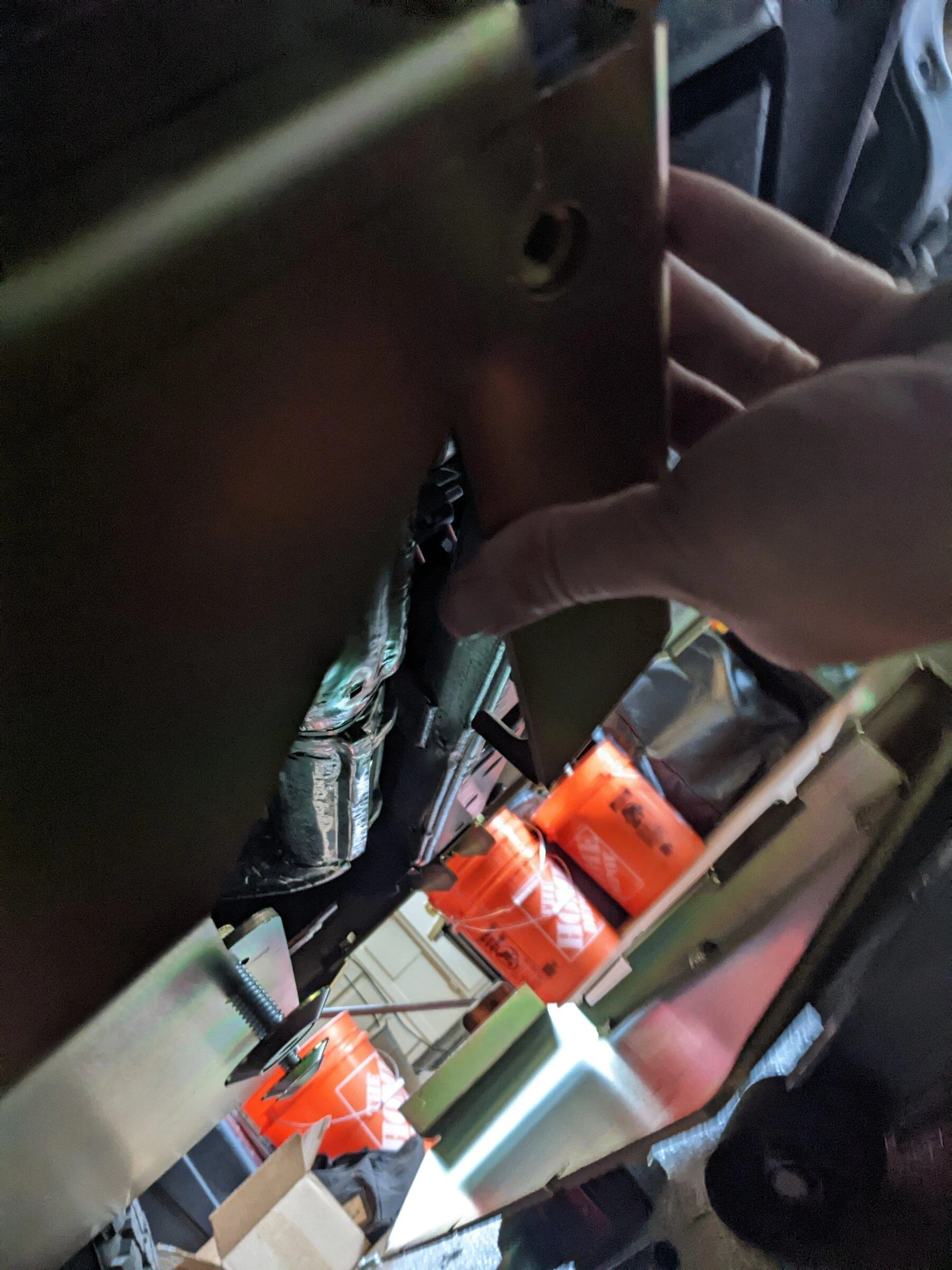

Started the install and I already new I was going to have issues. As bracket bolts to the V6 transmission protection and I have a 4 Banger.

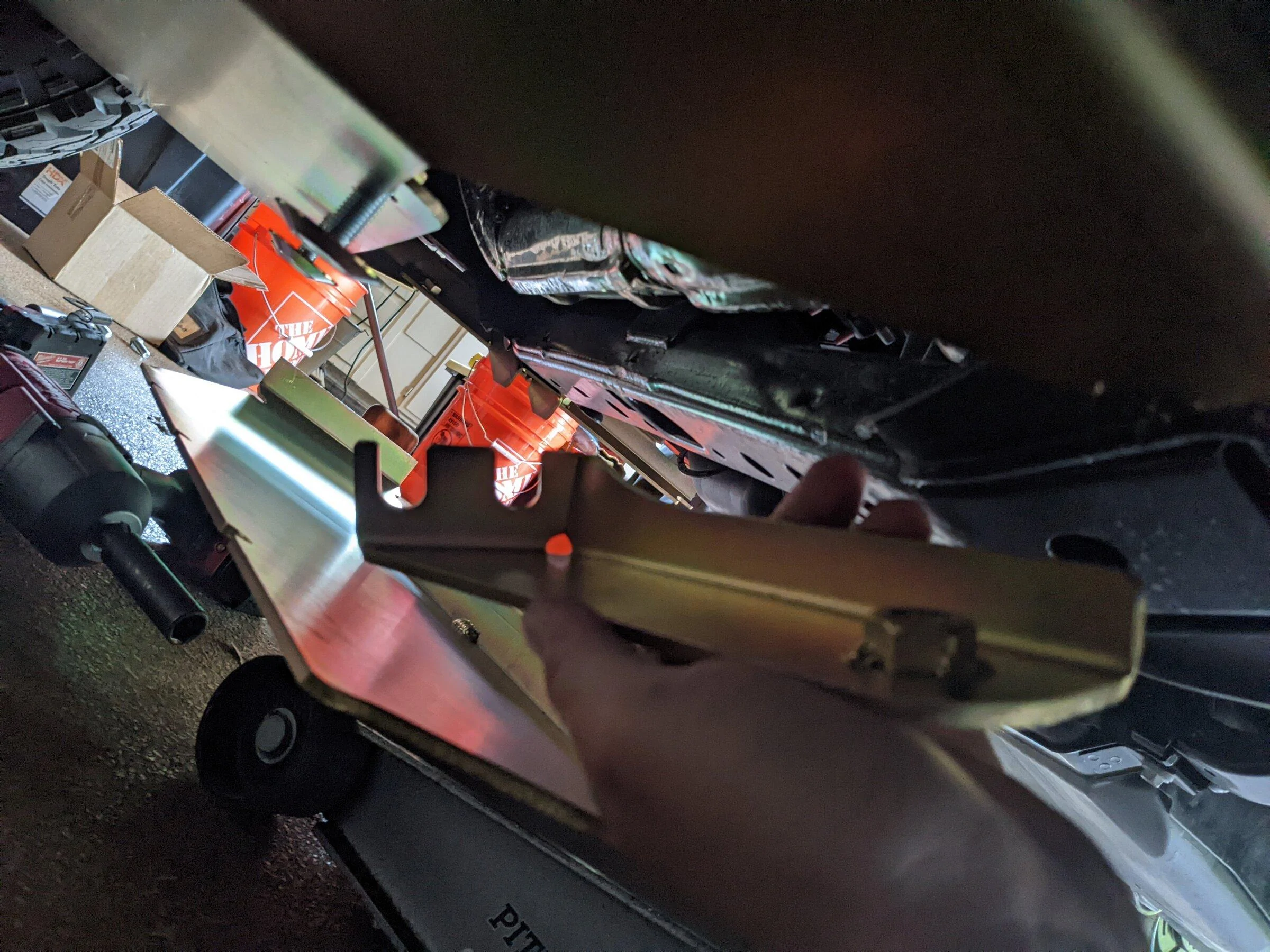

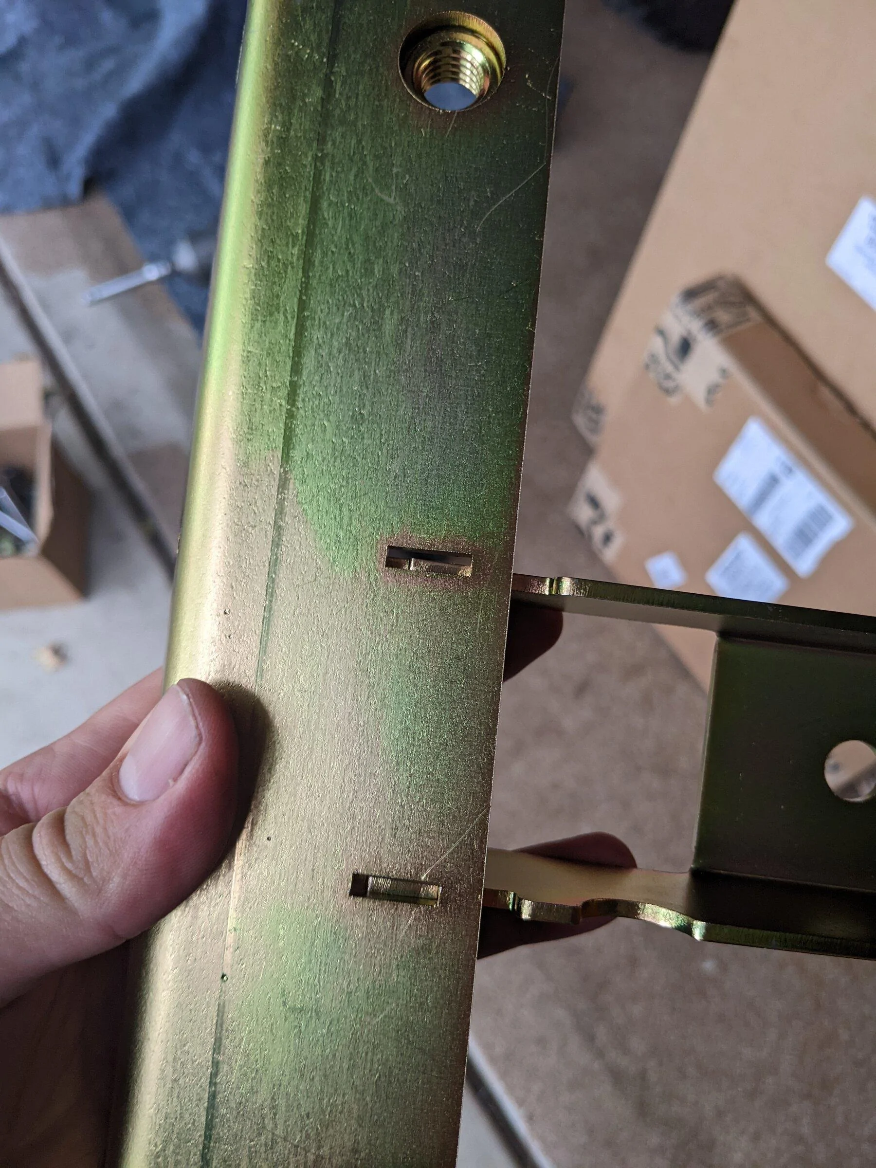

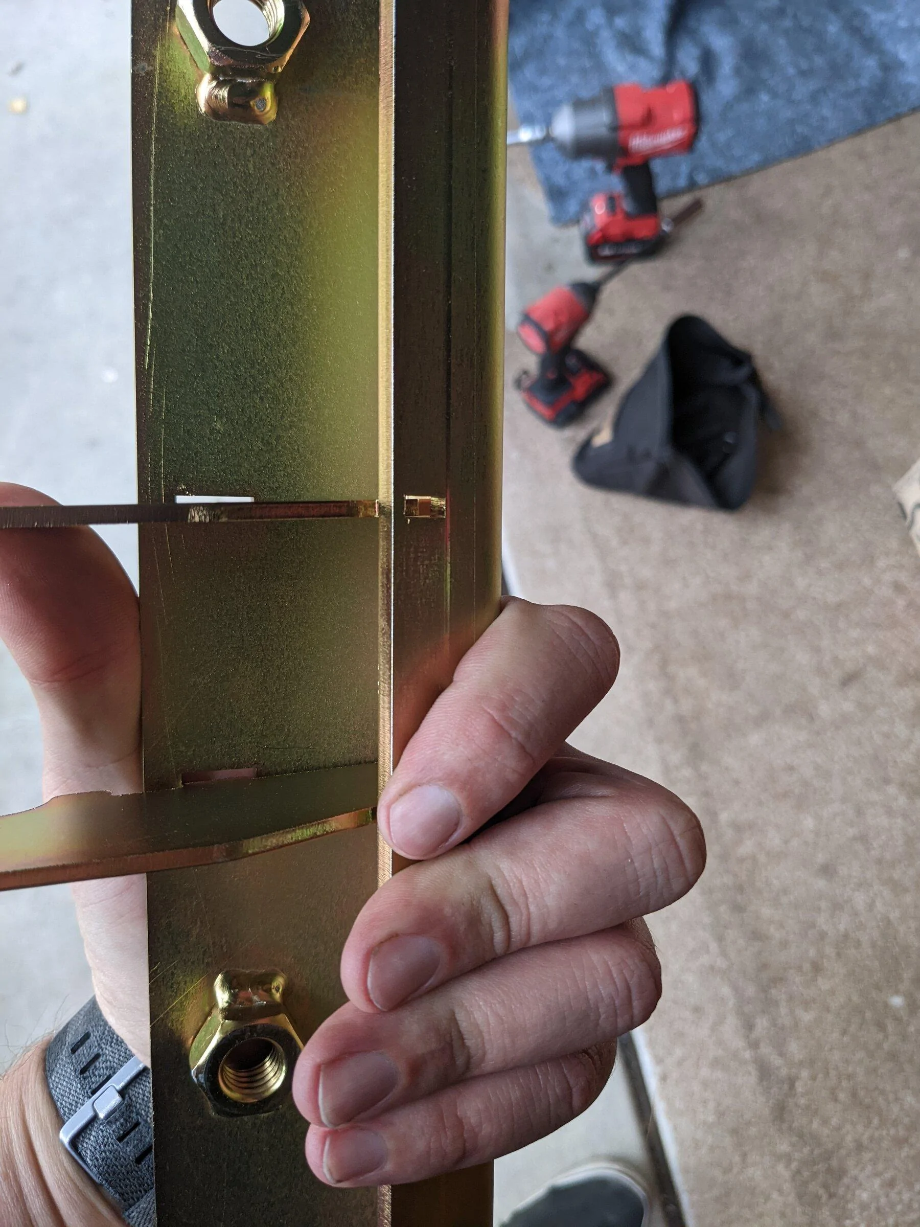

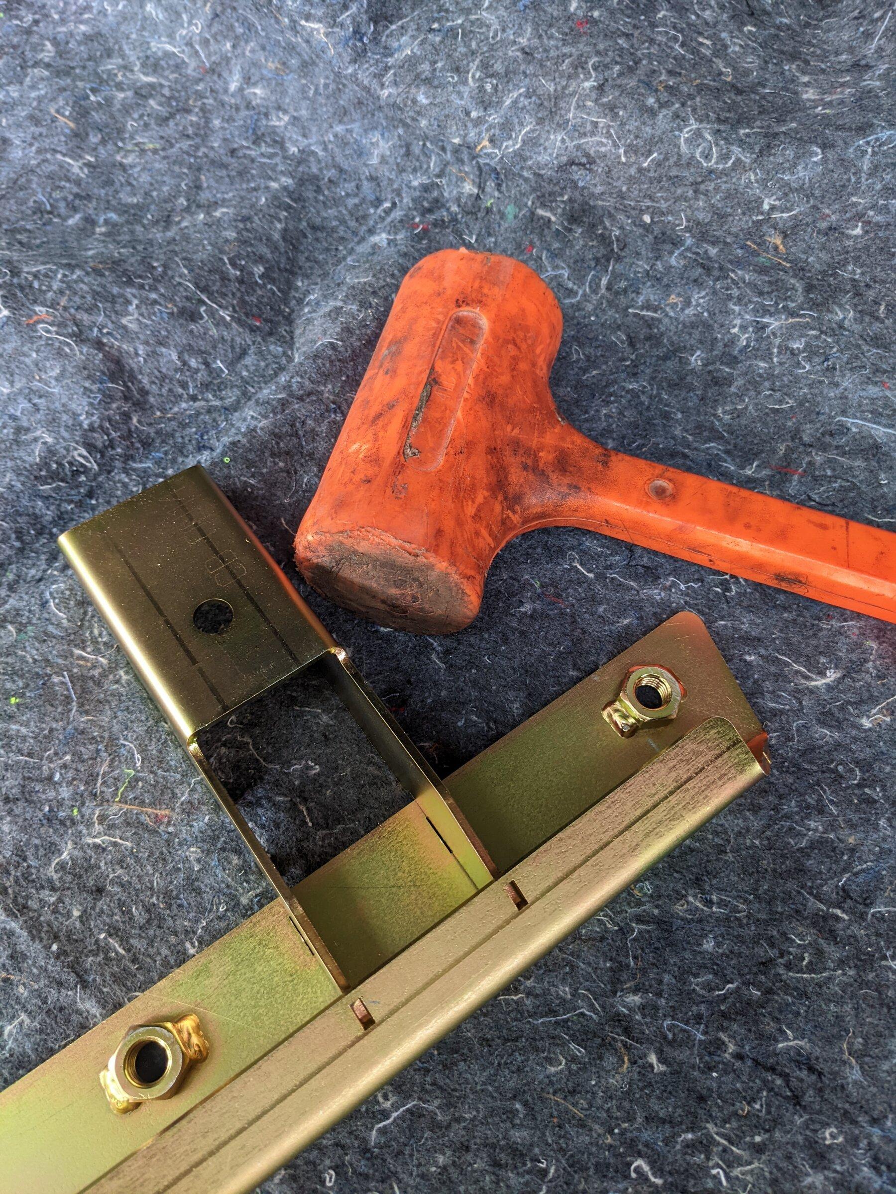

Next issue was this bracket. Should come welded in place, one hand to hold it and one to impact it on is a pain. Ohh it need a little tap tap to go together.

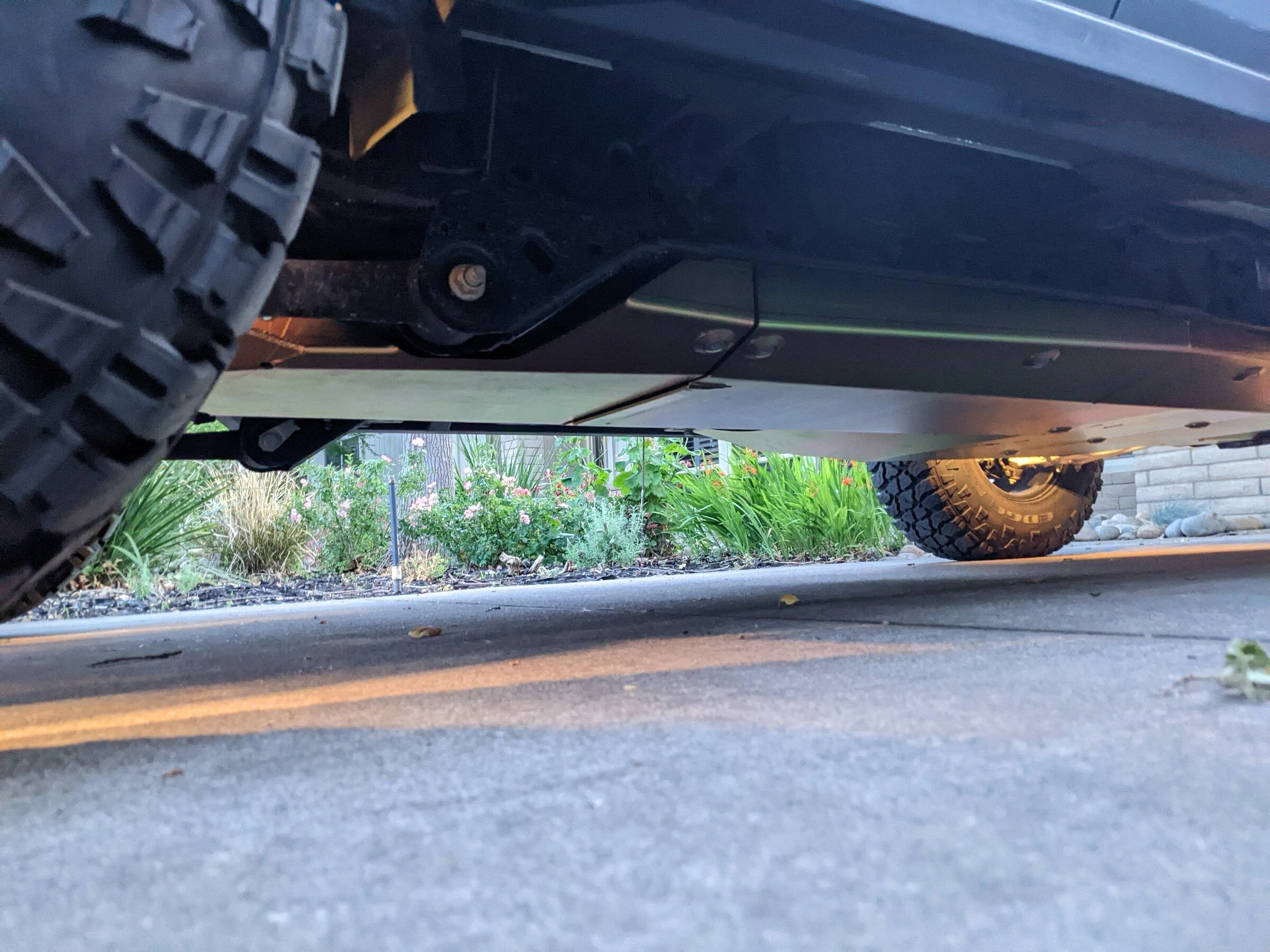

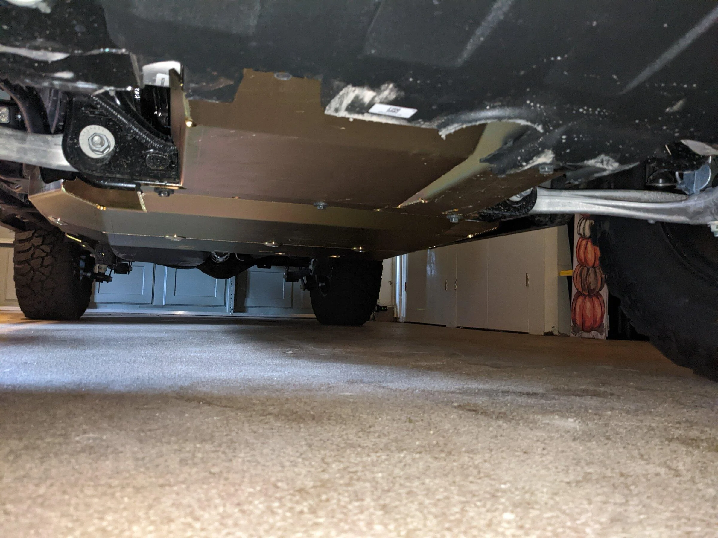

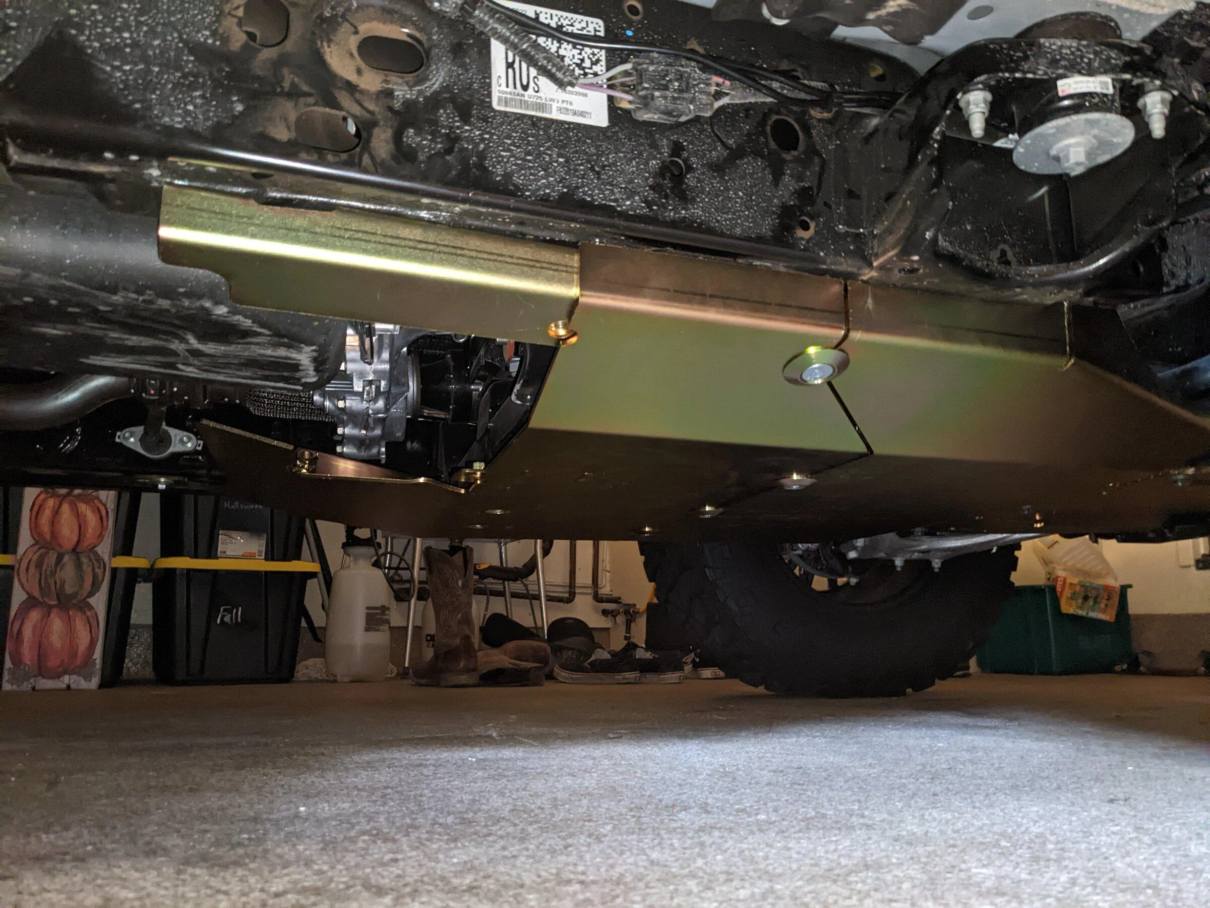

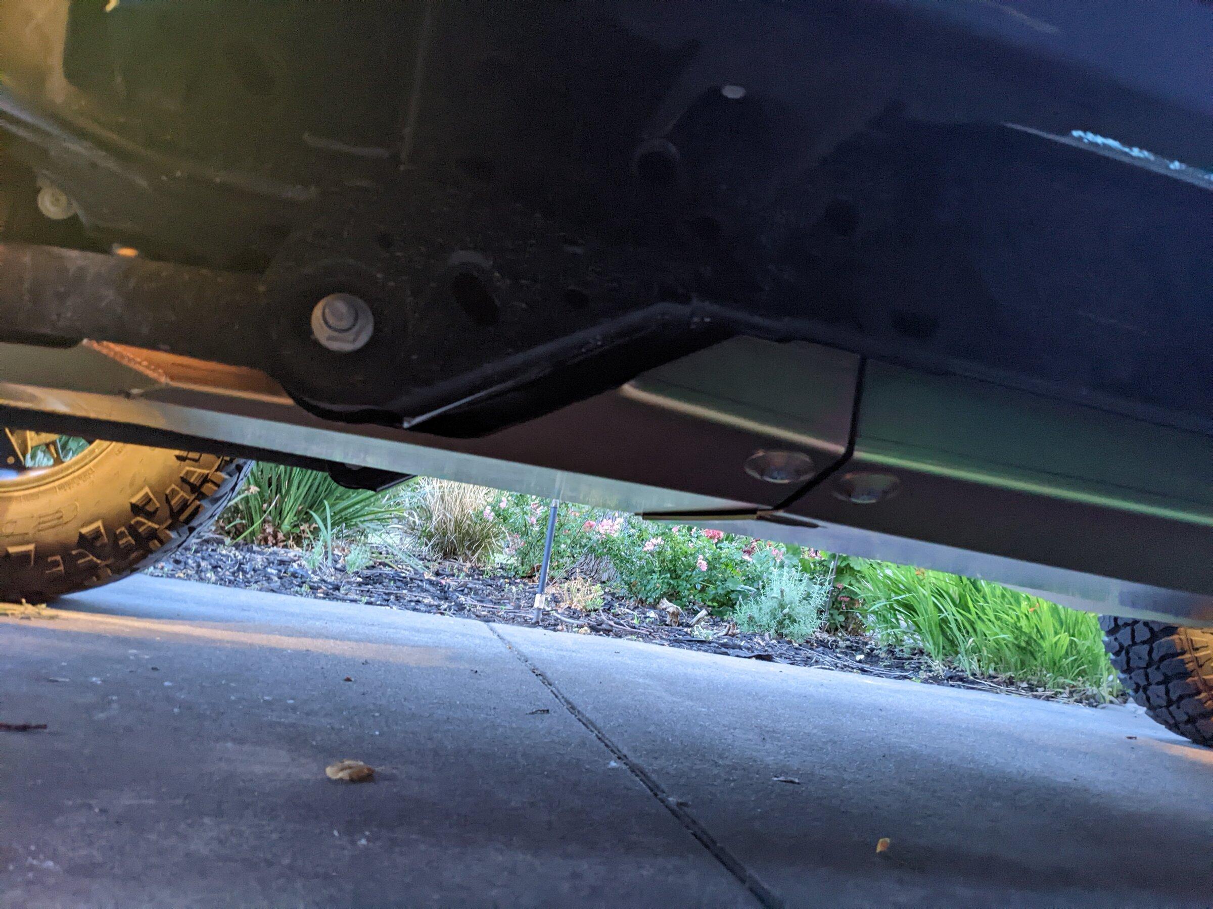

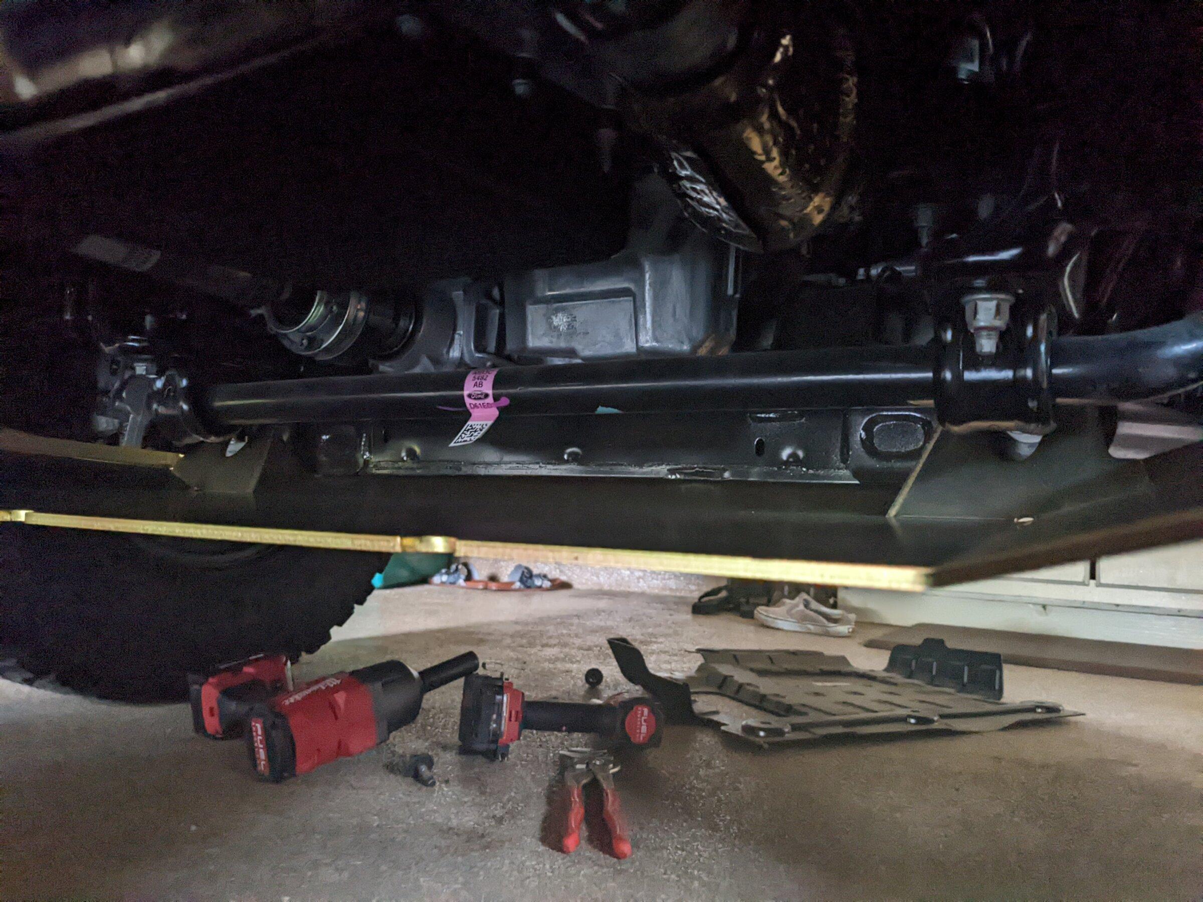

So 3 hours total and all done. Missing 2 bolts on the engine skid as Metalcloak needs 8 and my factory skid less bronco only had 6 from the factory. Also missing one more nut and bolt combo but I stole one from my spare bolt drawer.
I like the transition at the rear lower arm mount.

In your first post you mentioned that it’s made to fit to the 6 cyl , and you have a 4 cyl. How did u get around that?

One of the brackets is specifically designed to bolt to the V6 cross member support (those low hanging bars everyone complains about hitting). I used it as a giant nut till I figure out a way to mount it.

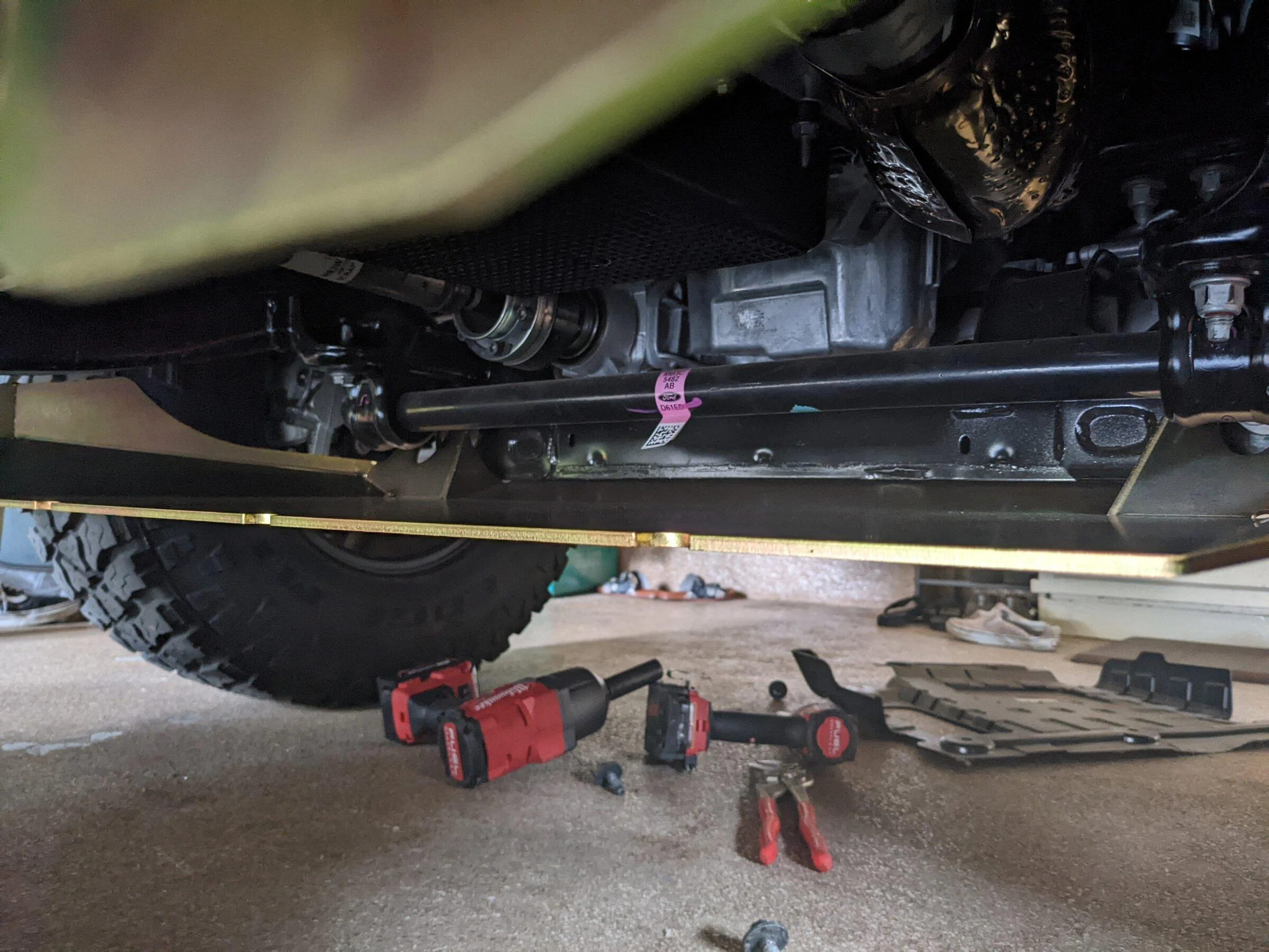

Yes, you will need to drop the skid plates to change the oil. 15mm socket and impact I had the factory plastic off and new differential skids on in a minute? No complaints on oil pan access after installing I'm not worried. I even had a filter and oil ready to go, but it ended up becoming a sticker paper weight.

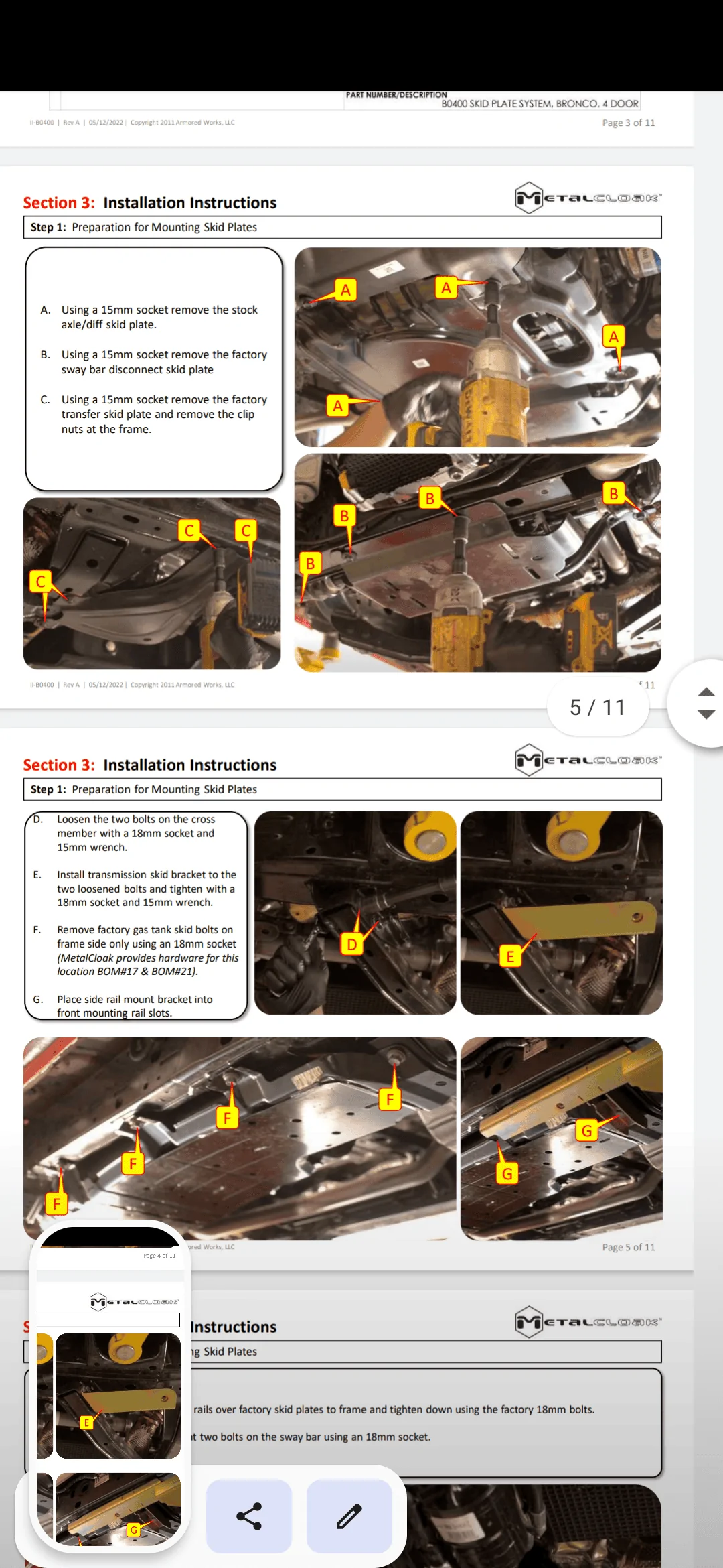

Best suggestion is lay it all out and figure out the bag of hardware.
I emailed them with some suggested changes to the instructions......
They need better pictures and pictures showing what hardware goes where. It's like a puzzle, you need to assemble everything like the diagram based off part numbers. I had to start over as I ended up with the wrong bolts.
