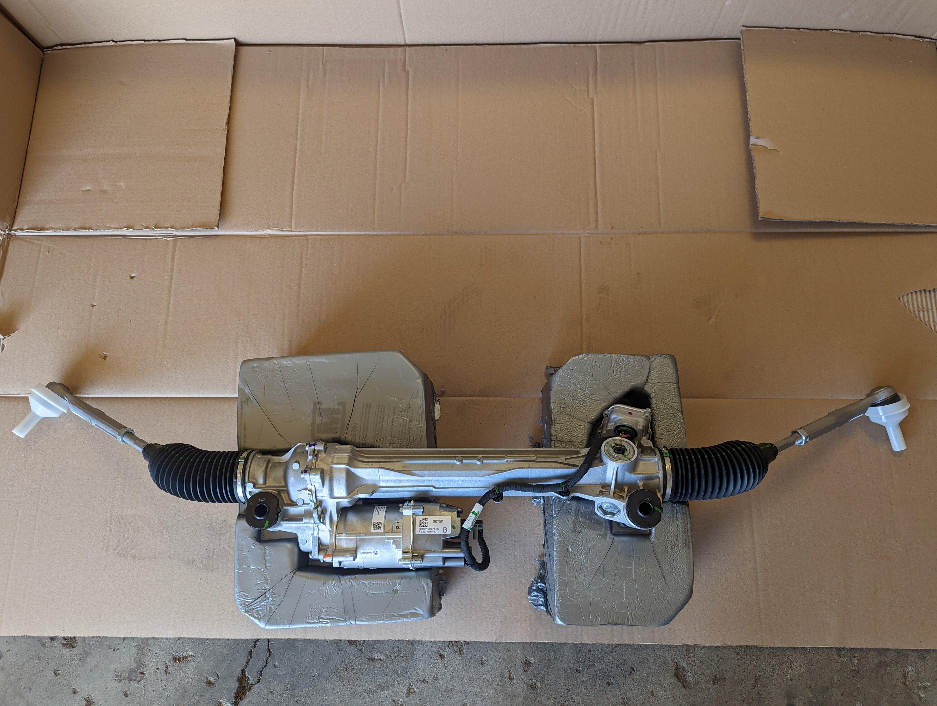

Well here it is folks it showed up and she sure is sexy in a beefy way!!!!
Ford wants $1700 to do the install but can't seem to get the programming or calibration for it🤔🤪🫣🫢🤭
Anyway I'll devise a solution very soon since Ford's programming team is slow and well just plain dumb. ( Maybe this is why some folks have not got their new WT yet....their built but the programming is way behind....)
I'll keep the community informed and up to date on this awesome upgrade as it progresses.

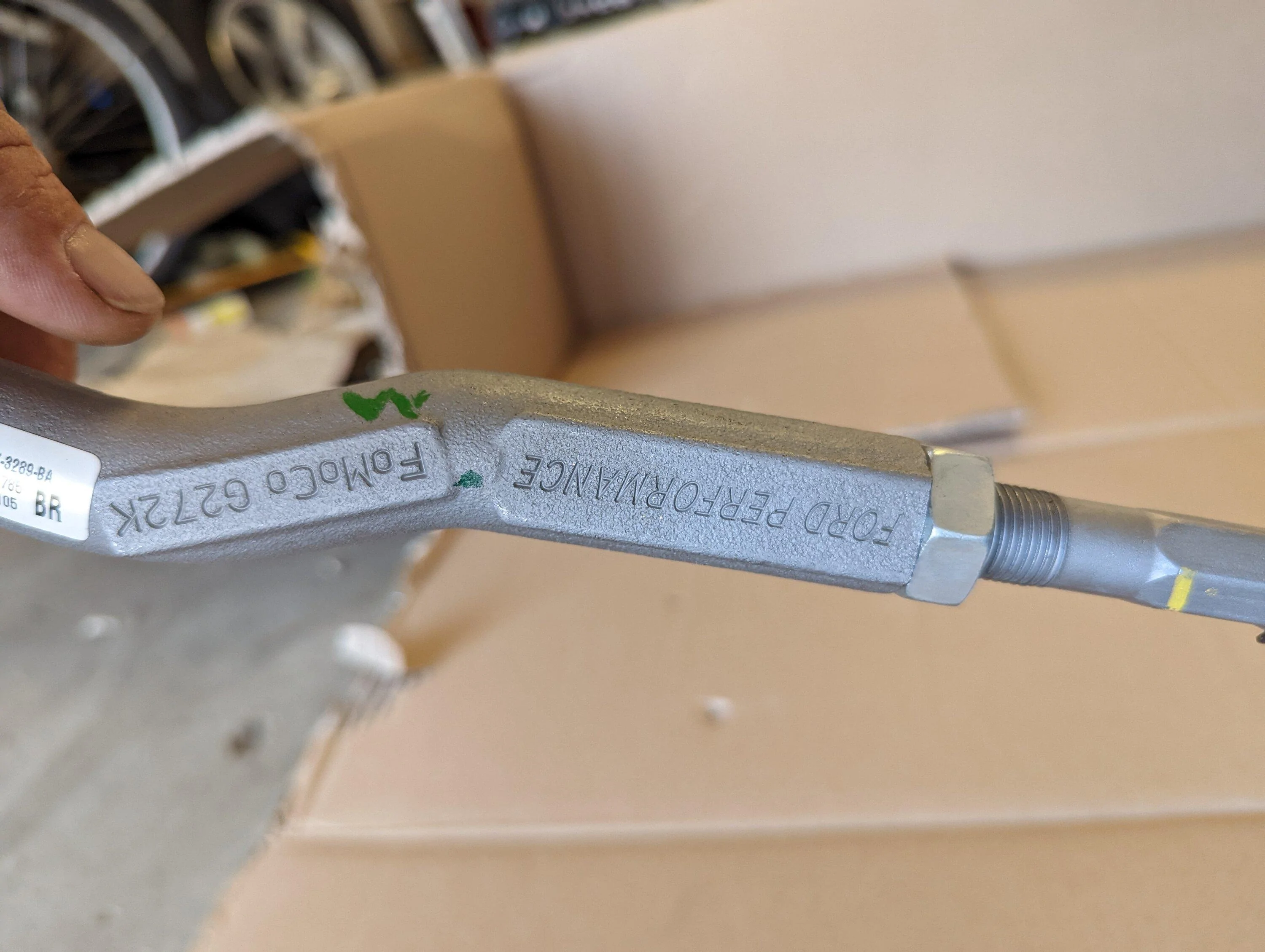

Update....Ford Performance has finally listed this part and the programming available on website....
https://performanceparts.ford.com/part/M-3200-WT
Ford Bronco Rack-Hack.  HOSS 3.0 severe duty STEERING RACK and TIE RODS ...Ford Performance M-3200-WT PXL_20220811_215551912

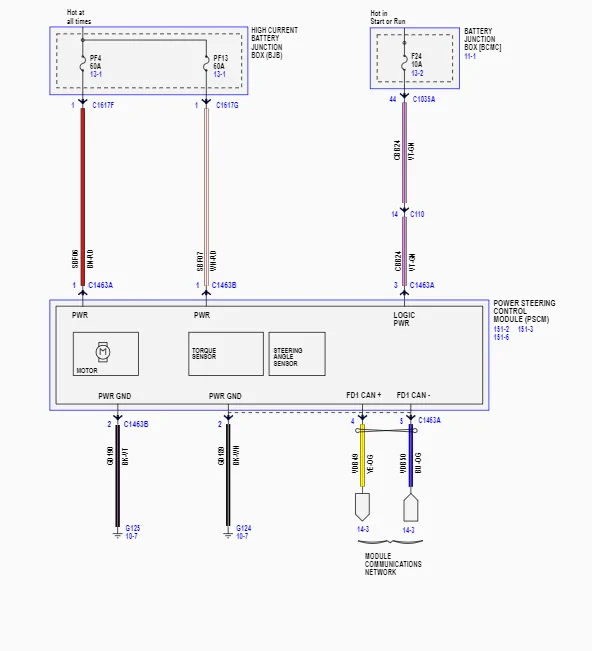

Updated with Hoss 3.0 steering rack wiring diagram from @flip
Ford Bronco Rack-Hack.  HOSS 3.0 severe duty STEERING RACK and TIE RODS ...Ford Performance M-3200-WT 1660321220997-png
Anyway I'll devise a solution very soon since Ford's programming team is slow and well just plain dumb. ( Maybe this is why some folks have got their new WT yet....their built but the programming is way behind....
Awesome. By chance what is the part number to order one?
