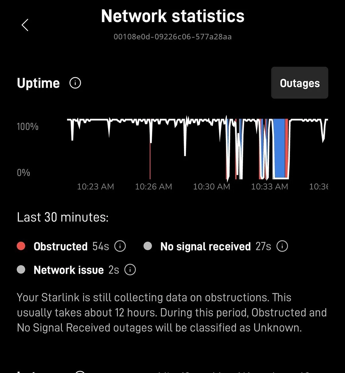

I just did a quick test on my way to the office. No more error about recalibrating orientation or no in-motion usage (so it is a software lock), just a warning saying orientation is off by x deg. I can use YT on my way.
Ford Bronco Update:Starlink Mini review (speed test & mounting options) , In motion supported! Screenshot_2024-07-11-10-25-28-814_com.starlink.mobile-edit
If you drive straight, the connectivity is ok. If you turn at the intersection or u-turn ( worst case ), it takes about a few seconds (~10s) to reconnect (showing offline, then searching on the app).
Now I am very happy with it. The next step is looking for an interior mounting solution!

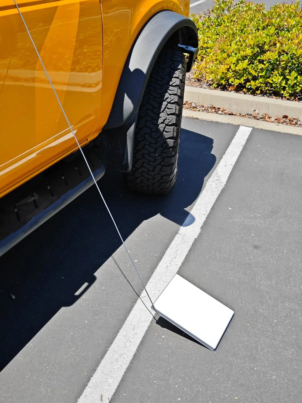

I conducted two scenarios: one in an open space and another inside a Bronco parked in a lot.
1. 1 Starlink mini placed on the ground with no obstructions.
Ford Bronco Update:Starlink Mini review (speed test & mounting options) , In motion supported! IMG_20240707_111933
Ford Bronco Update:Starlink Mini review (speed test & mounting options) , In motion supported! Screenshot_2024-07-07-11-20-05-382_com.starlink.mobil

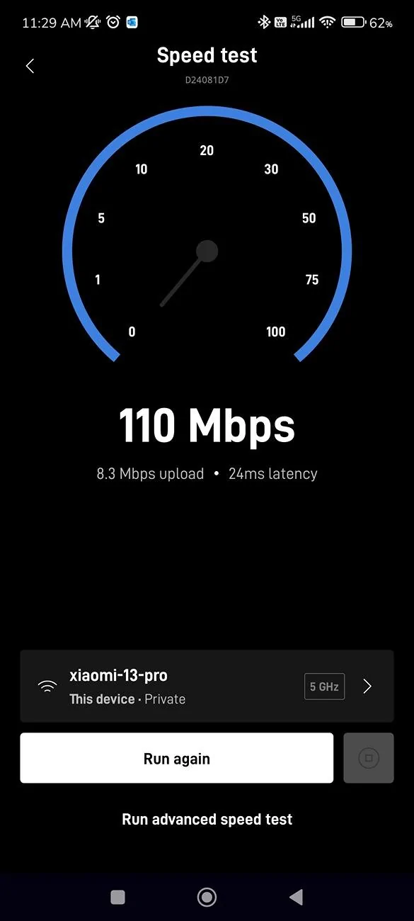

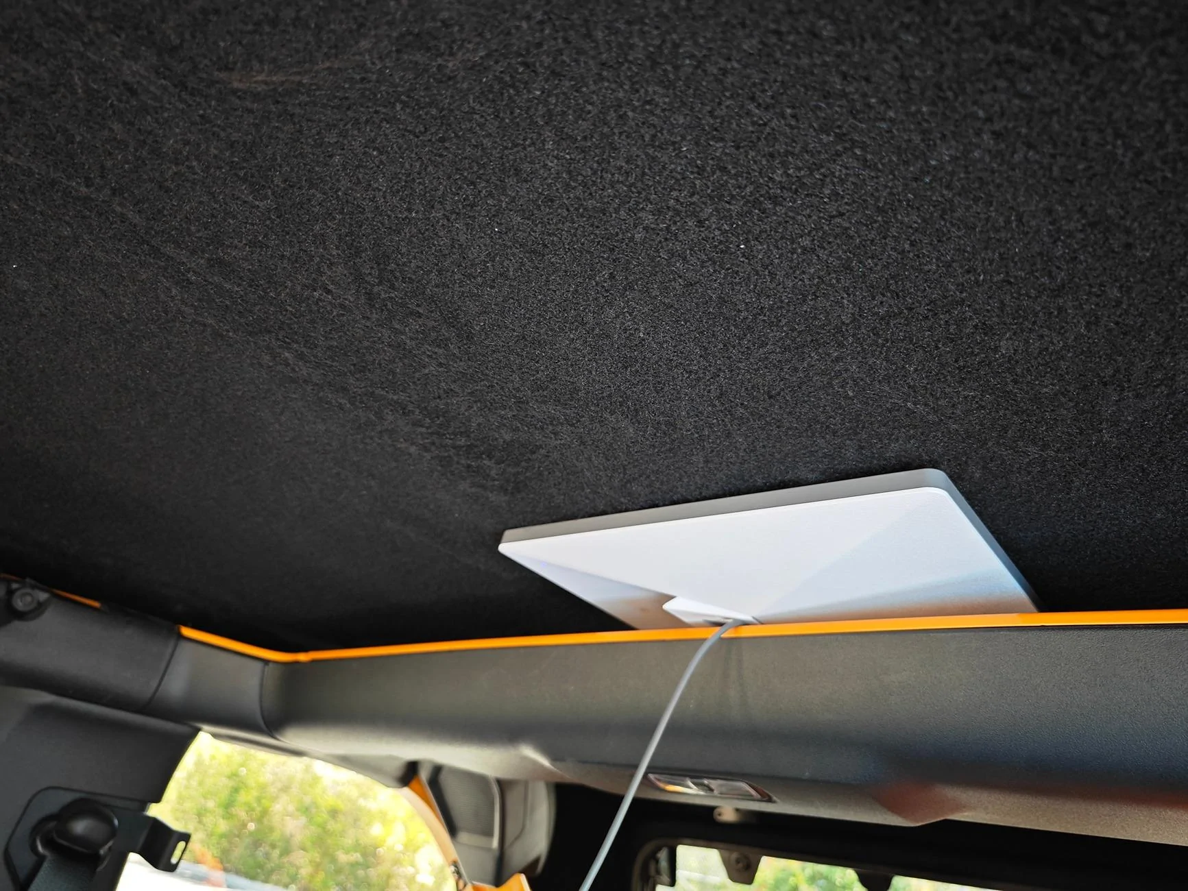

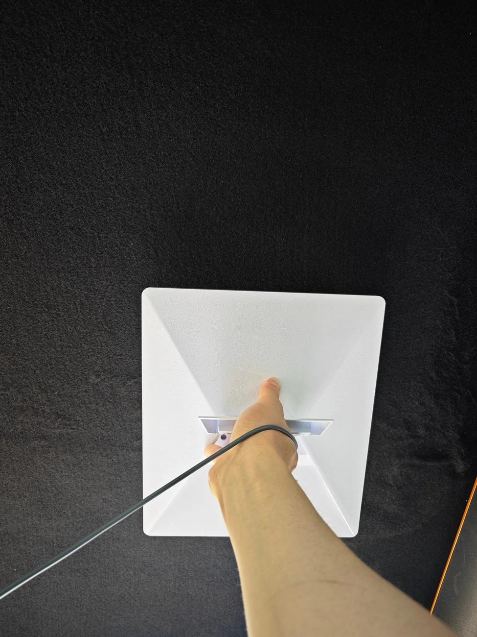

1.2 Hand hold close to the hardtop. (TOR top)
Ford Bronco Update:Starlink Mini review (speed test & mounting options) , In motion supported! IMG_20240707_112424
Ford Bronco Update:Starlink Mini review (speed test & mounting options) , In motion supported! Screenshot_2024-07-07-11-29-45-549_com.starlink.mobil
Speeds were slightly slower in the second test, likely due to calibration differences. Overall, the speeds were comparable.
I did a few more tests and the test result is consistent.

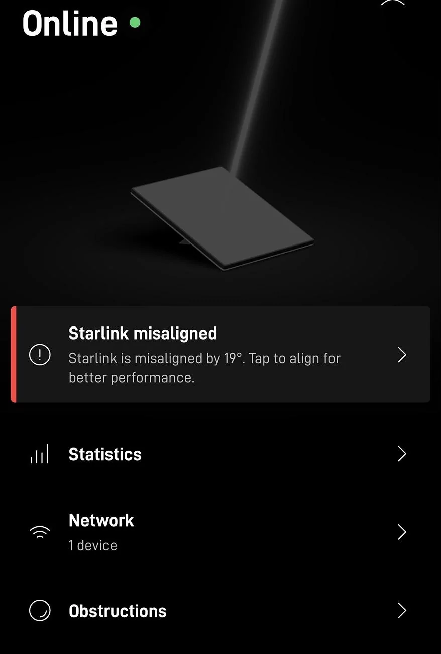

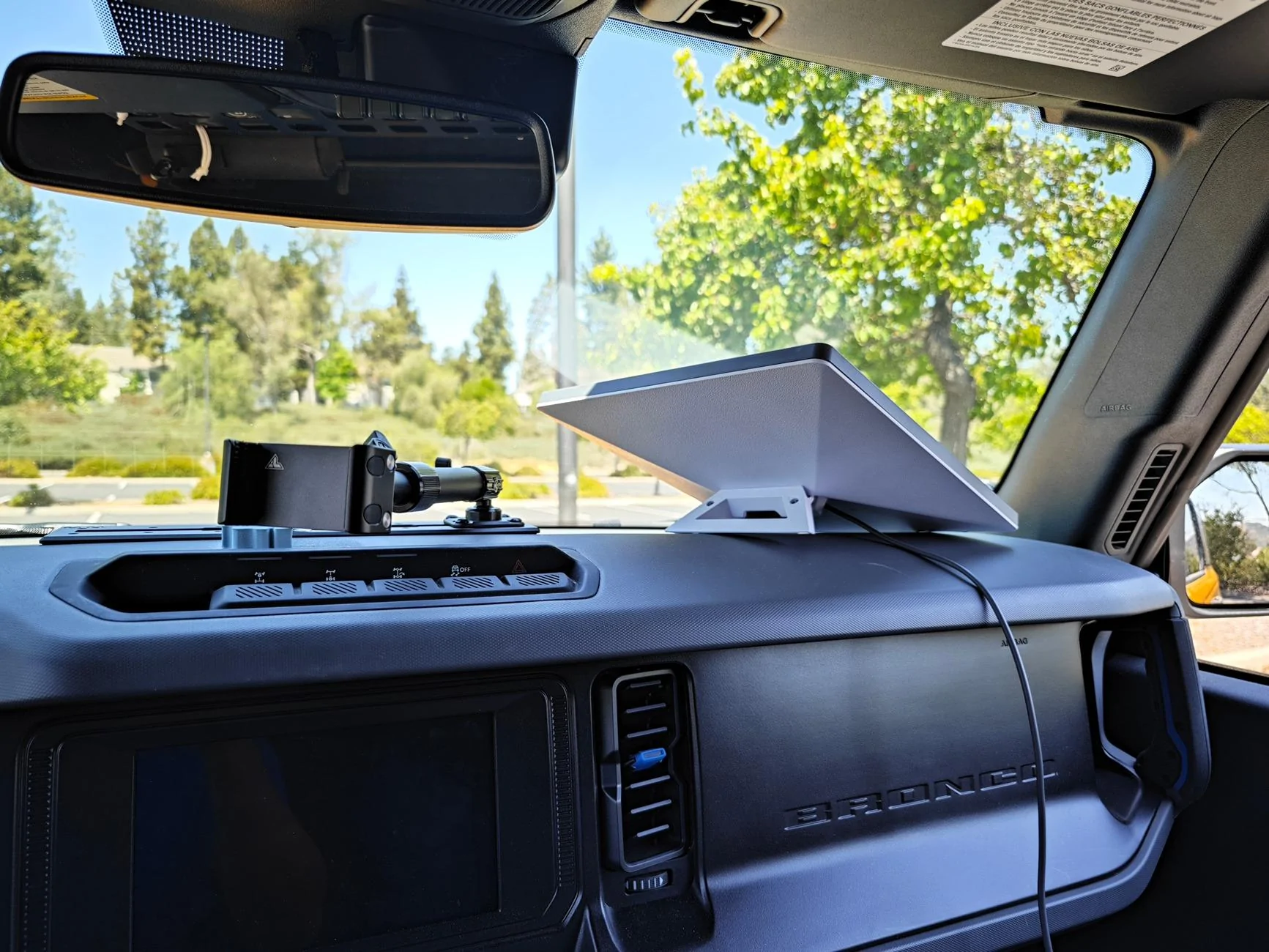

3. Alignment
However, using Starlink in motion seems impossible. The device requires specific orientation alignment (facing north with a certain tilt range) upon startup, making a fixed interior mount impractical unless the vehicle can consistently face north when parked. And to maintain connection, it has to be in the same orientation.
To test this, I placed the Mini on the dashboard and drove around the parking lot, experiencing multiple disconnections.
Ford Bronco Update:Starlink Mini review (speed test & mounting options) , In motion supported! IMG_20240707_114245
Ford Bronco Update:Starlink Mini review (speed test & mounting options) , In motion supported! IMG_20240707_111618
I'm aware that Starlink offers a mobility priority plan and high-performance hardware for true mobile usage (e.g., in vehicles or boats). However, there are mentions of standard hardware with a roaming plan supporting similar usage. If you're familiar with workarounds, let me know.

I don't think the StarLink Mini is deisgned to be used in-motion, stationary only, so if you're getting any sort of connectivity thay way, that's good news.

Yeah, right now it is more for the camping. Pick a site & set up the starlink.
I am just curious about why it cannot do it. I understand that speed is limited by Doppler estimation/compensation during high-speed cruising. I personally would rather trade speed for connectivity. :)

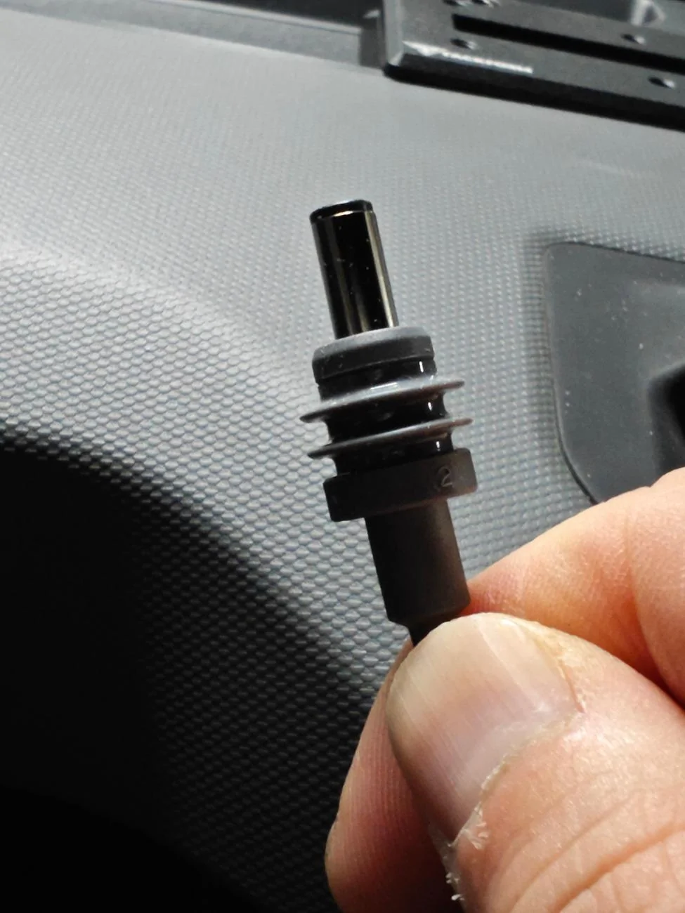

I use its own AC plug, but I think a DC input is doable if you don't need waterproof.
Ford Bronco Update:Starlink Mini review (speed test & mounting options) , In motion supported! IMG_20240708_110354
See above pic, the rubber ring is designed for outdoor weatherproof. Other than that, it is just a DC port.
The voltage input range is 12-48V if I remember correctly, so a DC lighter adaptor works.

Nice. Big ask, but see if you can get a voltmeter on that thing and see what the adapter is putting out. Would be curious to see how I can get one powered

ac plug is rated as 30V output (again, if I remember correctly). I think it is designed to reduced the current given it is a long cable😂
