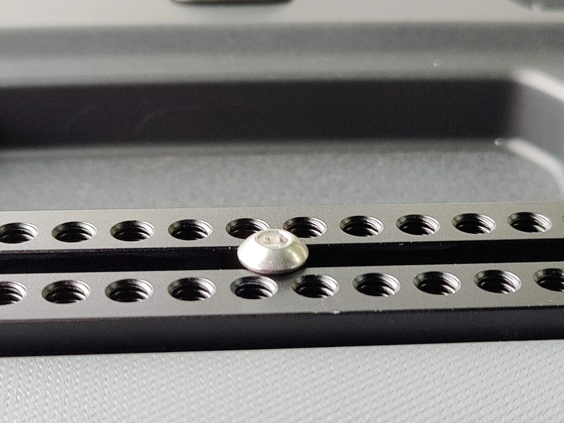

Being a photographer I am immersed in the world of all things "camera". And in the photography world, there are many who also shoot video with their cameras. Those who do often use what we call a shark cage to protect their gear, but also allow the addition of accessories. Things like monitors, mics, handles, and more.
Among this world of shark cage options are several addon plates that I thought may work for an affordable BYOD system.
Today my first BYOD piece arrived. It is an accessory plate for shark cages from a company called Camvate (link: https://amzn.to/3p6J7a0 ) and it is approx. 6.1" long by 1.3" wide. It has a center slot for adjusting its lateral position on your mount, and a series of 1/4-20 threaded holes along each side of that slot. It comes with (2) button head 1/4-20 bolts to secure it to the dash mount and a pair of extra 1/4-20 bolts for whatever.

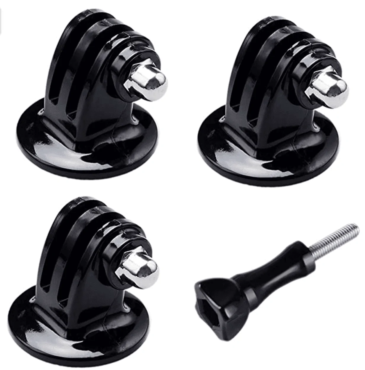

I'll be mounting my GoPro using a basic GoPro tripod mount (link: https://amzn.to/3vdRPnY )

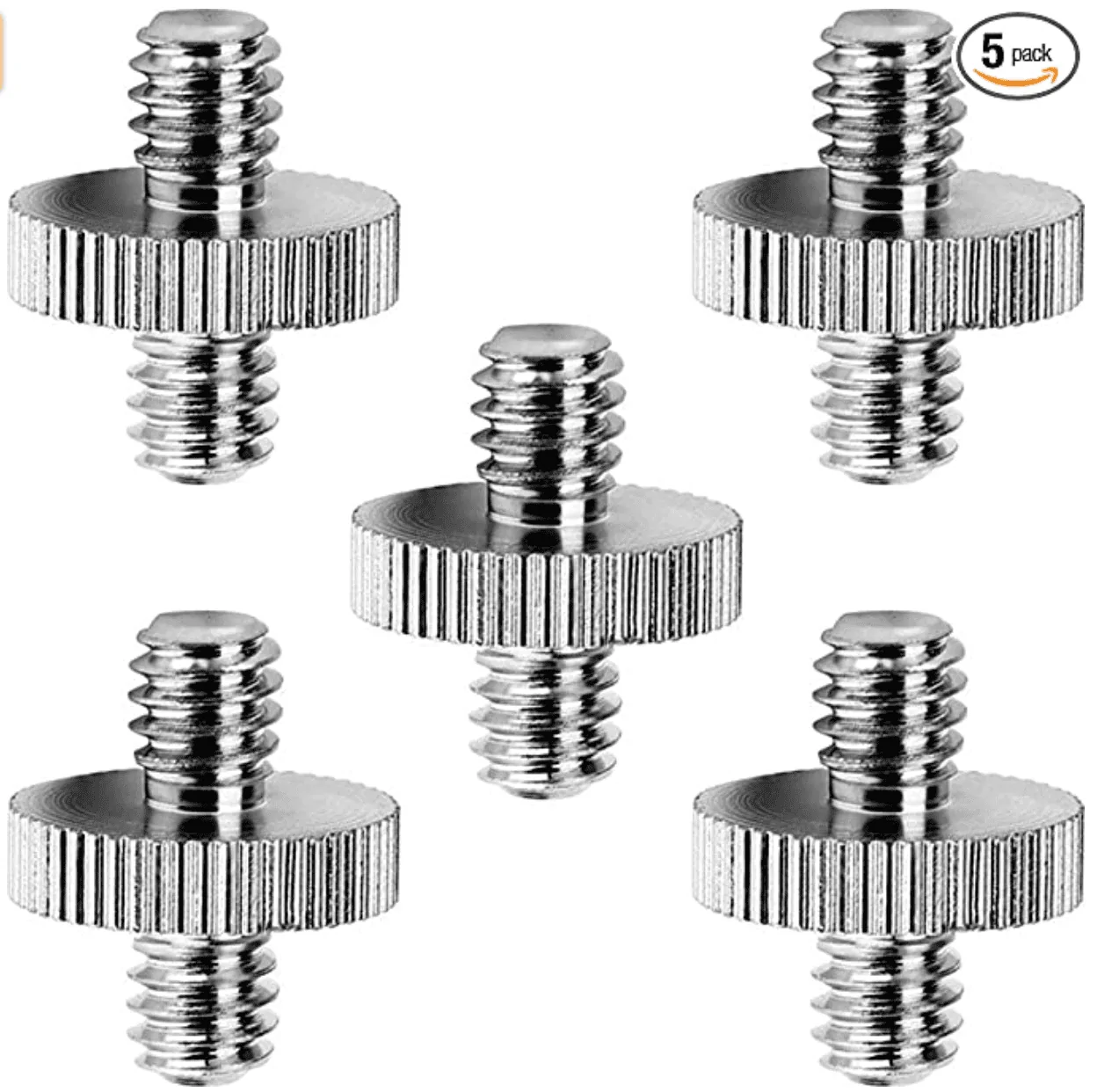

and these (link: https://amzn.to/3FPKlww ) male-to-male 1/4-20 adapters.

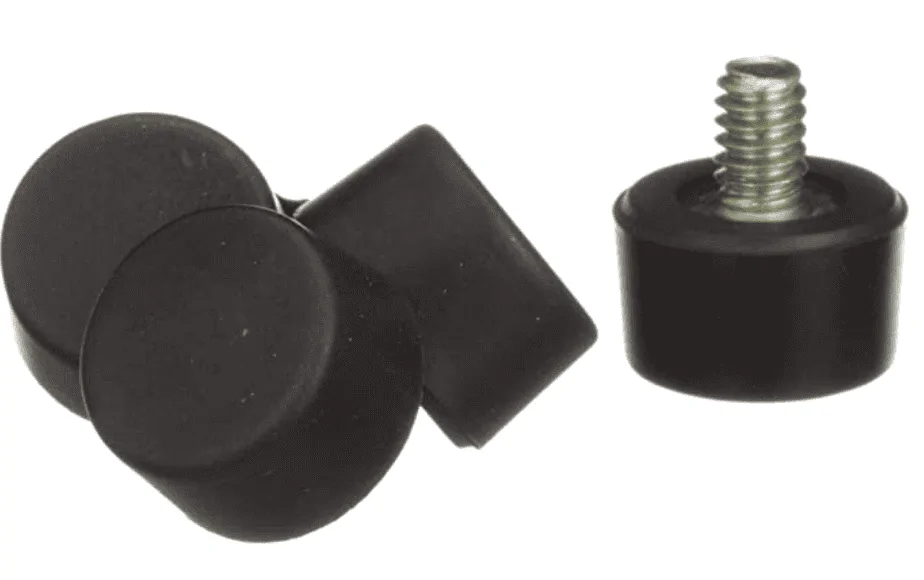

I also ordered some rubber bumper feet (Link: https://amzn.to/3aDjhlI ) in case I think it may need some vibration dampening, but so far this thing is rigid!

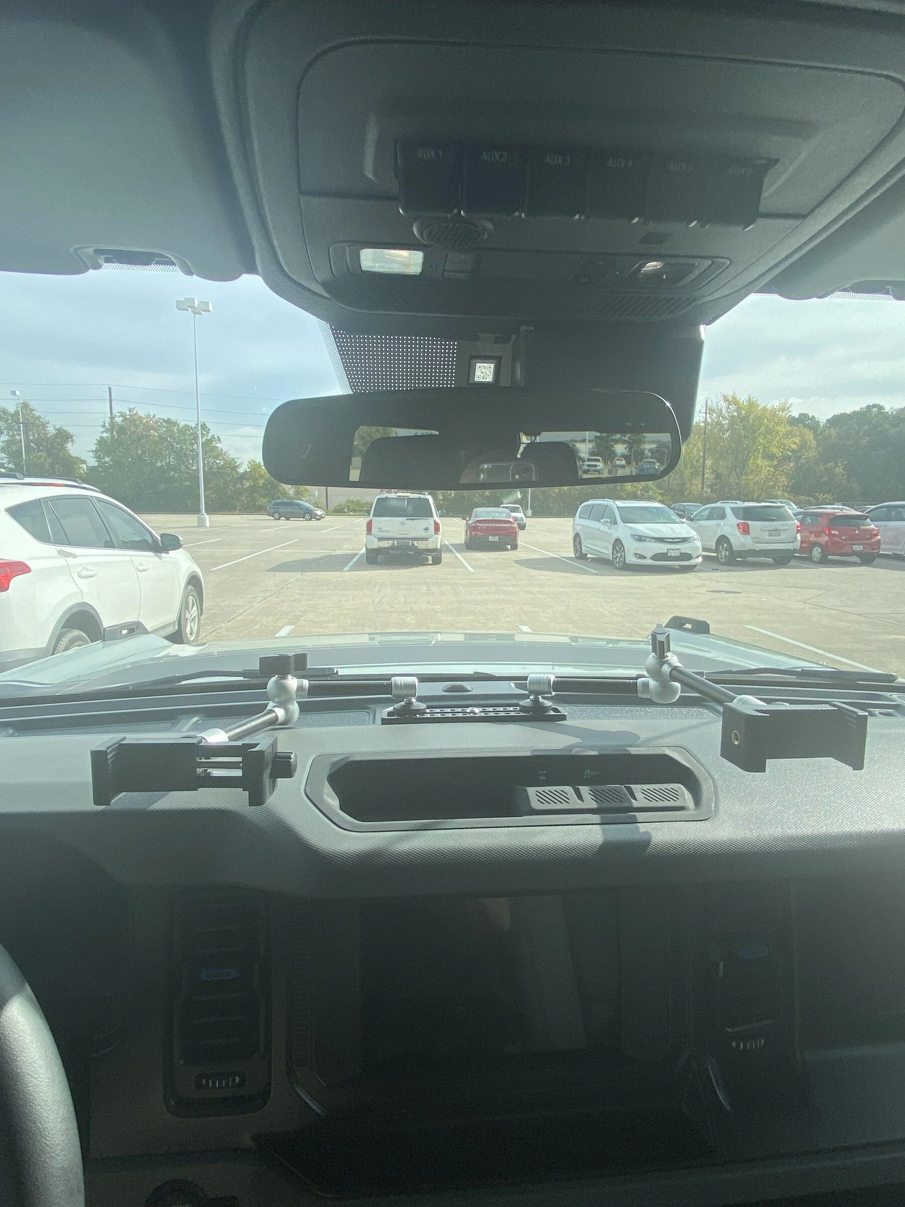

Thanks to OP i installed this as soon as my Bronco arrived.
MacDonald_Photo
MacDonald_Photo
Jamie
Jul 17, 2020
67
772
2,977
Eaton Rapids, Michigan
2021 Badlands

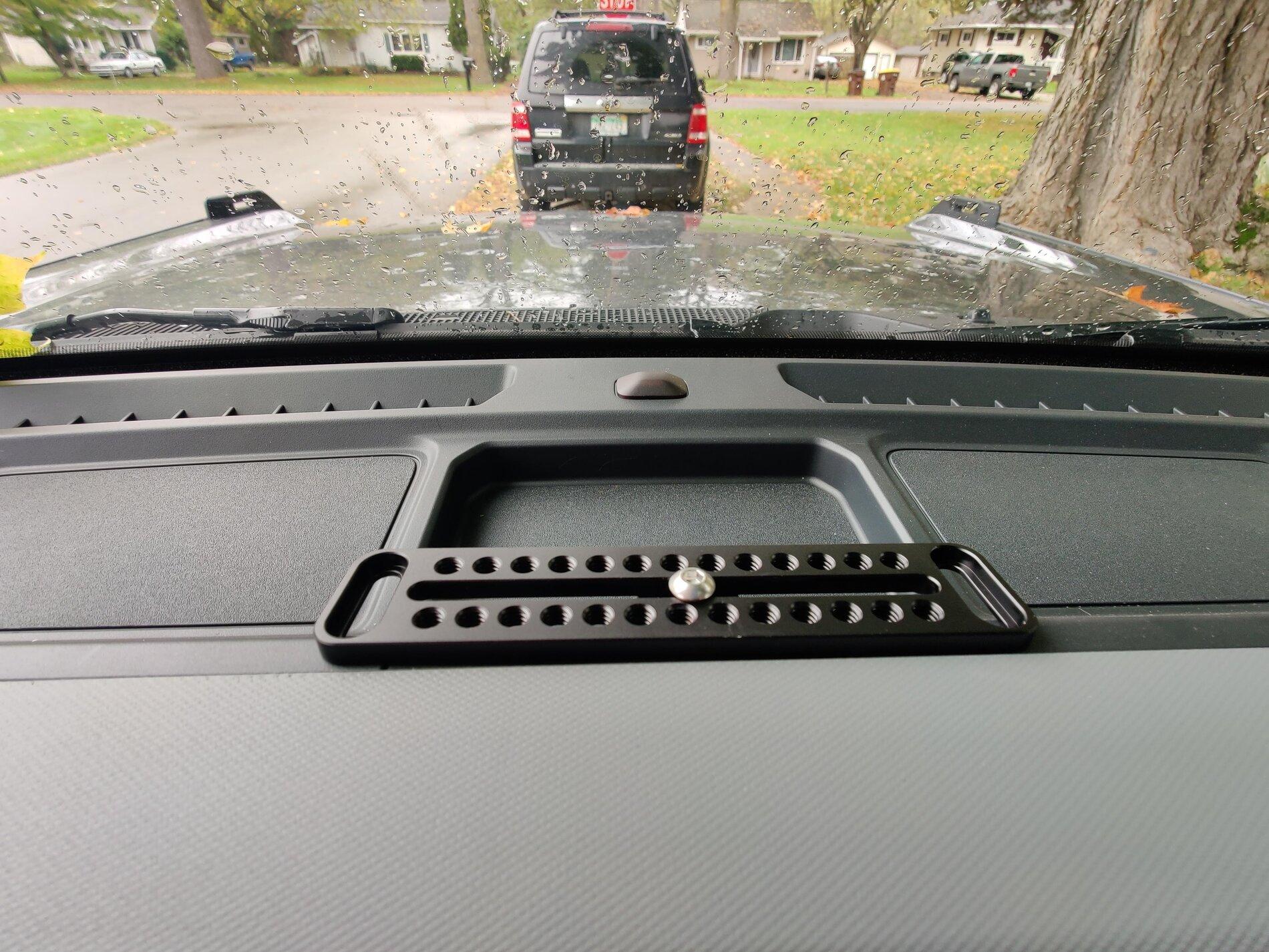

Ford Bronco My Mini-BYOD 12B2A3C0-F4FA-467F-8CB2-18ED3776B764
Heck yeah!!!
Let me know how you like it.
I figured for me, I didn't need a rail ALL THE WAY across my dash...Looks like you didn't either.
Happy trails boss!

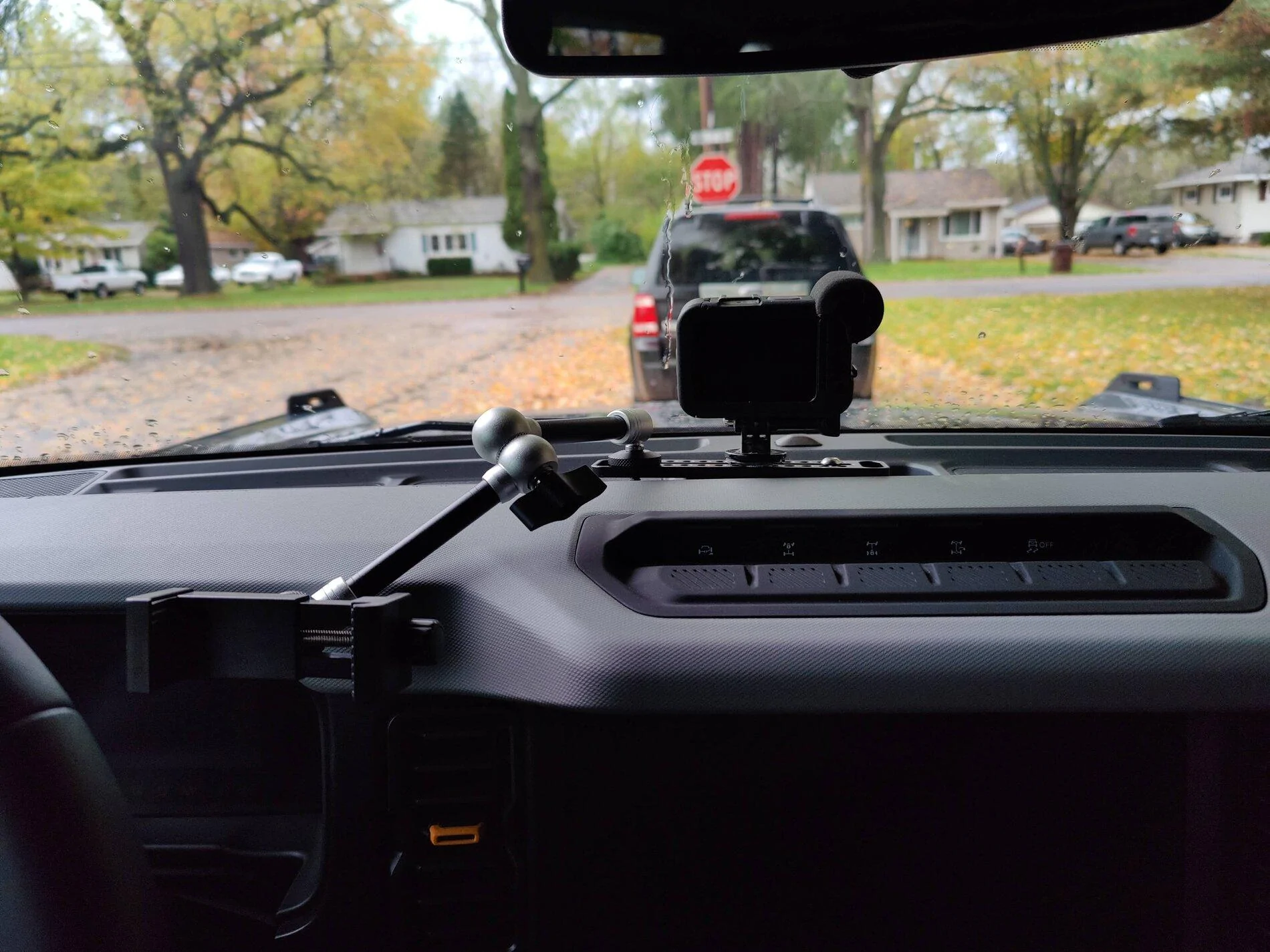

If I was to use this mounting plate, but get a straight arm (like a Ram mount) would you mind measuring how long it would need to be?
grayshadow
Charles
Jul 20, 2020
1,047
2,074
Humble, Texas
Heck yeah!!!
Happy trails boss!
No real complaints so far.
grayshadow
Charles
Jul 20, 2020
1,047
2,074
Humble, Texas
You want measurement from plate to phone mounted position?
4avor8ntfair
Feb 16, 2021
654
836
Houston, TX
BL-non SAS, 2.3 auto
Yes, please! From where the arm is screwed into the plate to the phone mount.
grayshadow
Charles
Jul 20, 2020
1,047
2,074
Humble, Texas
Measuring straight from mounting point to center of phone mount is 8.5” on mine.

Hello all,
There have been a number of people complaining about the mounting bolt in the dash coming loose. I wonder if those arms will put enough strain on the bolt to advance the 'damage'? On road driving, perhaps not as much of an issue... but some have complained that simply having a GoPro mounted on a really bumpy road has loosened the bolt.
Anyone notice this yet?
-Cru

Mine is still going strong with no issues at all. And I was the first one to do it lol. I suppose depending on how other people's vehicles were built it may vary?

If it’s a rail system you can’t live without, just add some loctite to the screw.
