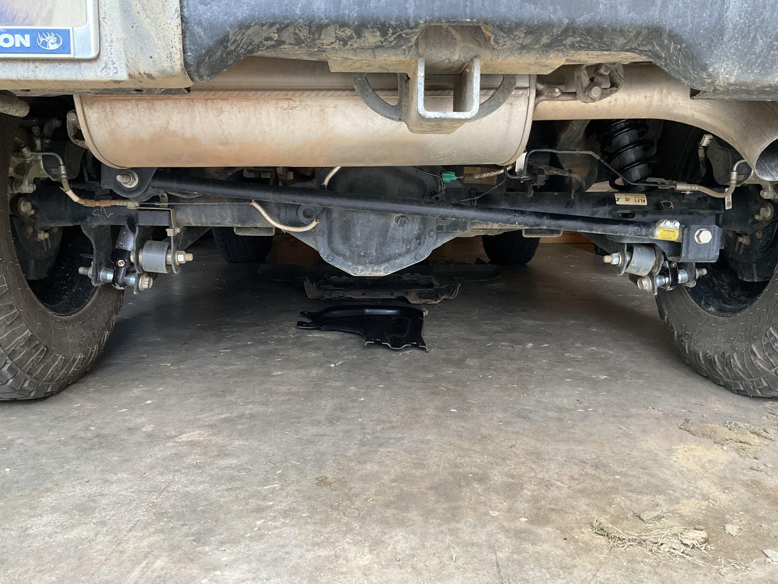

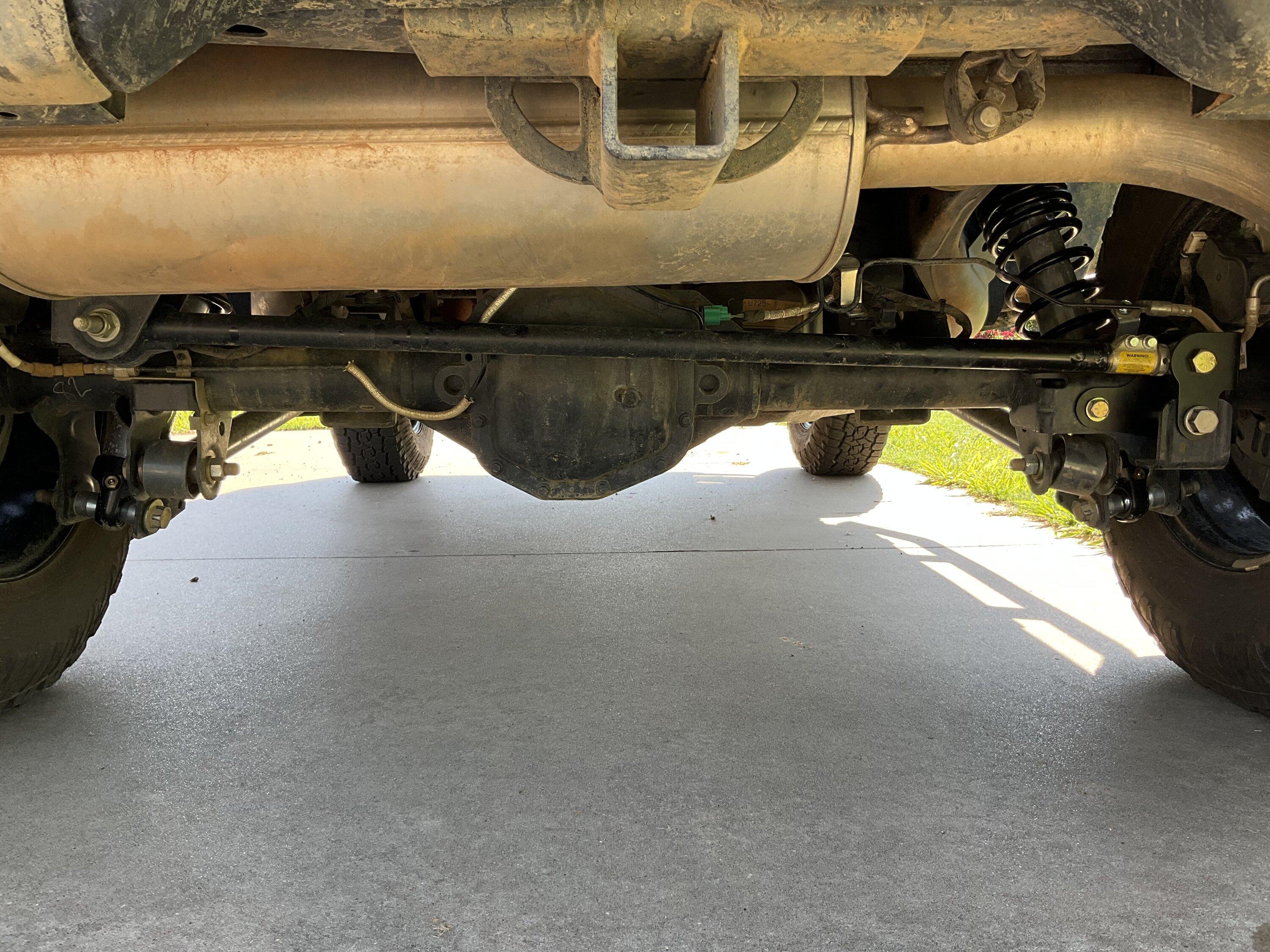

As far as the track bar, it depends, but it's probably a good idea to replace anyway if articulation is a concern. I went with the Icon bar with uniball mount and a relocation bracket as my bar was at a greater angle on flat ground than I wanted. It should be fairly horizontal when the bronco is level.
Before and after with relocation bracket.
