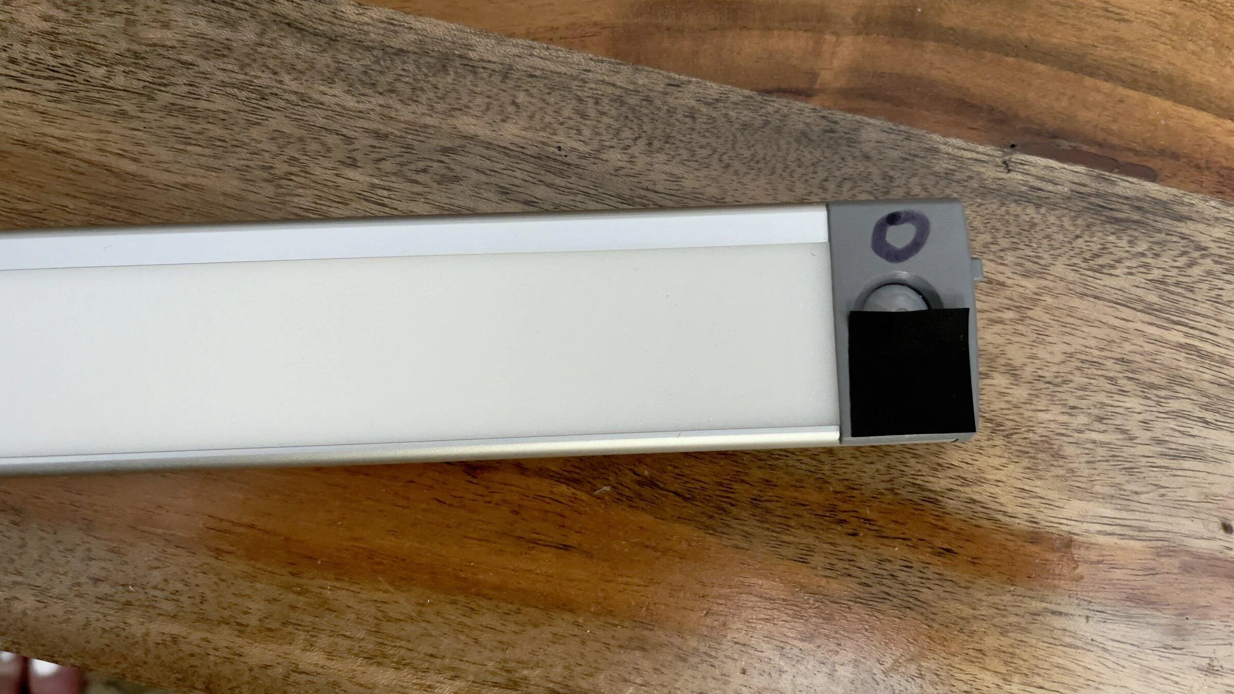

Here they are. Super slim. Crazy bright diffused light.
So with regular cab motion they dont come on? Only if you are right under them? Look great if thats the case!

There is a motion sensitive dome on them. I put a little tiny piece of black photo tape towards the front of it so me or a passenger can’t set them off. Put the clear dome towards the back.
They will come on as soon as it senses the rear swing door open. So it's really nice. Already on when you open glass door.
