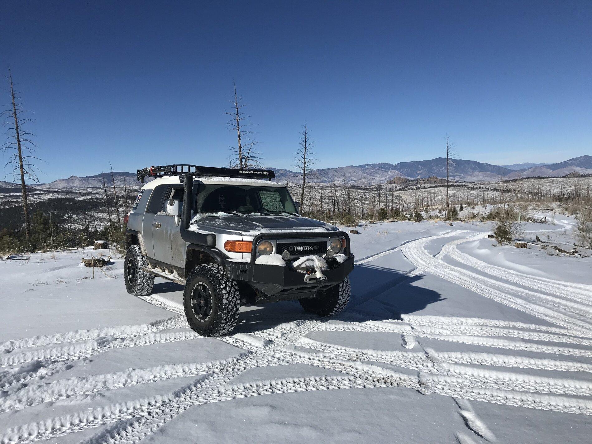

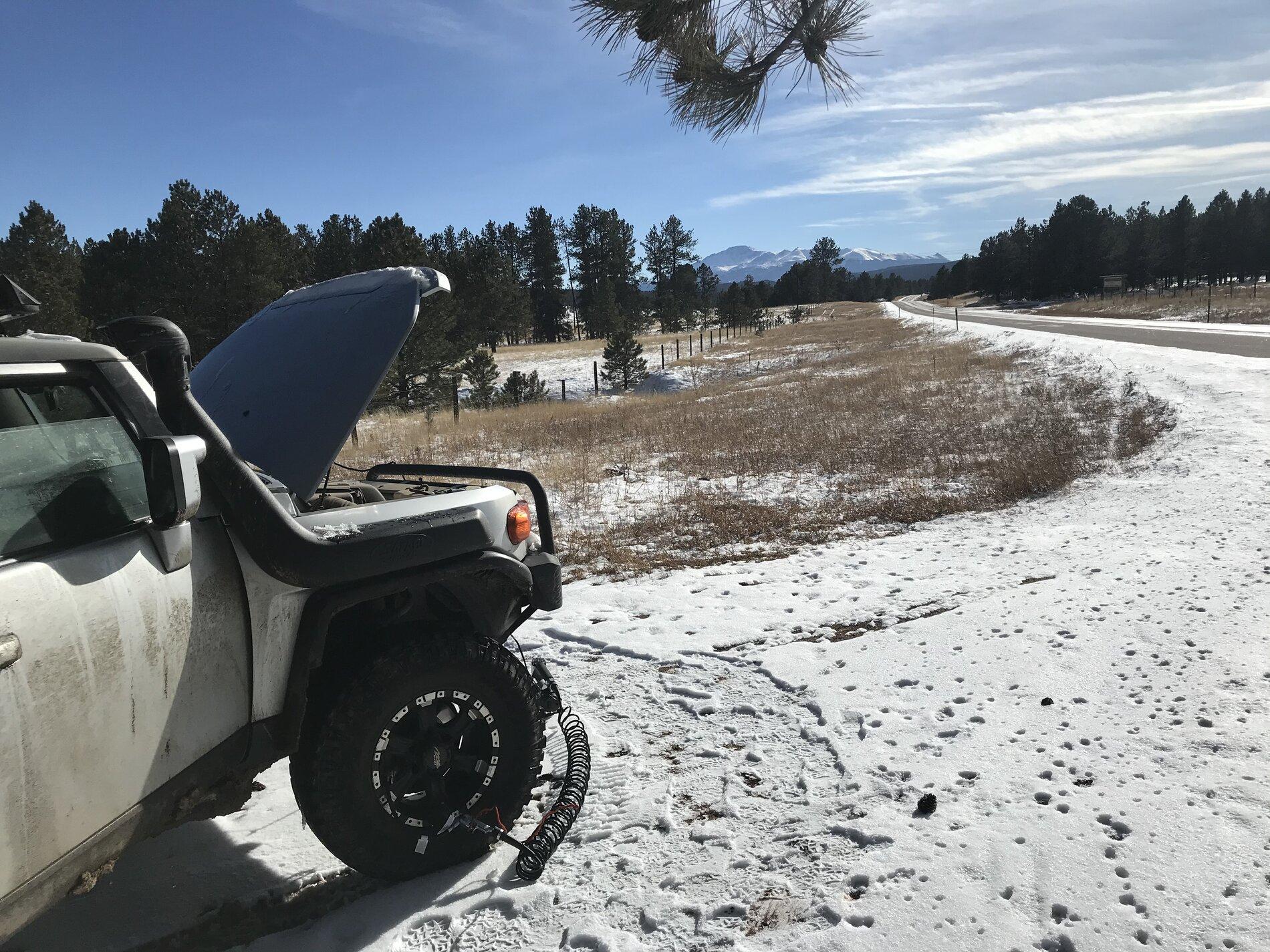

Went for a ride this morning where we hunt turkeys and take the atv’s. Aired down to 16 and then aired back up when we were done to 38. I normally just air up to 36 but the gauge only goes by 5 lbs so I stopped when it said 40. It was actually 38 from the gauge I frequently use. So that was 22lbs of air at 5 minutes and 5 seconds. Roughly 4.5lbs of air a minute. The compressor gets hot like my smitty built did but it never quit and was really quiet comparatively. The air gun that came with my kit does not have a way to keep it constantly on so I tied a wire tie on it so I didn’t have to hold the trigger the whole time. I think the 400 would be faster by about a minute but it also will have a cool down cycle that I didn’t want. We timed all 4 tires and they were all the same. My CO2 tank airs my tires from 18-36 in one minute. Close to 5x faster but I have to get it filled once or twice a year for 20$ a pop.
