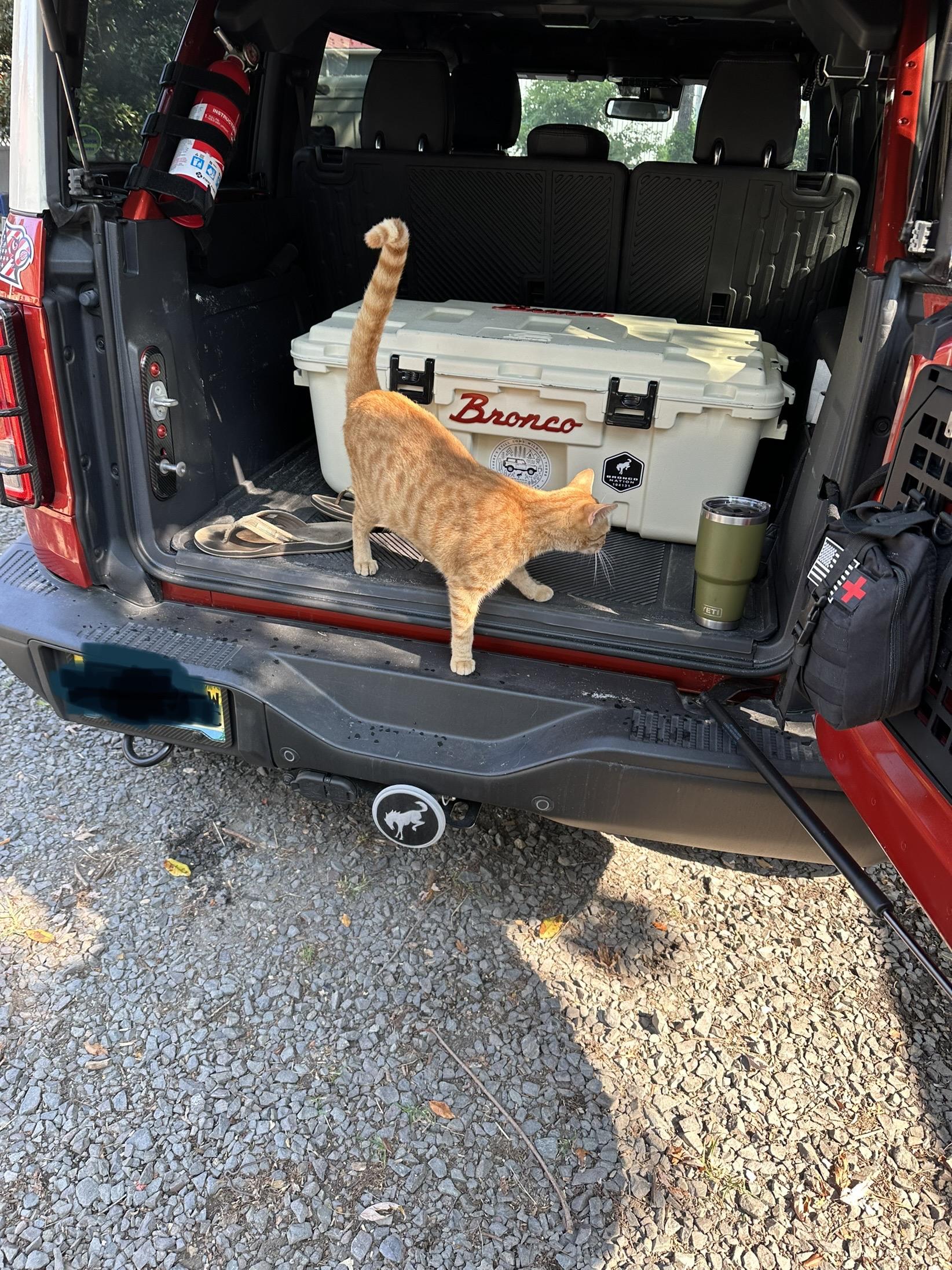

Made this box to hold all the gear for the beach!
