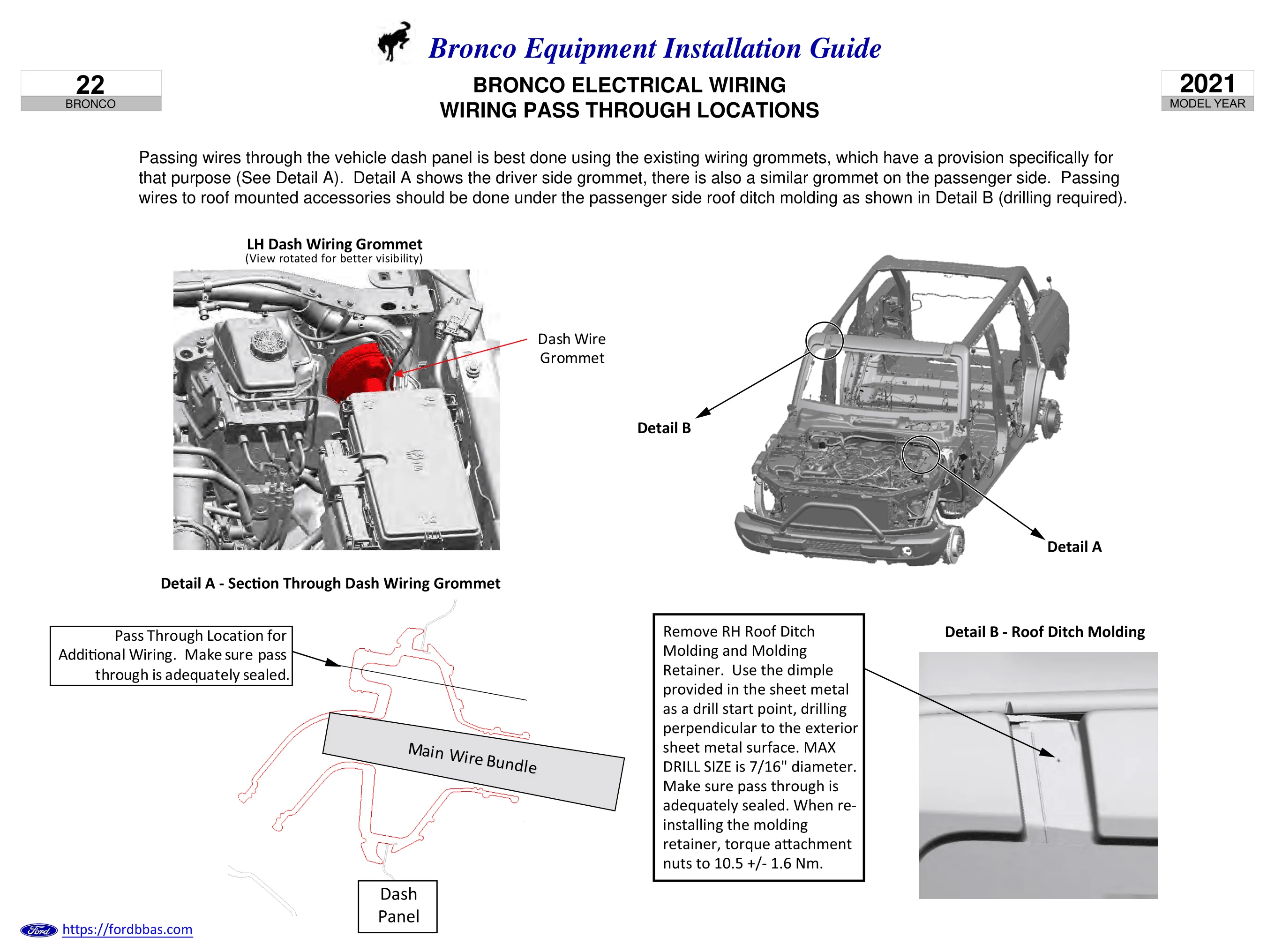

I ran a 2/0 awg wire through the grommet/nipple that Ford recommends. I used a flexible right angle extension on the drill to get the bit down there.
In the cargo area I split the 2/0 to two 1/0 gauge cables. One feeds the amp and the other feeds my battery bank.
Ford Bronco Amp power route Bronco Equipment Installation Guide - Wiring Pass Through Locations-1
I have 4 wires running through that grommet now, including the 2/0 for my amp, room for more! Very happy to have that easy access.
