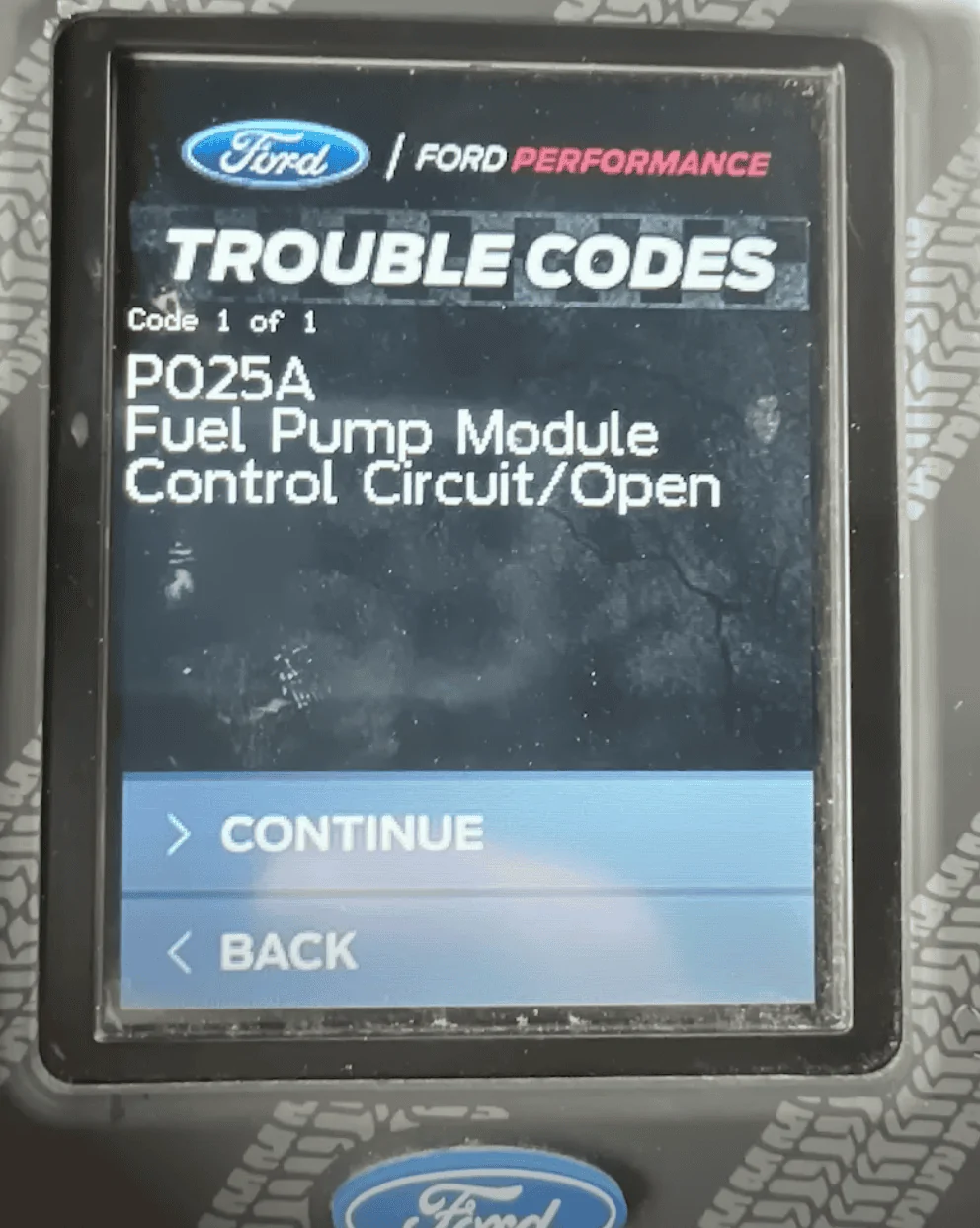

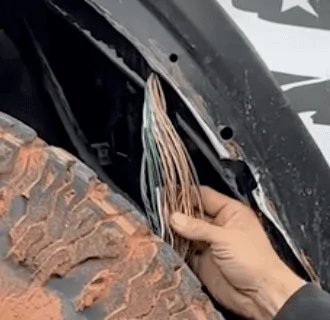

It didn't start with the key. Matt's quickly searched for fuel pump solenoid, which wasn't on the bronco. It could be the pump is OK but something in that circuit failed. Harness problems are very possible.
Also note the Bronco had tires too big for the configuration of the vehicle with the front tires rubbing all over the place at full compression.

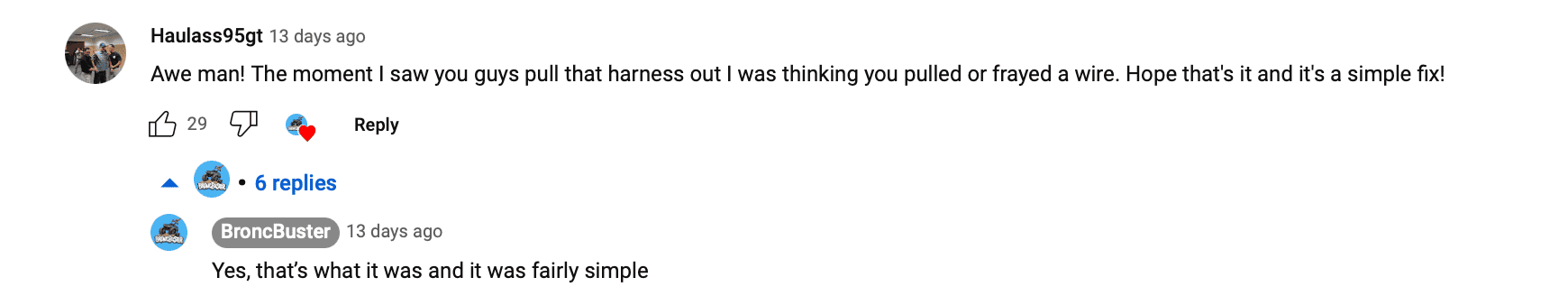

Hopefully we will get an update as to what the actual issue was. Curious if it was the nicked wires or not.

Another case of ā€œJust a slight rub when I turn hard and itā€™s only touching the fender linerā€
