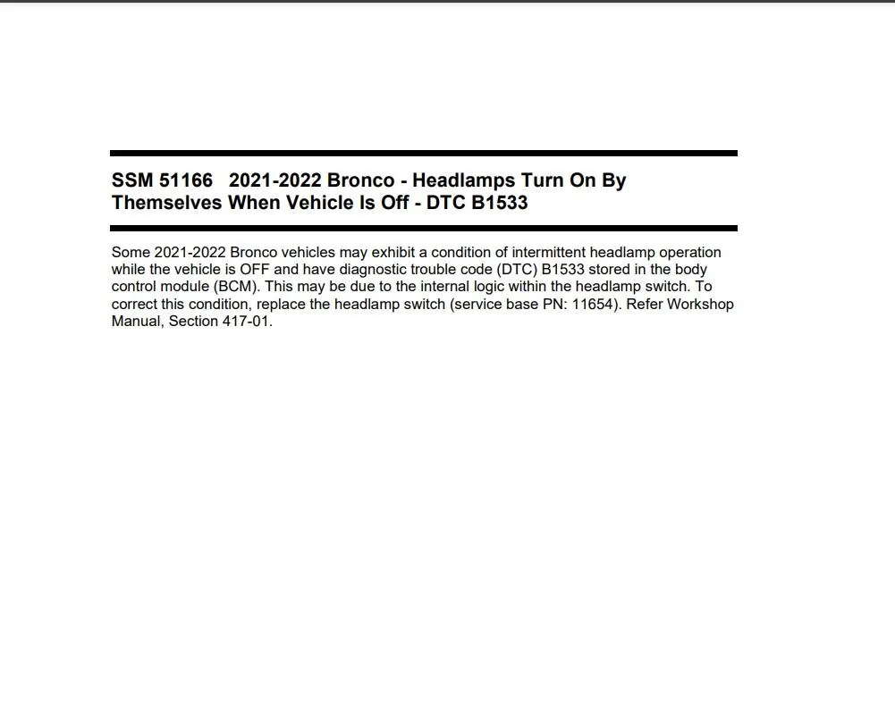

Nothing to do with height or hitting the knob. There is a known issue with the lights. They will just turn on by themselves and then off after a few minutes. It will sometimes be on "on" instead of auto when you get out so it dings. But it will often just do it on its own.
EDIT: Apparently you can go get it fixed.
Be that as it may, that is a separate issue. Hitting the knob with your knee is a real thing that many of us have (obviously) experienced…

Well yeah, but that isn't turning it on by itself with nobody in it. If the problem is really just hitting it with your knee, solution is don't hit it with your knee.
I am 6'2" and thought I was hitting it with my knee for months until I made sure not to do it and thought I was crazy until I found out about the knob issue.
This. Had my switch replaced, end of problem...
I think its actually both. Just last night I had what you posted happen, I got out and there was a glitch like scenario where I know I didn't hit anything but the lights were ON. Other times I have 100% grazed the underside of the knob with the top of my knee.
Is there enough room to tuck a thin cowl like shield to the underside, maybe an aftermarket trim piece type deal?
