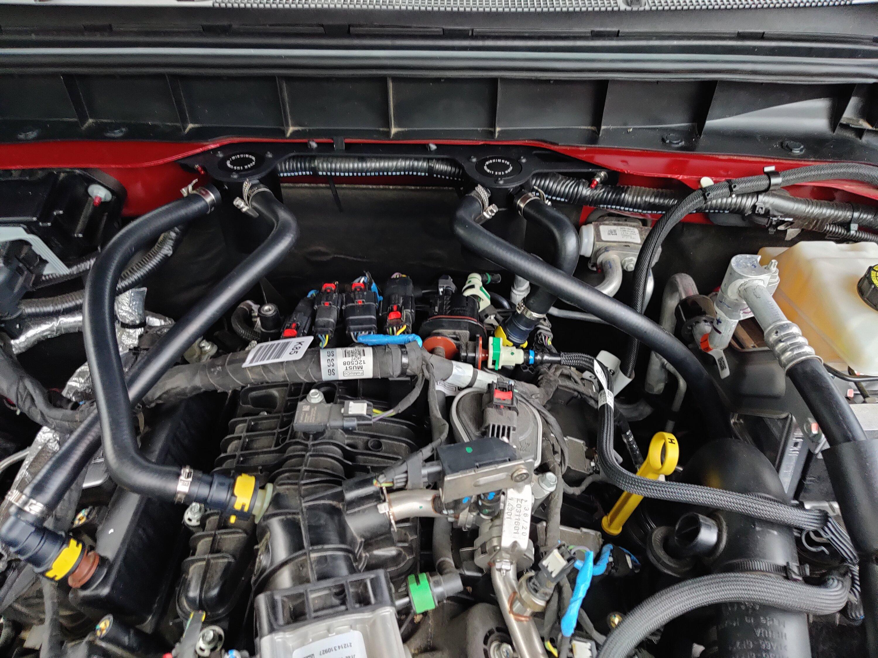

Lol yeah maybe that dual catch can is available maybe in three years. Their products take forever to release. They should spend less time on blog posts/ pictures and more time on actually releasing products. If I get a CAI I'll go with k&n
I've had their dual catch can for a few months now. Still deciding on which air intake (Mishimoto or K&N) and intercooler to go with before Whipple tune. Even at stock boost capturing oil on PCV side and on the CCV side.
Ford Bronco Anyone go for a cold air intake yet? IMG_20220505_073354
Personally I like k&n. But I'm also found of matching companies. Run all mishimoto then when the charge pipes come out grab those also
