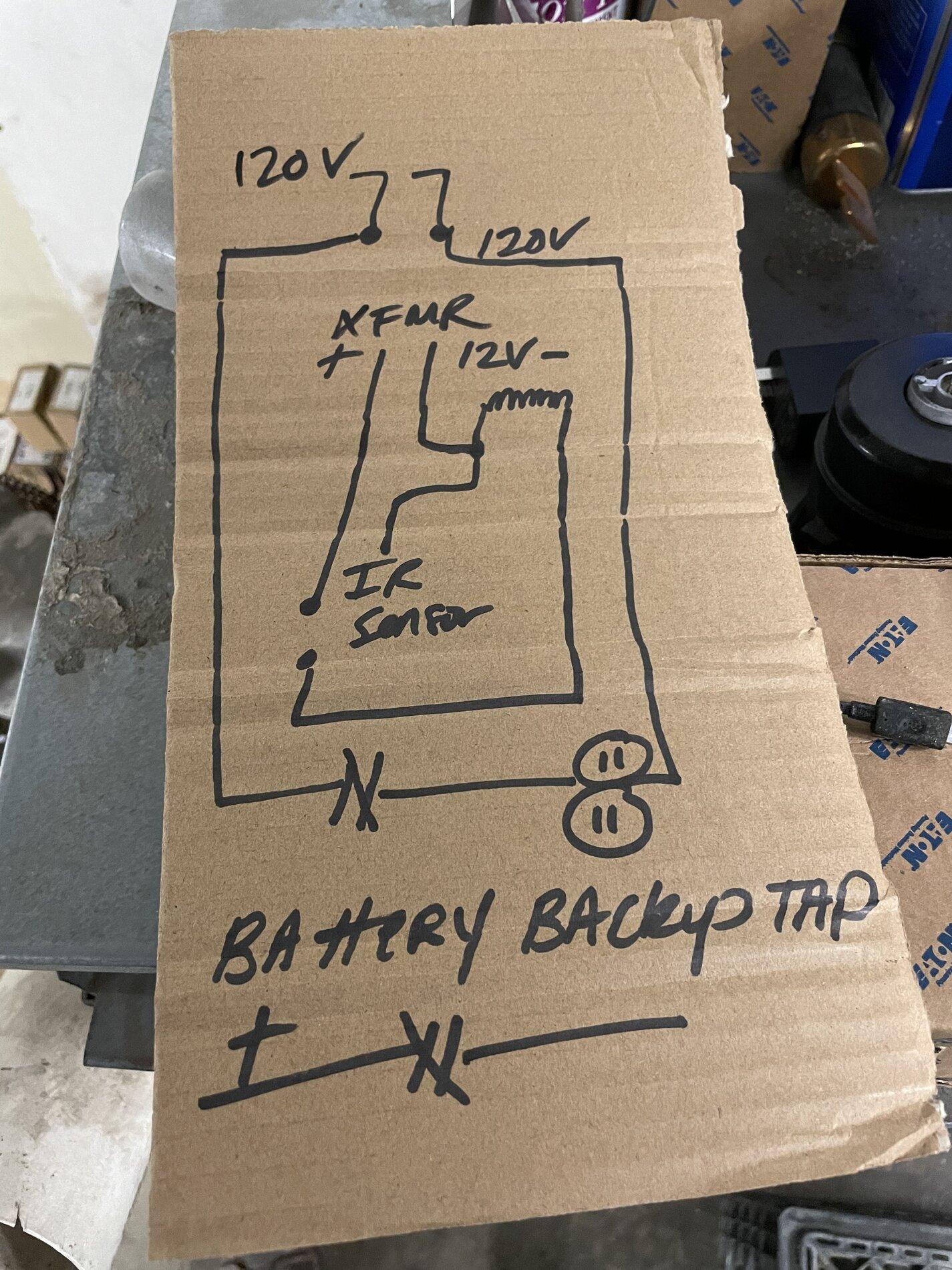

Here you go @Bonnie6G
Get 12V relay, base, IR sensor and a electrical box extension. Tap your 120V with the extension to line side of a 12V transformer and the other half to the normally closed of the relay, run off the other side back to your garage door recep. Tap your neutral for the transformer, run directly to recep. Take your 12V, run negative to coil and tap and run negative to IR sensor. Take IR return positive to your relay coil. Tap your battery backup and run the positive through normally closed.
Voila. When the IR sensor senses anything it will open the 120V and the battery backup and your garage door won’t even open. Problem solved. Less than $60 and an hour.

Lol I am an electrician, it’s easy. I just posted it, incredibly simple.
That circuit would kill power to the garage door opener whenever anything moves near the sensor. I thought the goal was to only trigger when the roof rack was on? Detecting something that small will require either a retro-refelctive or a through beam light sensor. I would want it to look nice since it will be located outside the garage door. I would also want the circuit to seal in with a "reset" button. Would not cost $3,000 at home because it would all be hard-wired with relays as you suggested.
Im not doing a deep dive on sensors lol. I’d have to actually spend time going through their patterns and what not.
https://www.amazon.com/Taiss-Proxim...t=&hvlocphy=9028899&hvtargid=pla-569312154368
You can find one that works. A reset button would easily be added that could lock the relay in the on position. I do it all the time on grocery store back door buzzers. They don’t open until a button is pushed, takes 1 more wire.
