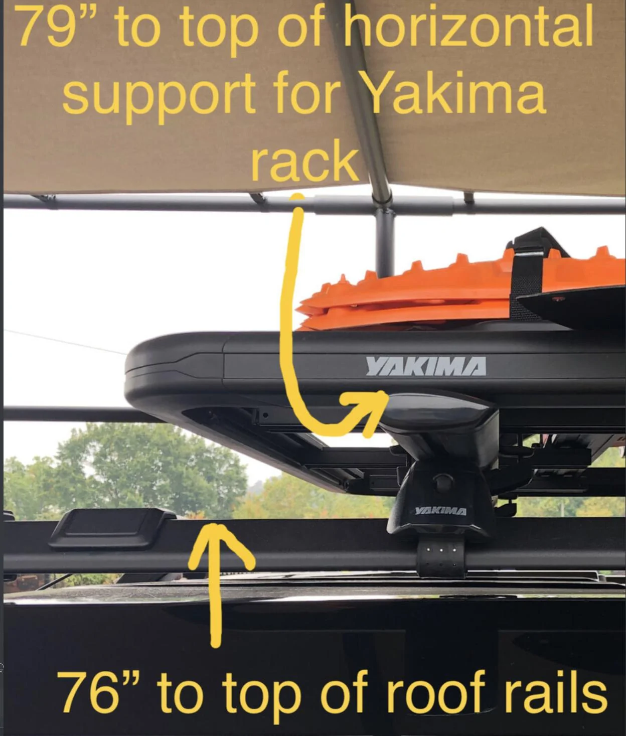

Here’s what I measured on the black bl On 33’s at super sel east

Yup, I calculated 75.3 inches in my reply above but it's great to get a real world measurement. Thanks so much!
I’m glad your calculations matched my measurements. they had the Bronco roped off and I had to stretch out big time and kind of eye ball the measurement.

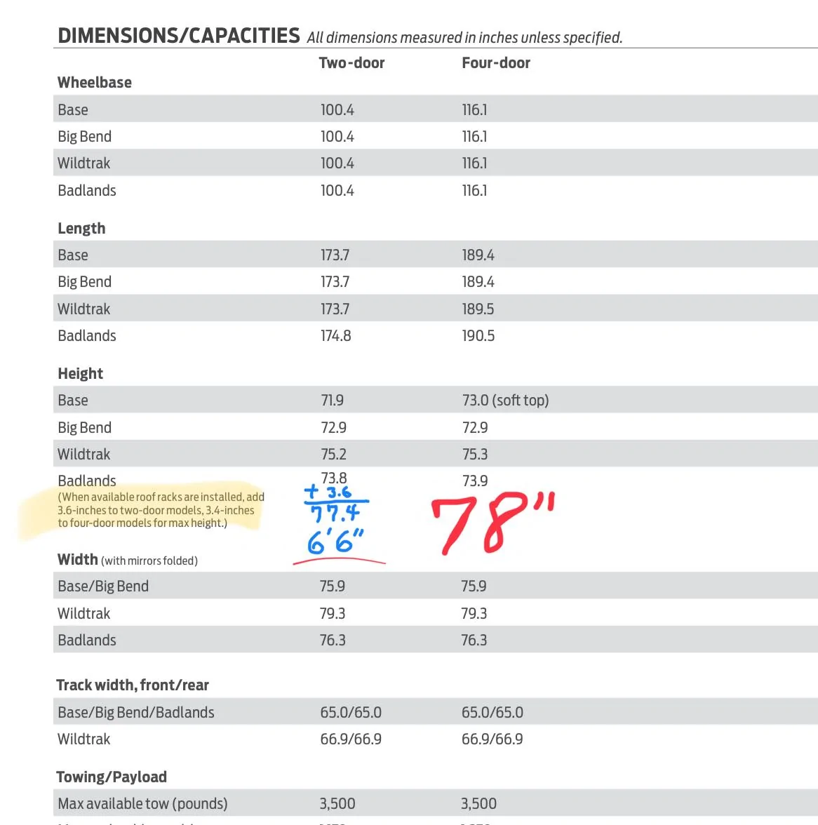

Here is the spec sheet from Ford. It includes the vehicle height for all trim levels.

Probably be closer to 79". The Sasq will have an extra inch of tire height and about .5" from heavier springs. Added to the 77.4" w/rails.... Any additional lift and it's not fitting in my garage. So I guess it's staying in the driveway.
