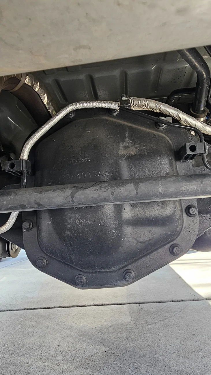

I have an ARB rear diff cover on the way and have exhausted several sources for relocation brackets for the stock clips that attach the lines to the oem cover. ARB does not make anything specific for our Broncos. I have a 2022 Big Bend 4 dr 2.7. They do sell a kit for Jeeps and heard they can be modified to work. The two black clips in the pic located at 9 o'clock a 3 o'clock are what I need to attach to the ARB cover. Any advice on what to do or pictures of successfully installs? Thank you!

The holed pattern is the same. The bolt head size are the same (cap head vs hex flange head).
The existing plastic clips should work for you.
Or is this a cosmetic issue?
Or did you break them?

Nothing disassembled yet. Want a good workaround before jumping in. Take the cover to home depot and find some parts :)

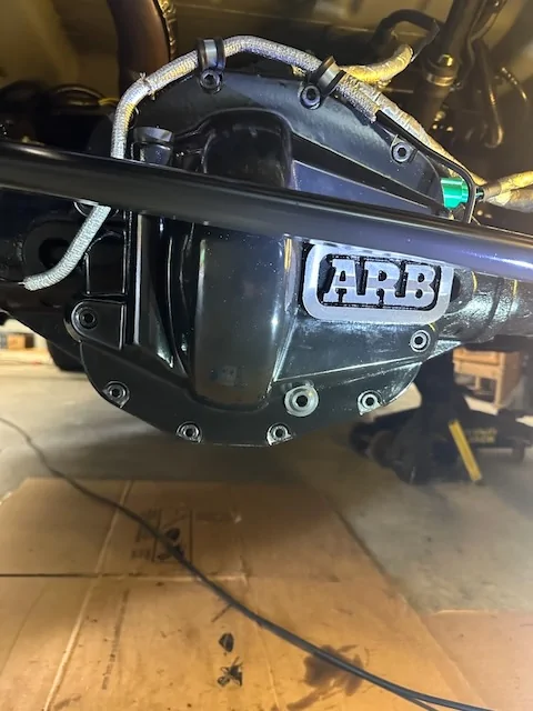

Here ya go; hope this helps

I just reused the stock clips when I added the Ford Performance diff. I was a little worried, but they came off easily once the bolts were removed.
