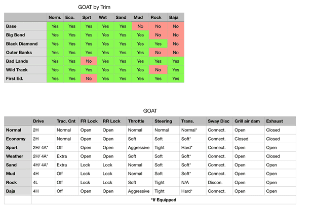

If you think GOAT modes are just gimmicks... take a good look at everything they manage through the ECU modules.
This can be found on one of the "hidden" worksheets in the Forscan matrix... and (with the exception of the "exhaust" column??) is absolute gold for being able to set the Bronco up for specific terrain conditions... here's how I go thru the process.
1. Pick the GOAT mode according to the matrix above (traction control, throttle/steering response, tranmission shift point, etc.).
2. Engage the transfer case in the desired mode (2H, 4H, 4L (or 4A if equipped)).
3. Engage/disengage lockers, traction control, sta-bar disco, or TTA with the hero buttons.
4. Select the camera options (they also differ by GOAT mode, so if you want to use the camera over 5 mph, you'll need to select Mud/Ruts, Baja, or Rock Crawl to start with).
Once you're set up, you should have a really good idea of exactly how your Bronco will respond to your input... and if you watch your "Power Distribution" (in Off Road gauge settings), you can see exactly how those settings affect each wheel getting driven.
Maybe the GOAT modes are just 'gimmicky' if all you think they do is eliminate the thought process of selecting the terrain...
.... but in reality, they enable you to think through exactly how you want it to drive... and then dial in your Bronco to do it. I doubt many people will ever bother to figure out how just many ways they can customize with 8 GOAT modes (thanks Forscan!), 4x transfer case settings, 2 lockers, etc, etc.
I've told people that driving a Badsquatch w/lux is like driving an iPad on 35s... and this is why.
I'm not saying it's intuitive or convenient... but at least it's worthwhile to figure out.

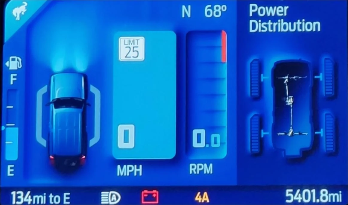

I confess, I thought "Sport" mode was a bit of a gimmick *for a manual transmission* because I can control the gear I'm in and the throttle (I'm told it makes a bigger difference with an automatic). However, I took my Bronco on some twisty roads, not the Bronco's natural habitat, last weekend. Compared "Normal" versus "Sport" and "Sport" was the clear winner.
Furthermore, going uphill in a tight turn, accelerating out of the turn, 4A also made a difference. I set my display to watch power distribution to the 4 wheels and saw that it was sending power to the fronts regularly. I was ambivalent about Sport mode prior to this, now I'm happy to have it for rare situations.

Am I understanding you correctly that the modes can be edited?
Change the throttle or steering setting in an already existing mode, for example?
Or are you talking about using Forscan to see exactly what each mode does and pick the appropriate one according to what you want?

Nope... don't think they can be edited.
My Forscan references are to:
1. That matrix just happens to be found in the Forscan matrix (a MS Excel document) on a separate worksheet. Don't think there is any implication that these can be changed.
2. "Thanks Forscan" was a reference to adding the 8th GOAT ('Sport mode' for a Badlands). I use Sport mode as the basis for a lot of how I set it up due to its comparatively "aggressive" settings.
3. "Customizing with GOAT modes" is just using the process I was trying to describe above. a) Use the GOAT mode to set the throttle response, etc... b) then set the drive mode in the transfer case... then c) dial in lockers, disco, cameras, etc. It was not customing the GOAT modes themselves.
That said, it would be nice to select each one of those individually... but I don't think many people use a screen with 2 dozen buttons on it... or even better, a bunch of hard wired switches like an old 747. (Which would be REALLY cool, btw!
Especially for the "bare bones" idea.) 🤔
I think the whole purpose of the GOAT modes is to simplify the process of setting all those parameters. That just means you have the process of taking what the GOAT mode wheel gives you up front... and figuring what you can configure beyond that with the transfer case buttons and the hero buttons after that.
Just my .02
