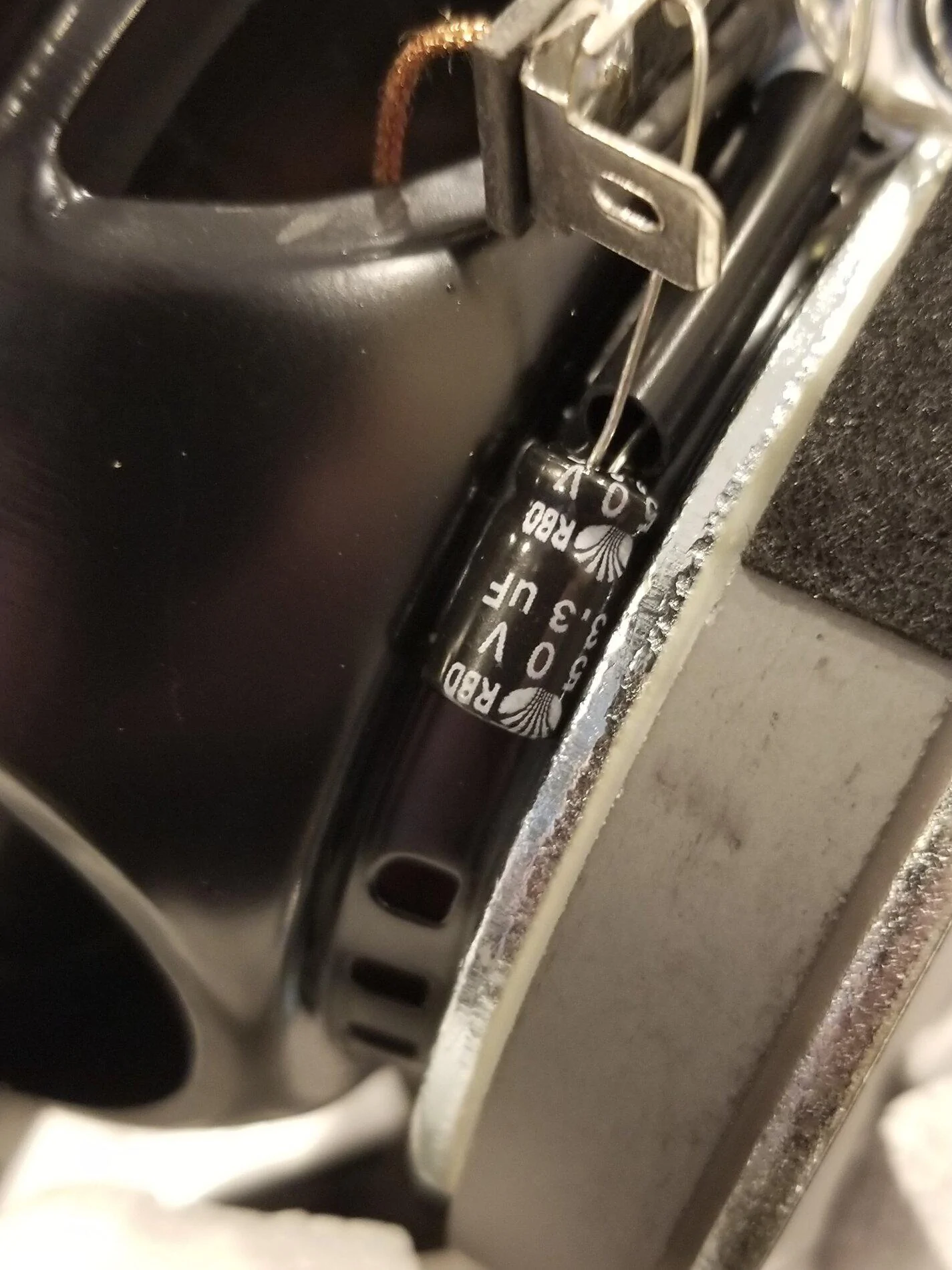

I received my Infinity Reference 4" speakers and see that they already come with bass blockers for the tweeters. I am planning on using 400 or 600 hertz bass blockers. I'm wondering what is the best way to hook these up. Is it ok to run 2 blockers?

I received my Infinity Reference 4" speakers and see that they already come with bass blockers (although very low frequency at 3.3uf). I am planning on using 400 or 600 hertz bass blockers. I'm wondering what is the best way to hook these up. Just leave the speakers as is and install the bass blockers in line, essentially running 2 blockers, or remove the factory cap and installing the different one in it's place?
for my dash speakers I ran the separate bass blockers in line with whatever is included within the speaker itself. There is a noticeable difference, without the additional BB the sound was less than adequate but it improved dramatically after. I wired them in the pods at first but removed them as it truly was fine without and made it too tinny with.

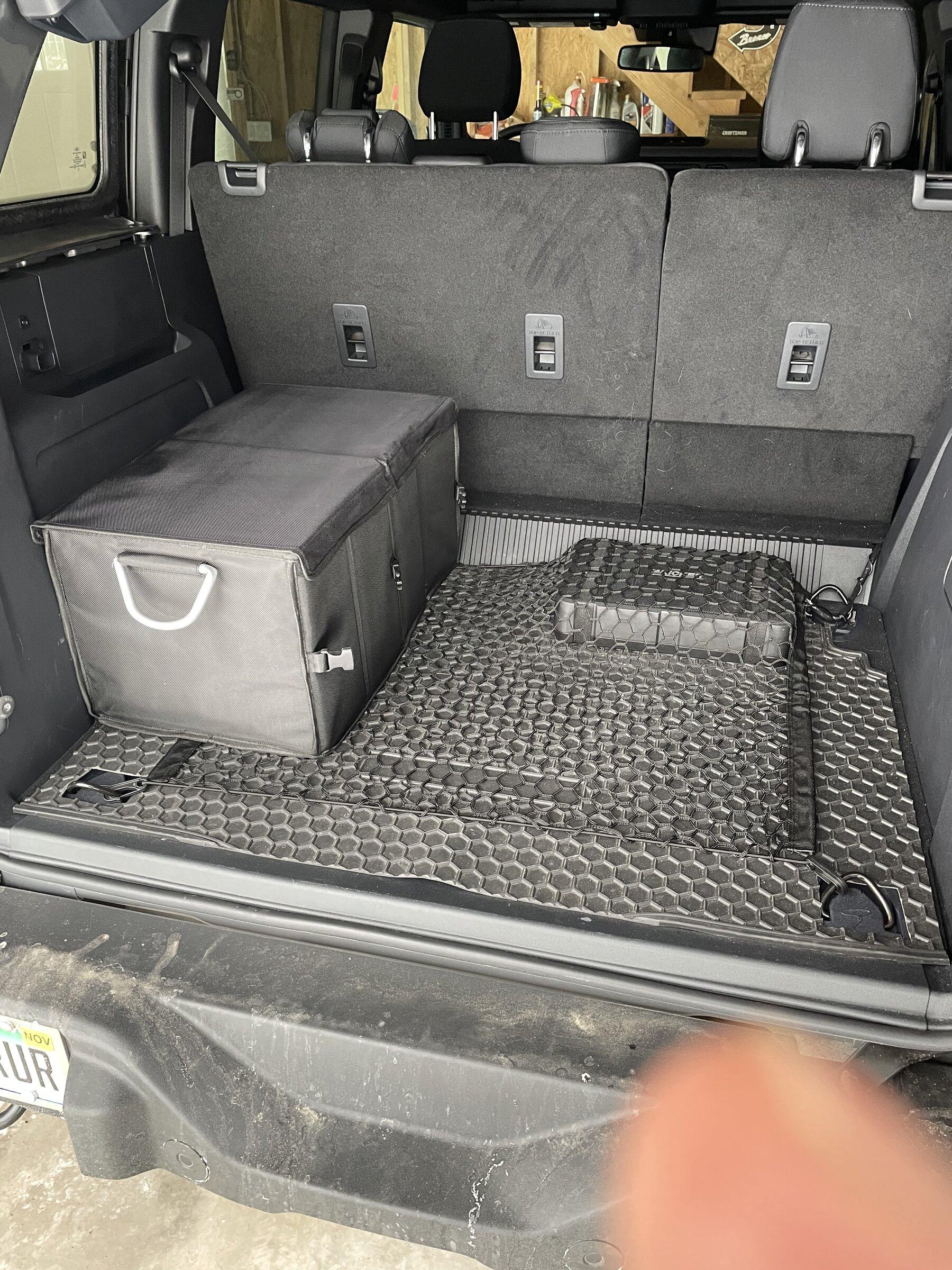

I would add a powered subwoofer, which I just completed. I have a Kicker HS8 which is an 8" subwoofer that puts out 150 Watts RMS. I am super happy with the performance. It is not a subwoofer to rattle your neighbors windows, just adds a solid bottom octave to the base system. I did order the Infinity Reference 4 inch speakers which i will install in the dash, along with 600hz Bass Blockers. I kept the stock 6 1/2 inch kick panel speakers because they are waterproof and the load on them is now less with the sub. The installation of the sub was a bit involved, but once completed it is the best $ 270 that I spent on any audio system. BTW I am a former Ford Audio System Engineering Manager, and the base system is the worst sounding system that Ford has put out in decades. I understand the limitations of the speaker packaging in the Bronco is a big factor.
Can you share pic of sub installed?
JGee

Ford Bronco Audio Upgrade - Observations/Questions EE4551DC-FF8C-4CFA-9441-707E701332DF

The Kicker sub is the small box on the right😎

I have read a few things that I thought I would chime in for. Subwoofers are rated at a certain power handling in watts RMS. A sub doesn't put out 150 watts RMS, that is the maximum it can handle from an amplifier before it causes damage. Second, what most people see on aftermarket coaxial speakers for a capacitor "bass blocker", is the high pass capacitor for the tweeter on the speaker. It doesn't stop bass from going to the main woofer, even though its only 4". A coaxial speaker is 2 or more speakers on the same speaker location, (coaxial). So you will need a capacitor "bass blocker" for the front speakers in the dash and the frequency to use is dependent on the speaker being used and the size. Most people here say 400 to 600 HZ. That is a good range but can be higher or lower slightly. Here is a website I found that has the micro Farad (uF) value of a capacitor and the corresponding frequency it will block lower than on a chart. Look at the 4ohm values as that is what most car audio speakers are. You will see the 3.3uF capacitor in the picture above and that it has a cutoff frequency of 12,000Hz so this would definitely be for a tweeter. Also, according to others, the rear 4" speakers are already crossed over by the head unit so no capacitors "bass blockers" are needed. I haven't done mine yet but hope to soon. Sorry this is so long. Hope this helps.
https://www.amprepairparts.com/xovercaps.htm
I almost forgot, wire the capacitor inline with your positive wire like in the diagram on this website.
