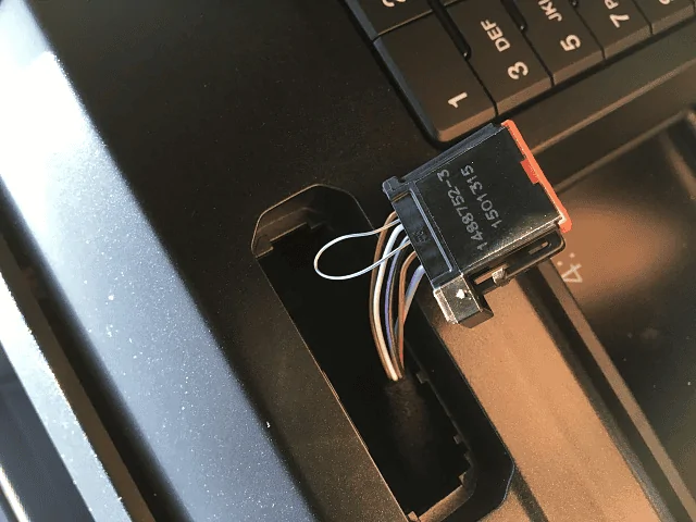

So that pic is from an f150 then? And what switch is unplugged in the pic?
Yes correct, in the F150 it's a stand alone switch. My pic shows the plug in portion of the harness that mates to the actual switch. The jumper actual goes into the back of the harness connector.
Does bronco have a standalone ASS off switch? I've been waiting all this time, but have never even sat in one
yes. I have taken the HVAC assembly out a few times for other add-on installs and I can tell you, the A.S.S. button has its own connector
Tried finding a wiring diagram for it but I keep going round in circles. I'll do some more digging and see if I can find it. Also ASS will not engage if battery temp is low, but I couldn't find any evidence that Bronco has a dedicated battery temp sensor. Thought maybe a jumper in batt temp sensor would work...never seen one on a Ford, but Mopar uses them
From the F150, the wires used for the ASS jumper are the purple and white wires. Jump by either splicing a wire between the 2 wires or shoving wire in the back of the harness until its secure and wont move. I used a paper clip and never had an issue with it. Hopefully you find it with the wiring diagram.
