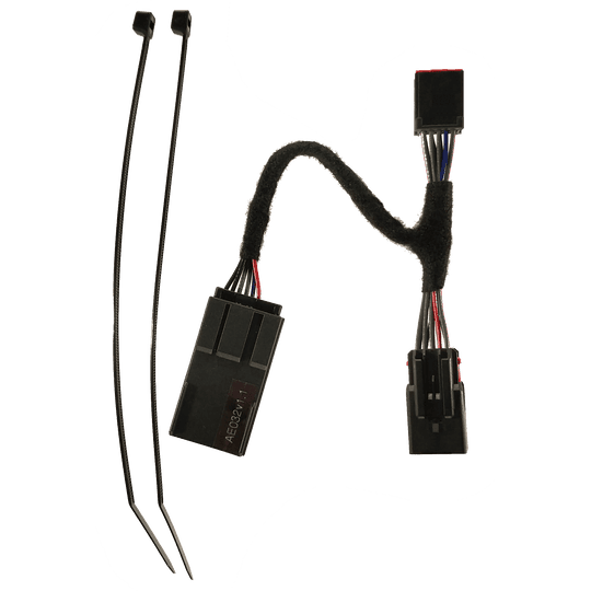

There's a new ASS eliminator that came out on Amazon that's $50. You don't have to take anything apart and it installs under 5 minutes above the kick panel on the driver side.
These work different than the forscan "fix" I believe. These plug-in eliminators, basically re-push the off button on the startup.
The Forscan tricks the Bronco and to going into Start stop mode by thinking that you are providing input (I think it's turning the steering wheel).
I tried the one on Amazon but sent it back. First issue, it did not work with a manual transmission. Second issue is that the wiring is not as heavy as stock. The positive and negative wires in port #1 and #2 are much heavier than this one so wouldn't use it on any Bronco.

I've had it for weeks And it's been working great, of course I have an automatic so I don't know if that makes a difference.
Also, the wires don't need to be as thick because they're not as long. How many amps do you think are going through that?
I'd be curious what gauge of wire the established auto start/stop eliminators use.

That's not how wiring works. You should never take a 10' run of wire that is 12 gauge and insert a short piece of 18 gauge in the middle. #13 and #14 are also 12 gauge from the factory so that is 4 total in that connector. No wire on the cheap Chinese harness is anywhere close to 12 gauge. The rest of the OEM are 22 with one that is 20.
The original ASS is in a totally different area and doesn't have the same wire size issue.

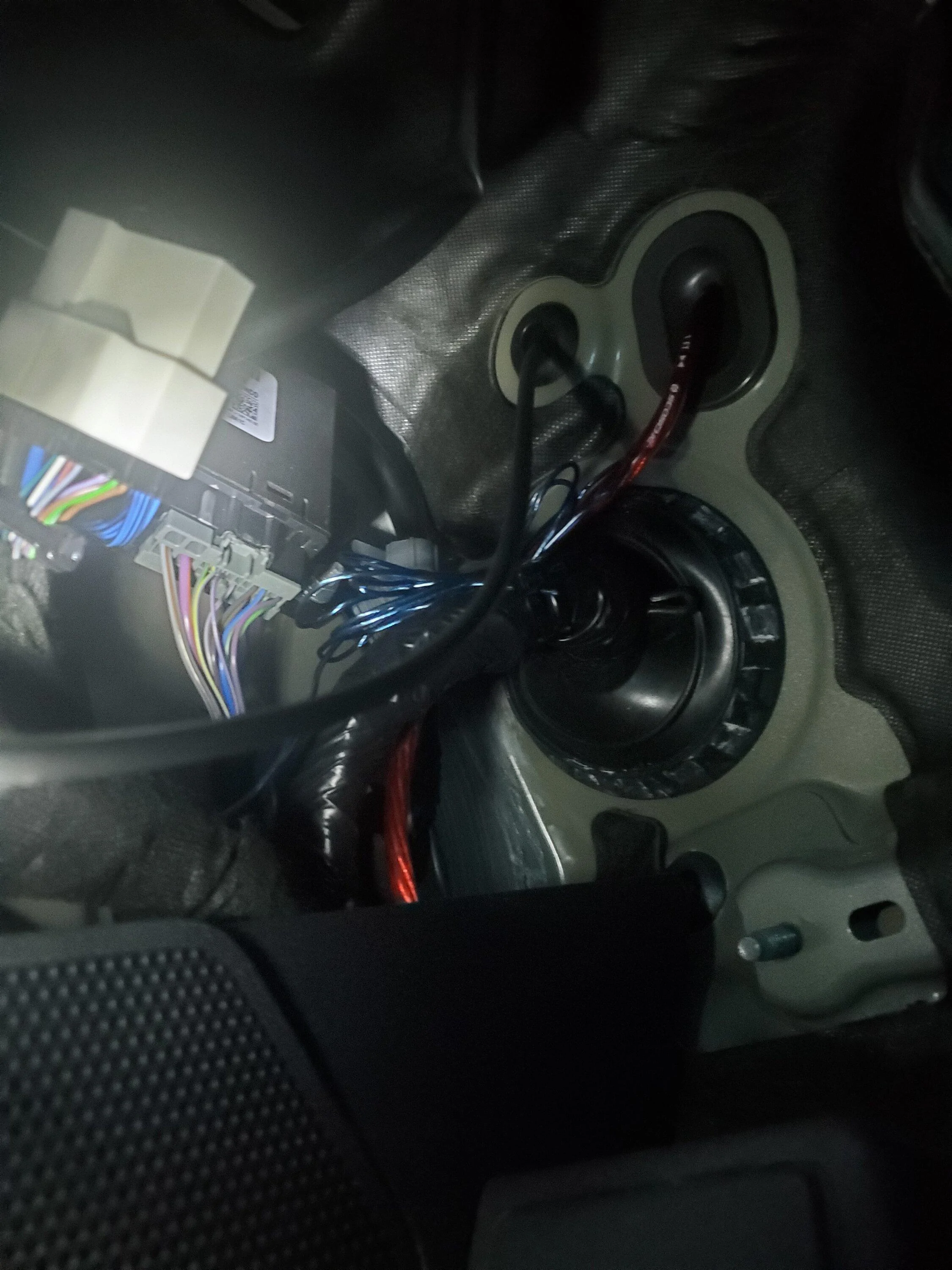

I guess I am missing where the Amazon one connects to. I do not see anything visible by the drivers kick panel? If anyone has install pictures that would be greatly appreciated.

Look right above your driver kick panel. There's a black box. It is that cream colored plug
Ford Bronco Auto Start Stop Delete? 20230515_061653

Thanks! See it now. Now as long as it works with a Badlands!
