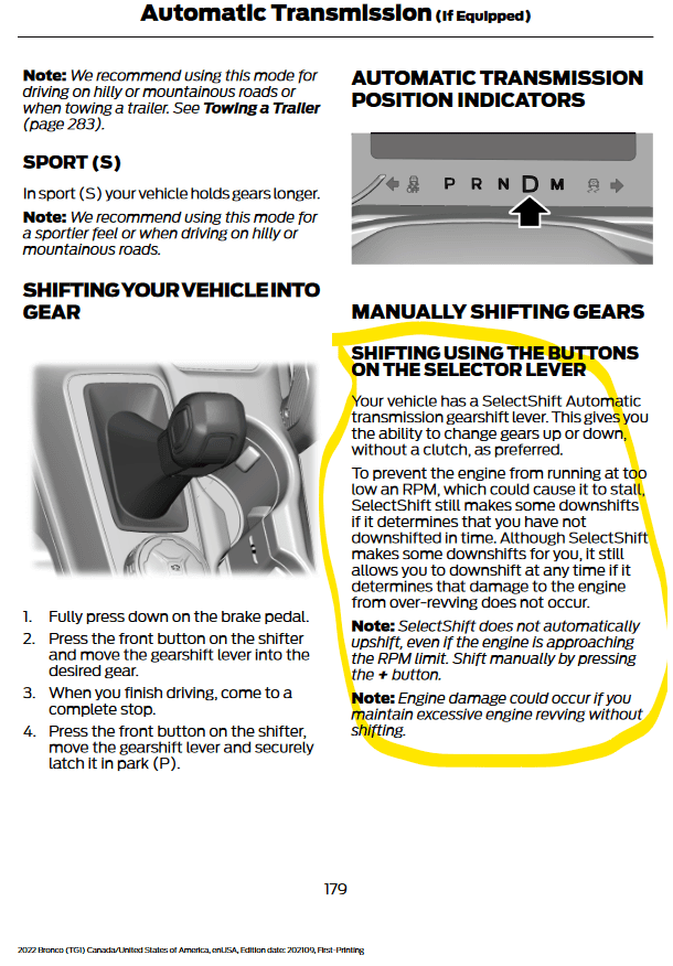

What they are getting at is if you accidentally tapped the - button even in drive it can hold the gear longer then will eventually shift.

It doesnā€™t go full manual but will let you down shift at any time you tap the - it wonā€™t let you go all the way to 10 either. I use it frequently going down steep hills in town vs riding the breaks.

Good info , but I did not upshift. Had both hands in the wheel and shoe upshifted in her own.
Well, kinda. The excerpt from the manual is when in M mode. If in D you can downshift with the - button, but the transmission WILL automatically upshift when it's ready. As '21OBX stated handy for going downhill, it will automatically upshift when you start cruising again.
In M it will not upshift, but it will downshift if you slow down below the recommended speed for the gear you have selected.
