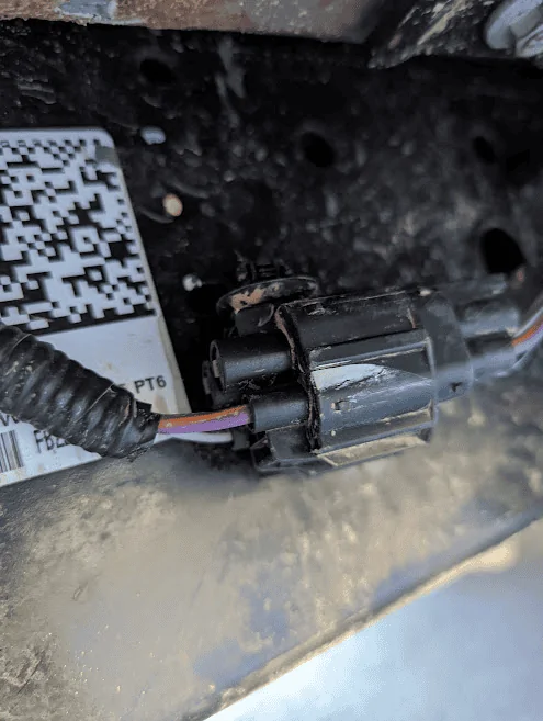

Well, I was on the trail Saturday with my new Bronco (1200 miles on the odometer). First time I ever put it into 4 Low.
After a couple hours I was getting back on pavement and I tried to shift back to 2 wheel drive. I get a service 4x4 error and it will not shift out of 4 Low. Tried all kinds of stuff, disconnected the battery etc.
got it to the dealership about 10 miles away, waiting for a call to tell me what the story is. From my googly skills, sounds like I am not the only one this has happened to.
Aug 16, 2022
Fox River Grove, IL
2022 Ford Bronco - Black Diamond SAS - CPR
Just wanted to follow up on this. dealership couldn't figure out the issue but got it back to 2wd resetting the error codes or something... as soon as they went to shift it... same error code came back.
I needed the truck and asked them to put it outside in 2wd and I would come back next week for them to continue working on it once I arranged for another vehicle.
went to wash it before bringing it back and saw a wire pulled out of this plug.
Ford Bronco Won’t move- stuck in 4L 1668113735567
I pushed the wire back in and everything worked fine.... no error codes and shifted in and out of 4wd no problems.
I assume while I was trail riding a branch or something hit the wire out. It was a hassle, but glad it was such an easy fix.

Where is that? Looks like it’s on the frame? I don’t recall seeing one like that. Crazy how something so integral is just so vulnerable. Good for you though, nice getting your truck back!

Sounds like we need to make a shield for this plug!

Glad u got it sorted. I always try to sort things out myself. Warranty or not,shops are on timelines and never put enough time in to sort anything. Simple fix for you in the end. Fords how to fix a vehicle book must not have mentioned that plug! Lol
