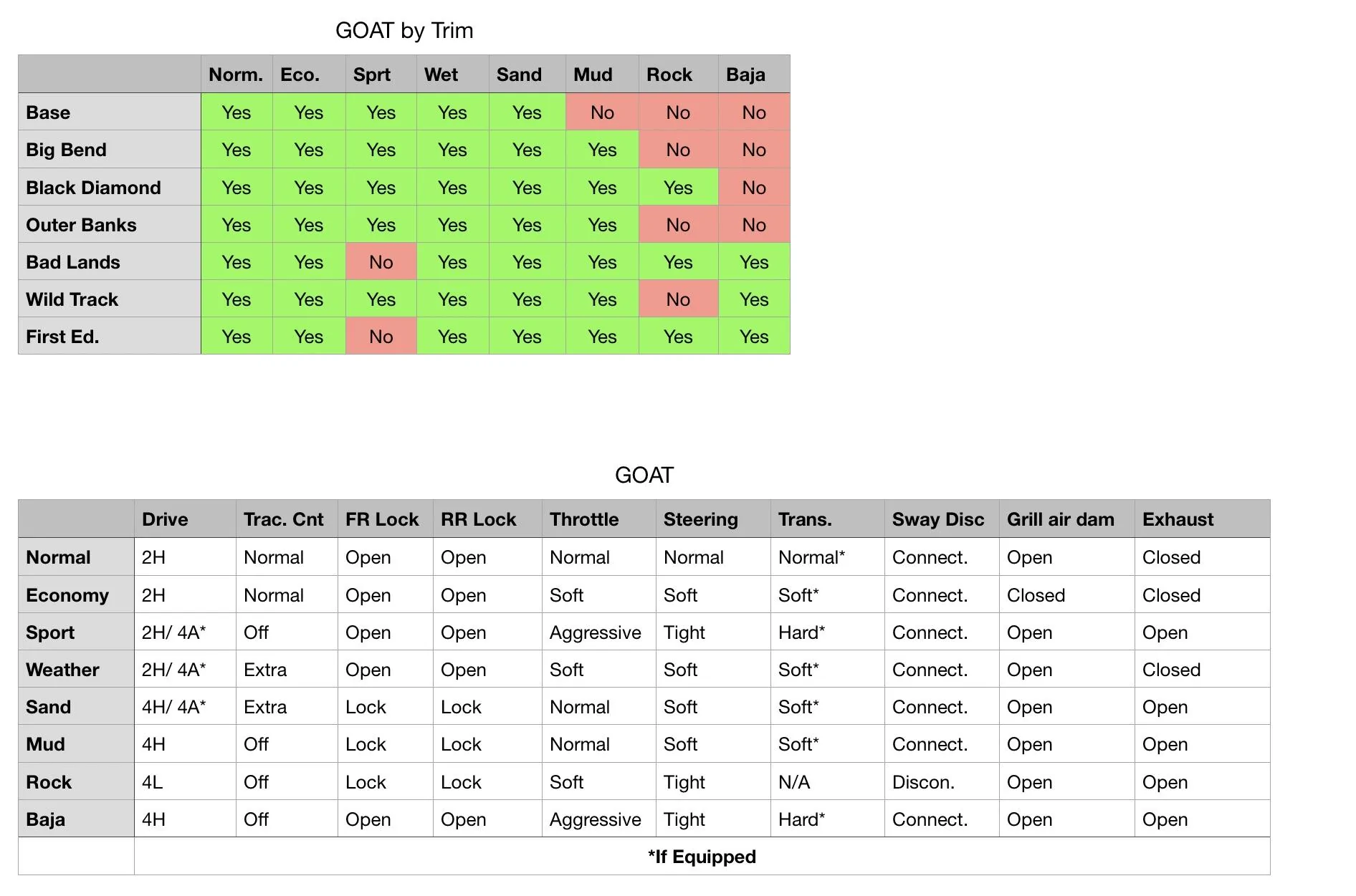

I thought I read that Baja mode locks the rear diff as well. Can anyone confirm? And I think that is exactly what Baja mode is for, cruising through sand dunes. I think I would get more out of that then Rock crawl mode if I lived in Cali.
I'm no expert, but it doesn't make sense to me that Baja mode would lock the rear. Baja is for going fast and if you're cruising it seems a locked rear wouldn't be needed and/or actually impair performance. Also, if you get good traction along the way, it would put added stress and cause slipping.

Yes. This is now the question I have. Can you switch drives to simulate other GOAT modes? Like you stated above, can you switch drives and maintain the other GOAT parameters? For example, assuming the chart listed above is correct, can you engage Sport mode then switch to 4H, keeping the other Sport mode parameters, to simulate Baja mode? Or vise versa, Baja to Sport?
I don’t think anybody knows for sure just yet and we are all making assumptions based off of the only other vehicle with drive modes - the Raptor. In the Raptor, you can switch to Sport and engage 4WD or switch to Baja and then disengage 4WD and put it back in 2WD.
Edit: Going Sport to Baja can probably be done with extra button presses, for the most part. Going Baja to Sport probably not due to how the computer will most likely deal with the braking (ABS) system and the shifting/throttle behavior.

I saw this in another post:
The bottom chart doesn't make sense to me. It implies I cannot be in 4H without the front and rear differentials locked unless I have Baja mode. At a minimum, the chart is incomplete because some models have no locking diffs in the front or rear, but I assume you can still use 4H. I personally find all these modes a bit gimmicky. As long as I can engage 4H & 4L when I want and engage the lockers when I want, then I'm happy. Don't need throttle or steering assistance.
Can anyone enlighten me on this?
Think of it as a quick macro to change multiple settings all at once. You should be able to stay in standard mode, then switch to 4L, then lock the rear, etc.
Some settings you might not be able to change without changing GOAT mode. e.g., there might not be a way to switch transmission tuning in the settings, but most likely sport mode will shift later, at a higher rpm, and stay there vs eco which would shift early to maximize fuel economy.

Most of what we know about the specifics with the modes is actually just guesses - including that chart.
I do recall seeing something from one of the recent events that a Ford rep stated one of the things Baja does is allow for a little more slippage in sand at high speeds.
I'm beginning to think they're won't be any other mode that gets you closer to Sport than Normal for pavement. Would be nice to have Sport on the Badlands though.
Exhaust is "closed" on the Normal mode according to this chart....does that stay closed even if you floor it and run the RPMs up high? It would seem weird that there is no ability to run a Badlands with the exhaust open on the street (2H).

once again, that chart is pure guess and speculation (see the first post in that thread)
