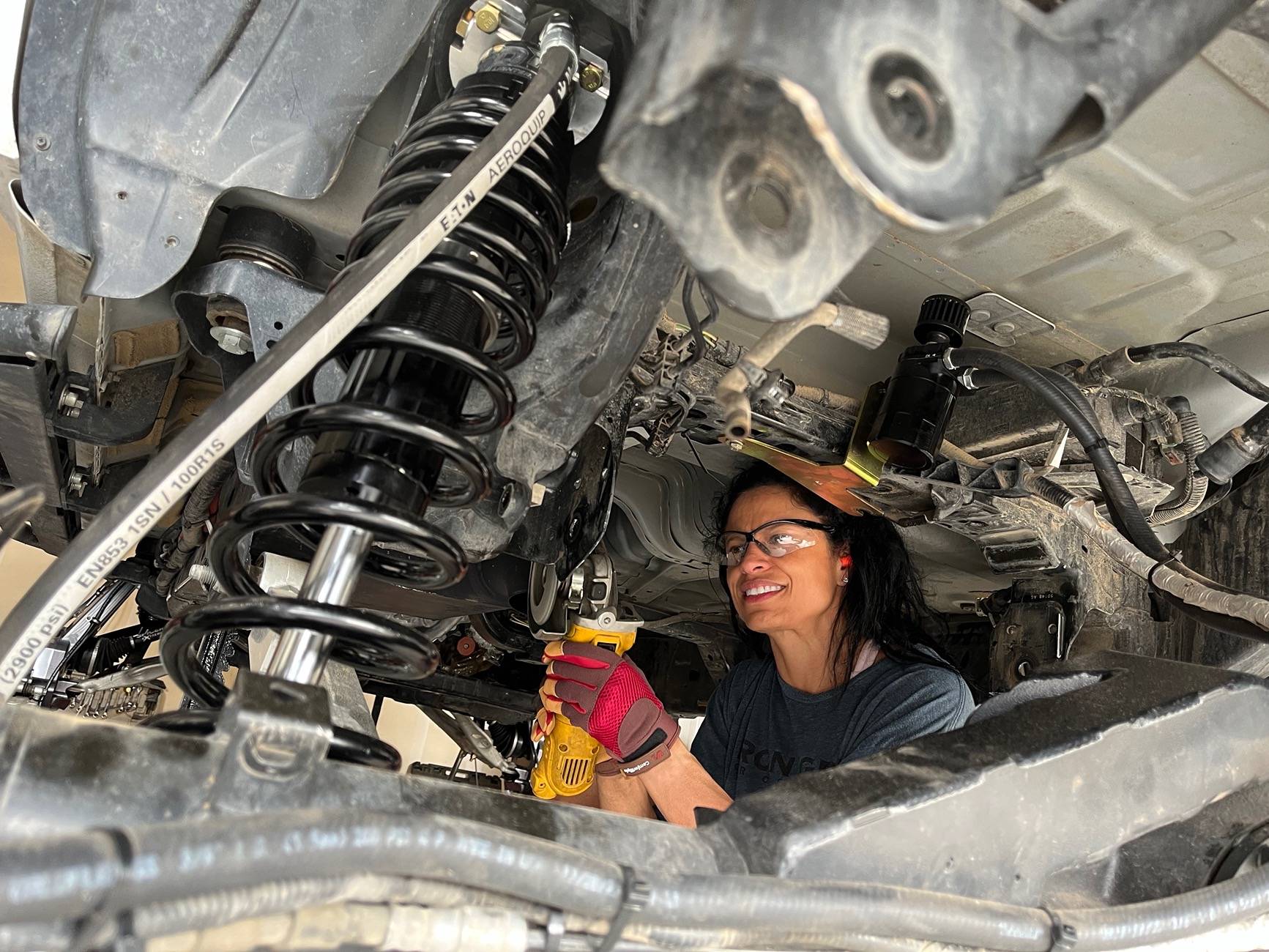

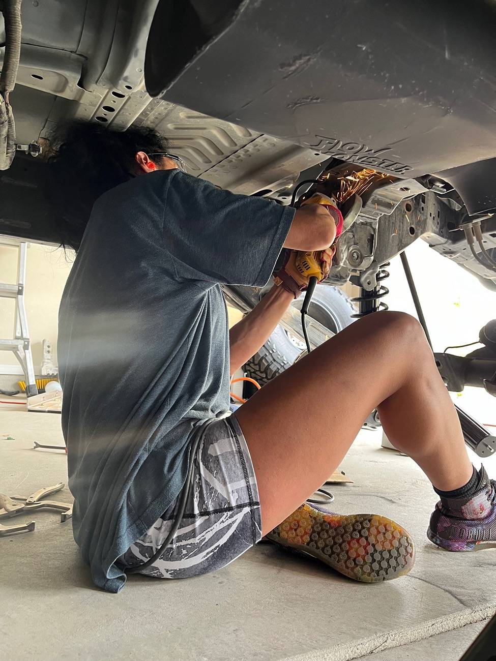

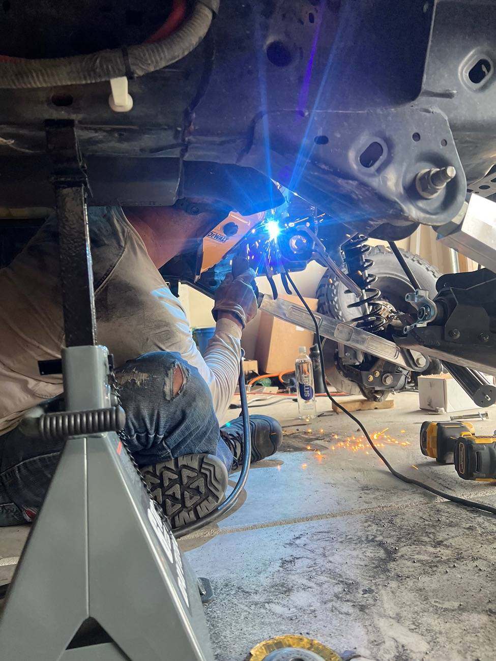

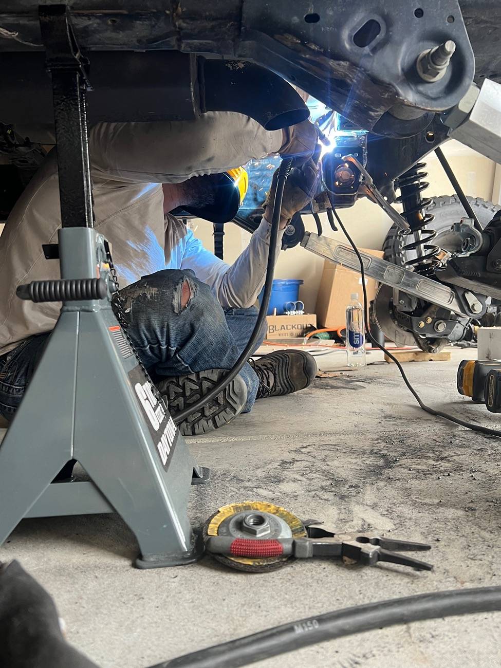

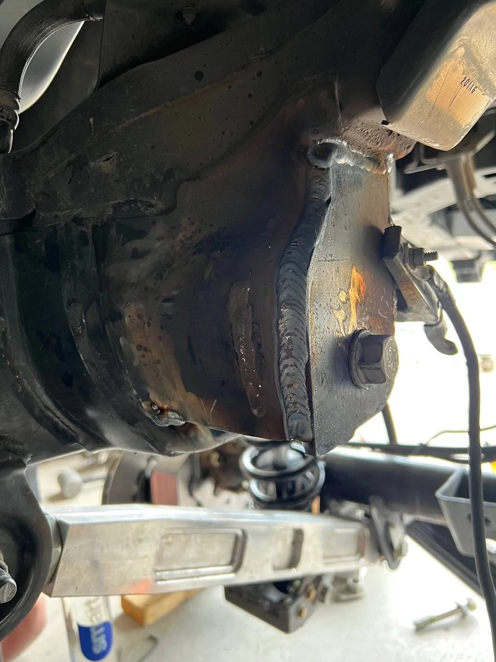

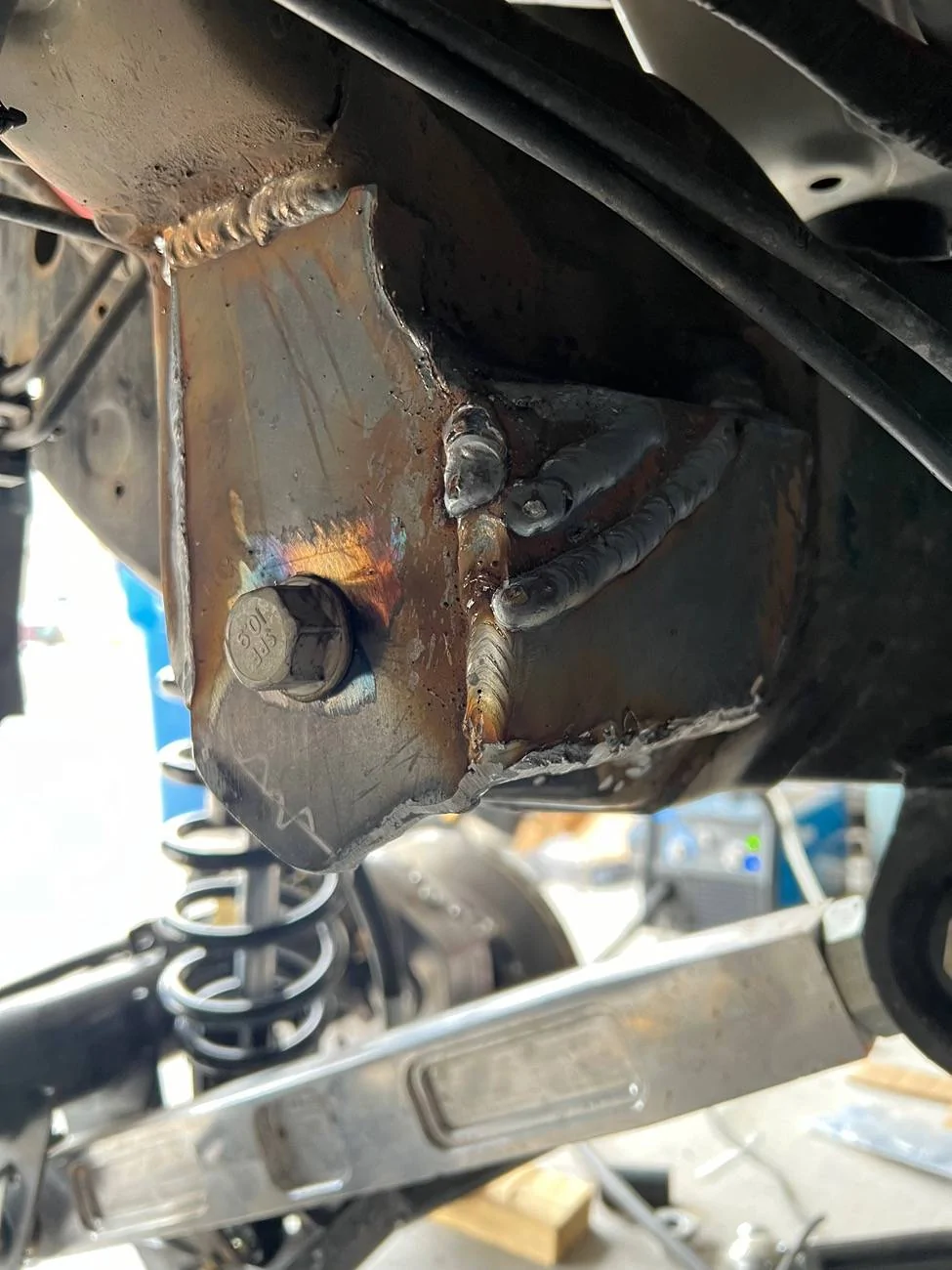

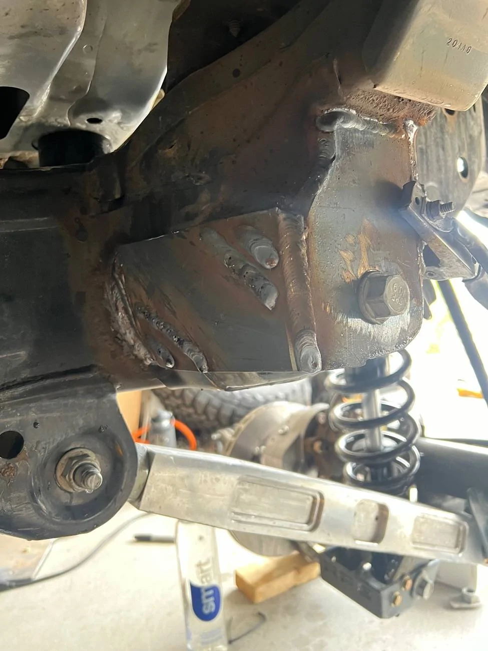

We braced the upper link mounts heavily on ours. Would highly recommend if doing the RK 4 link. Also did dual shear UCA mounts and added tabs from Barnes to strengthen the LCA mounts.
was planning to go with Baja’s upper link and rear trailing arms. Unless there’s reason to avoid. What was involved in bracing the upper link mounts? Also, were all of the mount bracing/reinforcements done in anticipation of the punishment expected from rock crawling and heavy off-roading? Or simply a “must” when moving to a LT suspension. First I’ve had anyone mention to me, which is what drives me nuts about trying to mod my cars… never feel like I get all the info I need even when researching myself hahaha.
SierraBronco
Mar 27, 2024
5,284
14,278
We did some highly detailed CAD (cardboard aided drafting) and boxed in the braces with 1/4 plate as nobody is making those mounts yet. A bunch of people have broken those mounts, and the passenger side is a beeeeotch to get to as ya gotta drop the tank. I believe 2021’s are the most problematic as after that year Ford boxed in the bottom, but we didn’t want to take any chances after @87-Z28 mentioned the lateral movement associated with the RK four link compared to the stock panhard bar setup. With our accessories being focused around portals and 40’s we wanted to strengthen everything. Getting new links with upgraded bushings is nice as you’ll notice the articulation gain after new coilovers are installed. Also having adjustment for pinion angle is nice in the event you swap out the driveline to a double cardan. (If you do the RK setup you will need a new driveline. All that flex and movement the factory driveline hits the gas tank.
