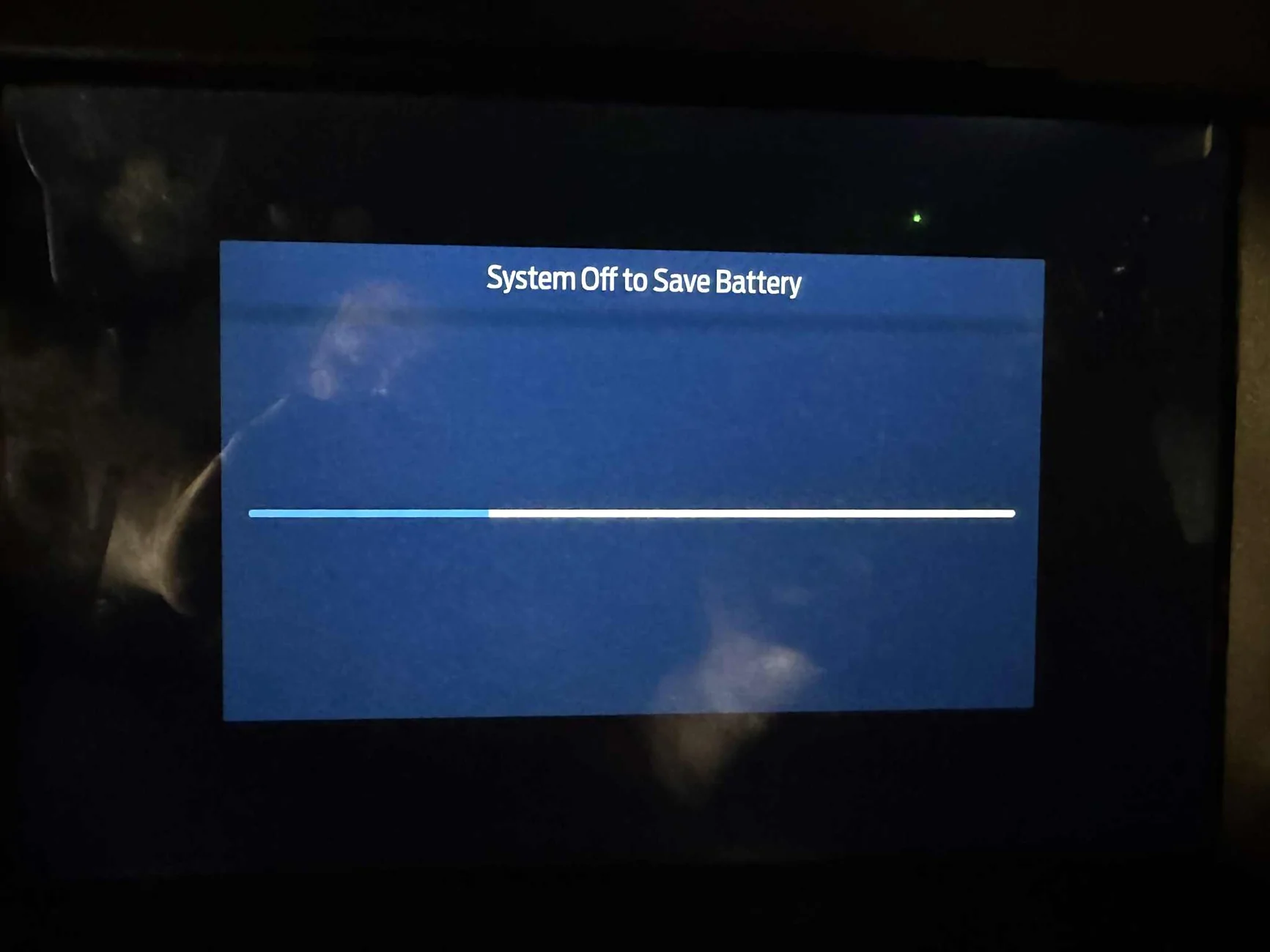

I'm getting this every single day the last couple of weeks, and every time I stop and turn off the Bronco (typical drive lately is ~20-30min). Not sure if it's battery going out, or maybe alternator isn't putting out enough to charge it... I've got a lot of accessories (upgraded sound, subwoofers, lights, radio, etc...) but only use them when the engine is running (and mainly just stereo).
Mine's a '23, had it about 2.5 years.

Yup. That's the final sign before it just leaves you stranded somewhere. You have days, probably not weeks, once you start hitting deep sleep every day before it just quits.

Mine was doing that, just died a couple days ago like I said in another post in this thread. I would steer you away from Optima. Like I mentioned, I pulled my factory battery out a year and a half ago to put the Optima in. It died in a year and a half. Last night I swapped the factory battery back in which still held a charge after sitting for a year and a half.

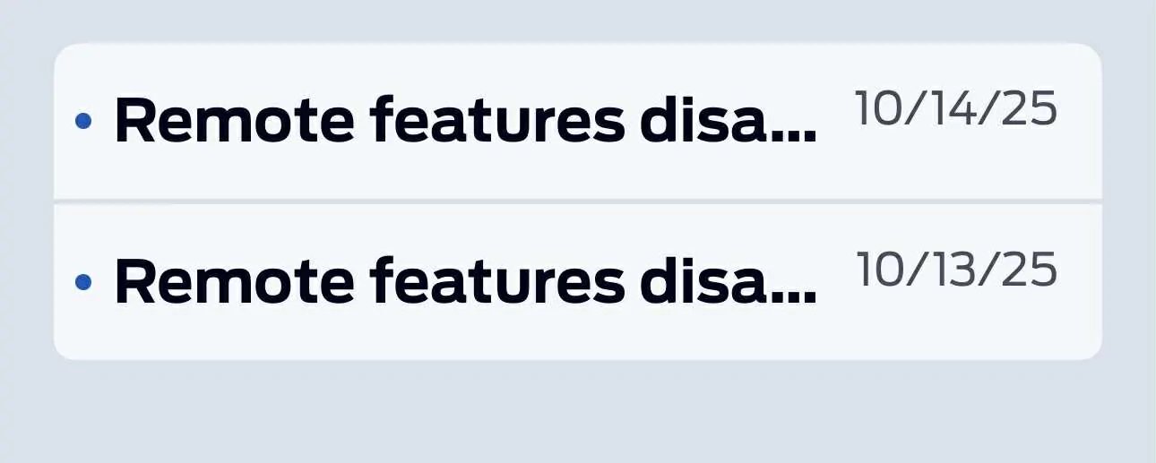

2 years 10 months for mine. I would have ran it a bit longer but I was going on a trip and didn't want the wife to have to deal with it. I kept getting "deep sleep mode" messages on the app.
Contrast that to my 2015 Grand Cherokee where I replaced the original battery (this year) just cause I was getting worried it would leave me stranded. But there is no app to tell me "scary" things with that car. I would have continued on with ignorant bliss if the Ford app didn't tell my wife every morning that something was "wrong" with her car.

Mine only lasted 2.5 years as well. Kept getting the system power shutting off after exiting the vehicle. Made sure to check that the connections at the battery were tight and everything.
I replaced it with an Interstate from Costco and haven't had any issues since
