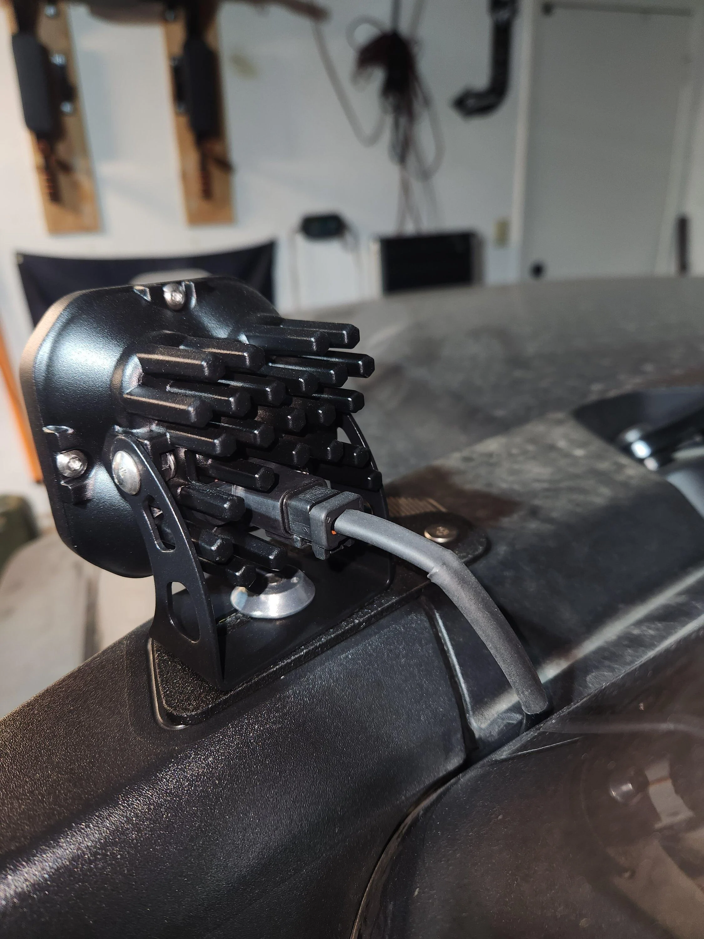

Can you post a pic of the mounts?

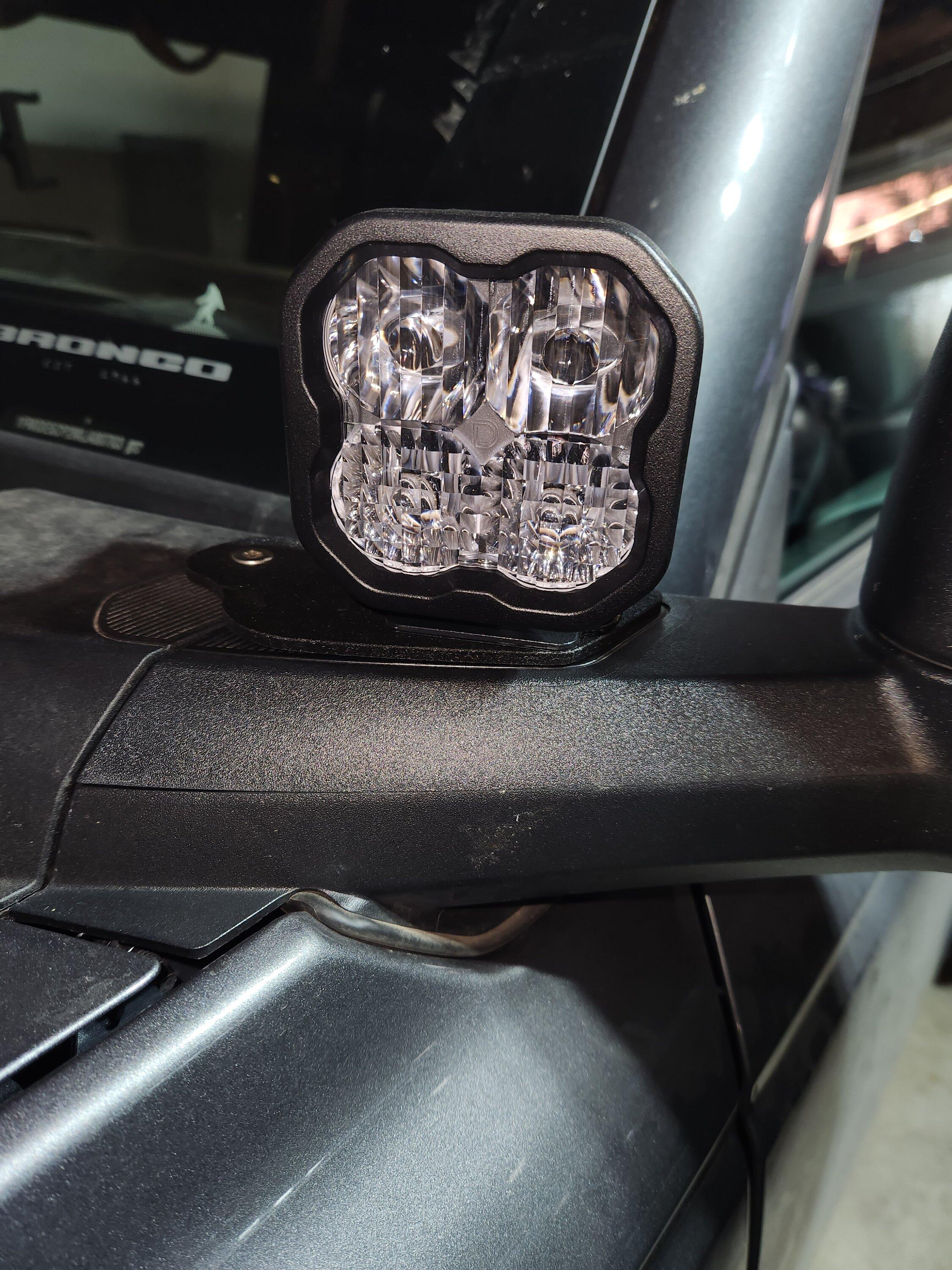

So this will be my next addition to the Bronco. I want true ditch lights and therefore thought the right way to go would be a flood pattern. But I'm seeing a lot of people picking the combo pattern for their ditch lights. I know which pattern of light the combo throws, I have them in my bumper. But why are yall putting them on the A-pillars?
Depends on where you are aiming them. "Ditch Lights" or "A-Pillar Lights" have 2 areas people aim them.
1) Off to the side. To light up the "ditch". In that case you want a flood style pattern.
2) Forward facing. So that they go down range a bit. In this case you want a spot pattern. A combo pattern can work also if you have a darker vehicle. I say this because you will have some light scatter.
Now light scatter on the hood with Broncos is not as common as on a pickup truck with a longer hood. But if they are facing forward SPOT is the best. COMBOS is a 2nd favorite although with Diode Dynamics, they put a DRIVING and a FLOOD in their COMBO lights. Baja Designs does a SPOT and a WIDE pattern in their combo lights.
The most popular pattern we sell for ditch/a-pillar lights is COMBO though

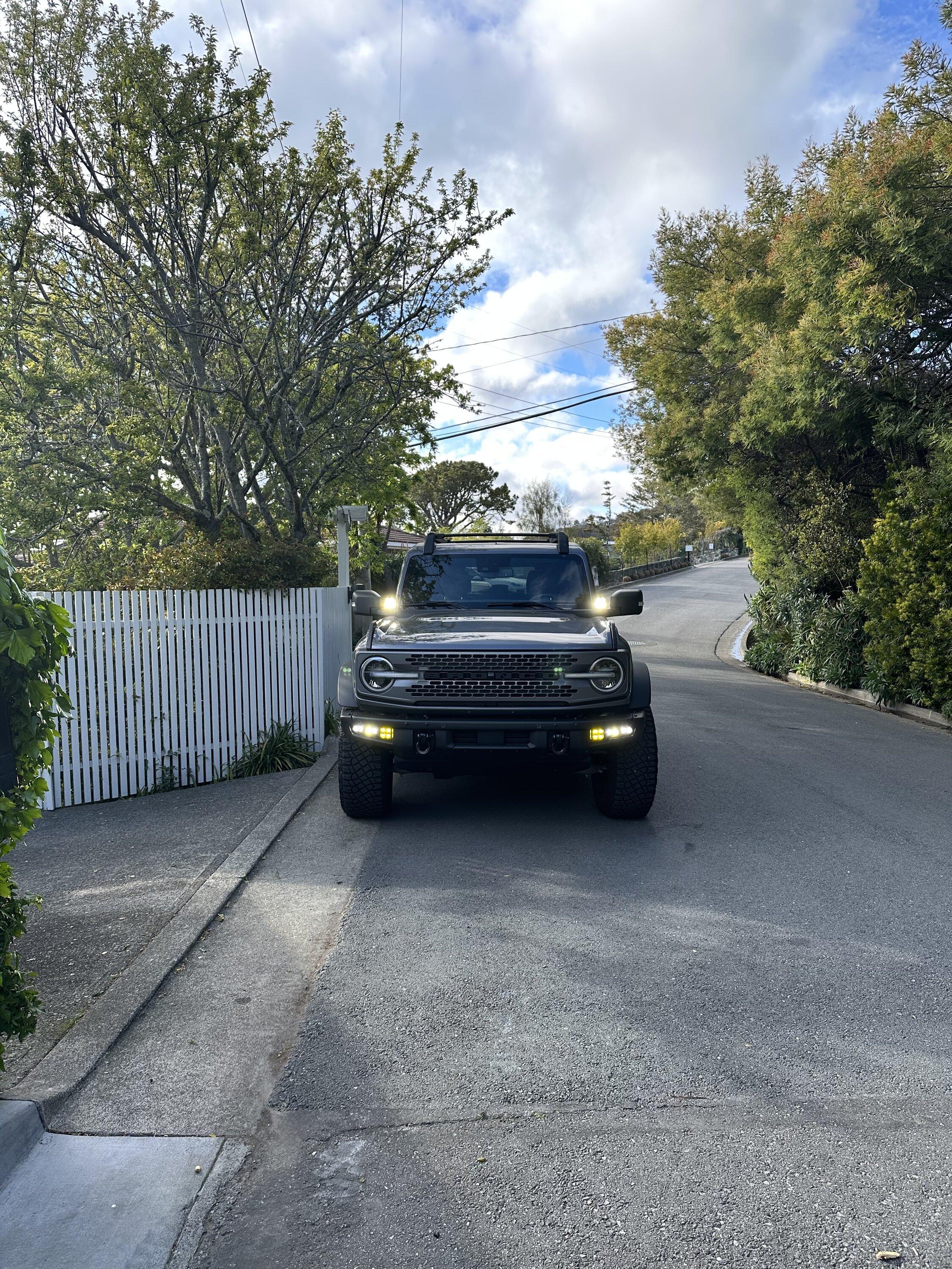

I have 2 sets of Baja Design lights on my build….A-Pilar Squadron Sport and the BD Fog Light Kit which has SAE Squardron & S2 lights Spot and combo driver wide cornering. I called BD and basically confirmed its personal preference…Since I already have the Fog Light Kit with the Squadron S2 combo driving lights, I chose to install the Spot lens on the A-Pillar lights so I get more down the road spot lighting power. The BD products are best in the biz!
